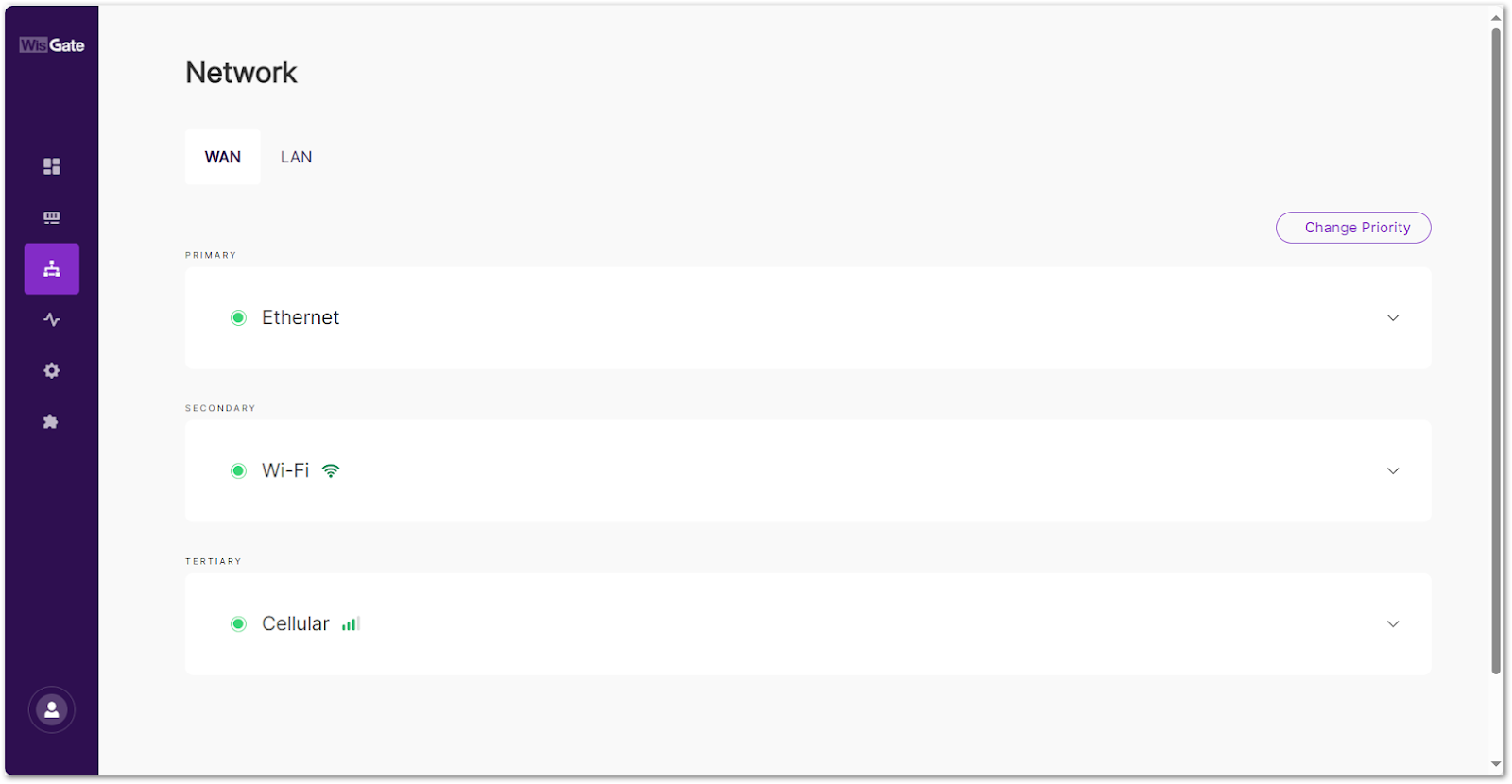

  1. Navigate to the Network section in the Web UI.
Network option on WisGateOS 2
Figure 1: Network option on WisGateOS 2

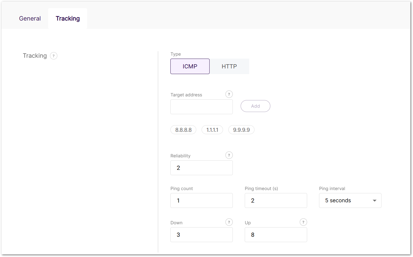

  1. Select the target interface and expand it by clicking the arrow on the right to reveal its configuration settings.
  2. Navigate to the Settings > Tracking section.
  3. Configure the tracking parameters according to your chosen method (ICMP or HTTP):
Tracking Parameters on WisGateOS 2
Figure 2: Tracking Parameters on WisGateOS 2
  • Target Address: Enter one or more IP addresses (for ICMP) or URLs (for HTTP). After typing an address, click the Add button to save it.
  • Reliability: The minimum number of target addresses that must respond in each cycle to consider the interface operational.
  • Ping Count: The number of pings sent in each check cycle (e.g., 1 ping per test).
  • Ping Timeout: The maximum time (in seconds) to wait for each ping response.
  • Ping Interval: The frequency with which the system performs a ping check (e.g., every 5 seconds).
  • Down: The number of consecutive failed checks required to mark the interface as down.
  • Up: The number of consecutive successful checks needed to mark the interface as up again.
