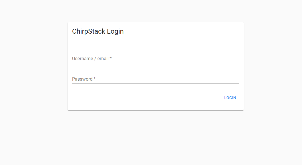

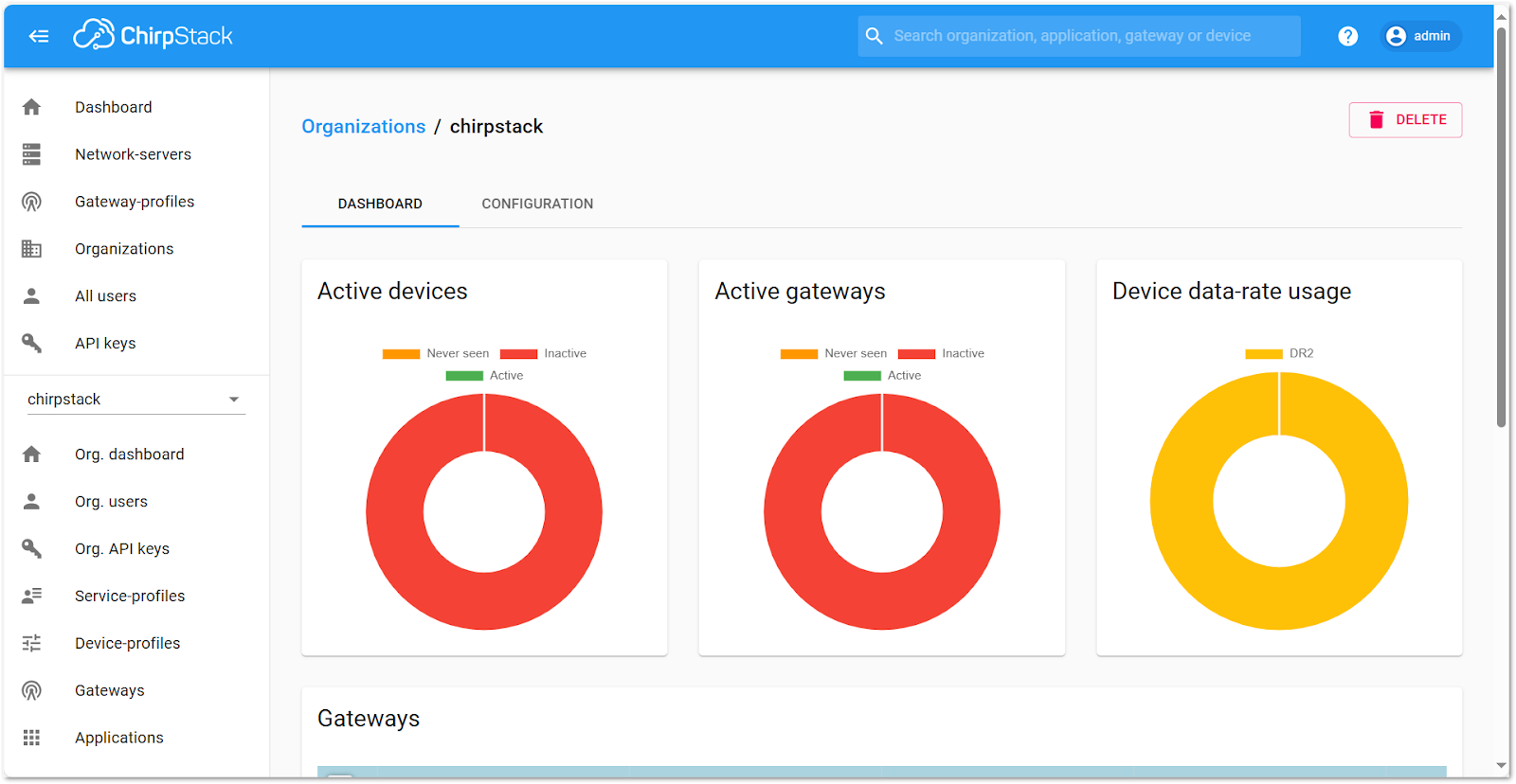

1. To begin, open a web browser and go to your ChirpStack server address on port 8080. For example:
http://<ChirpStack_Server_IP>:8080
2. Log in using the default credentials:
  • Username/Email: admin
  • Password: admin
图形用户界面, 文本, 应用程序
描述已自动生成

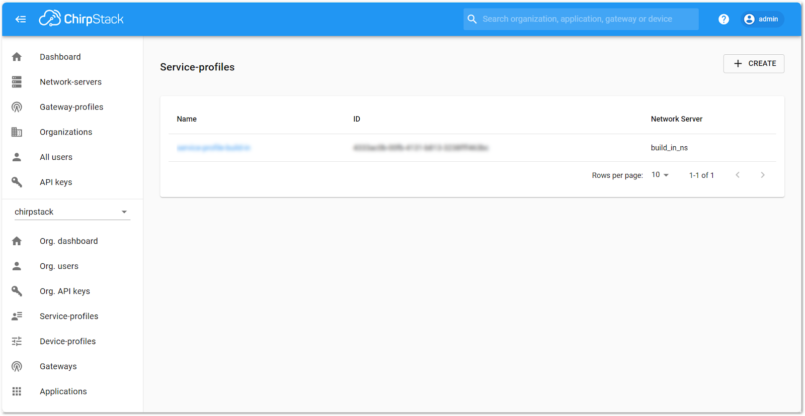

3. Before registering a gateway, you must first create a Service Profile. In the left sidebar, go to Service-profiles and click + CREATE.
Create a Service Profile

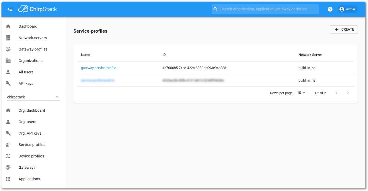

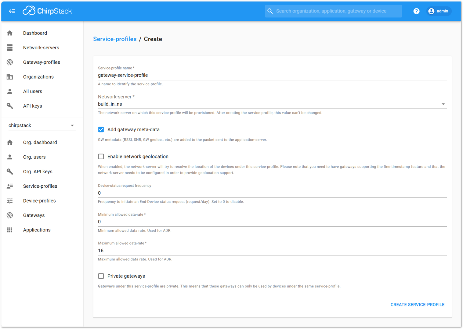

4. Fill in the following parameters, and click CREATE SERVICE PROFILE to save.
Save the Service Profile
  • Service-profile name: Provide a descriptive name.
  • Network-server: build_in_ns
  • Add gateway meta-data: Enable this option.
  • Minimum allowed data-rate: Set based on your region.
  • Maximum allowed data-rate:Set based on your region.
Service-profile

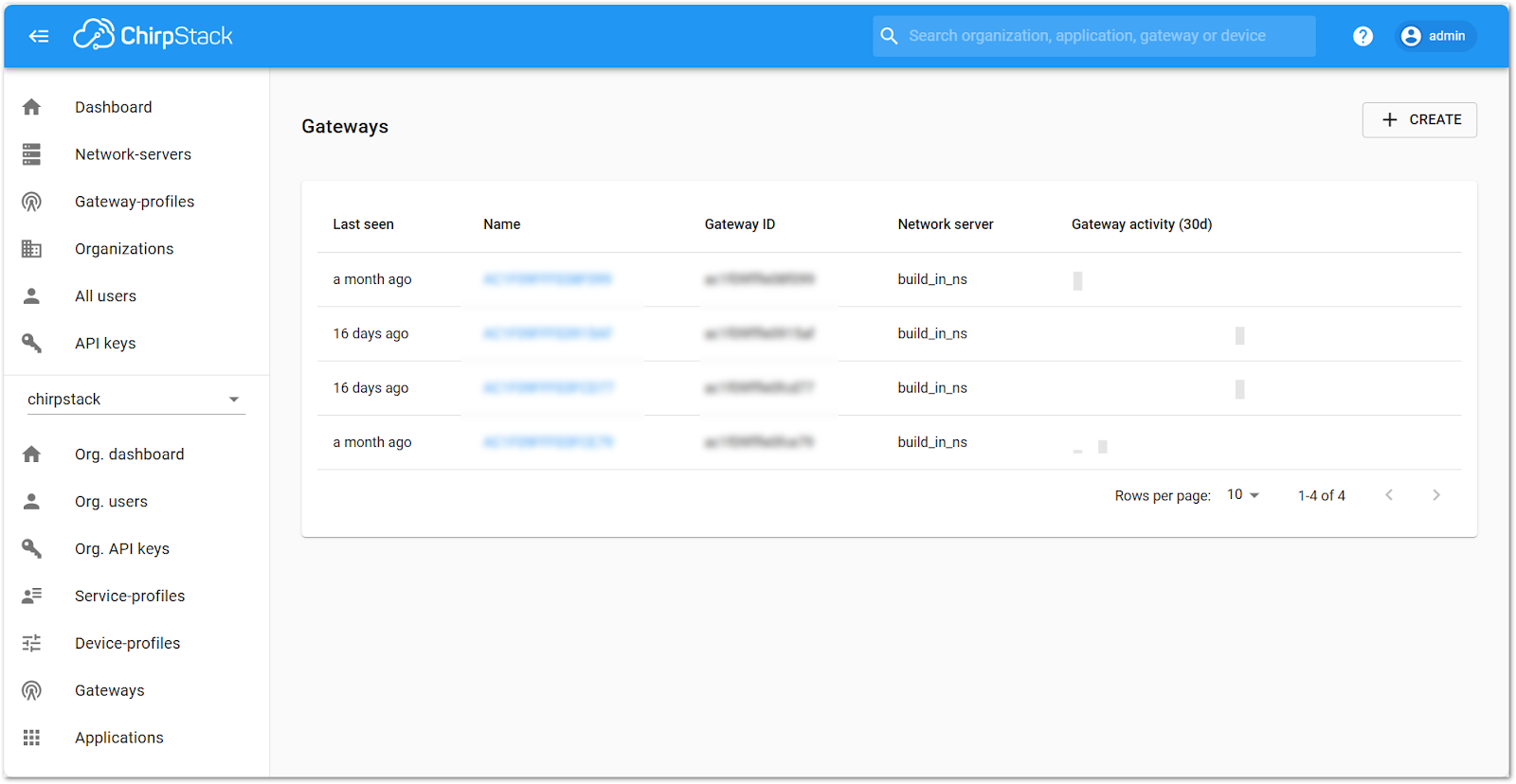

5. In the left sidebar, go to Gateways and click + CREATE.
Go to Gateways
Click + CREATE

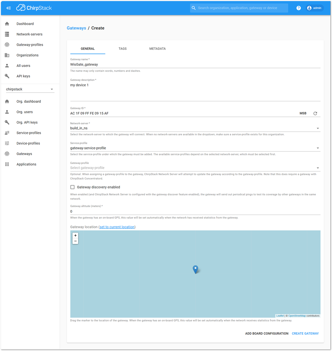

6. Under General, fill in the following fields:
Fill in the gateway details
  • Gateway name: A unique name for the gateway.
  • Gateway Description: A short description for identification.
  • Gateway ID: The gateway's EUI (found on the physical label or in the gateway’s Web UI under Dashboard > Overview).
  • Service-profile: Select the service profile you just created.

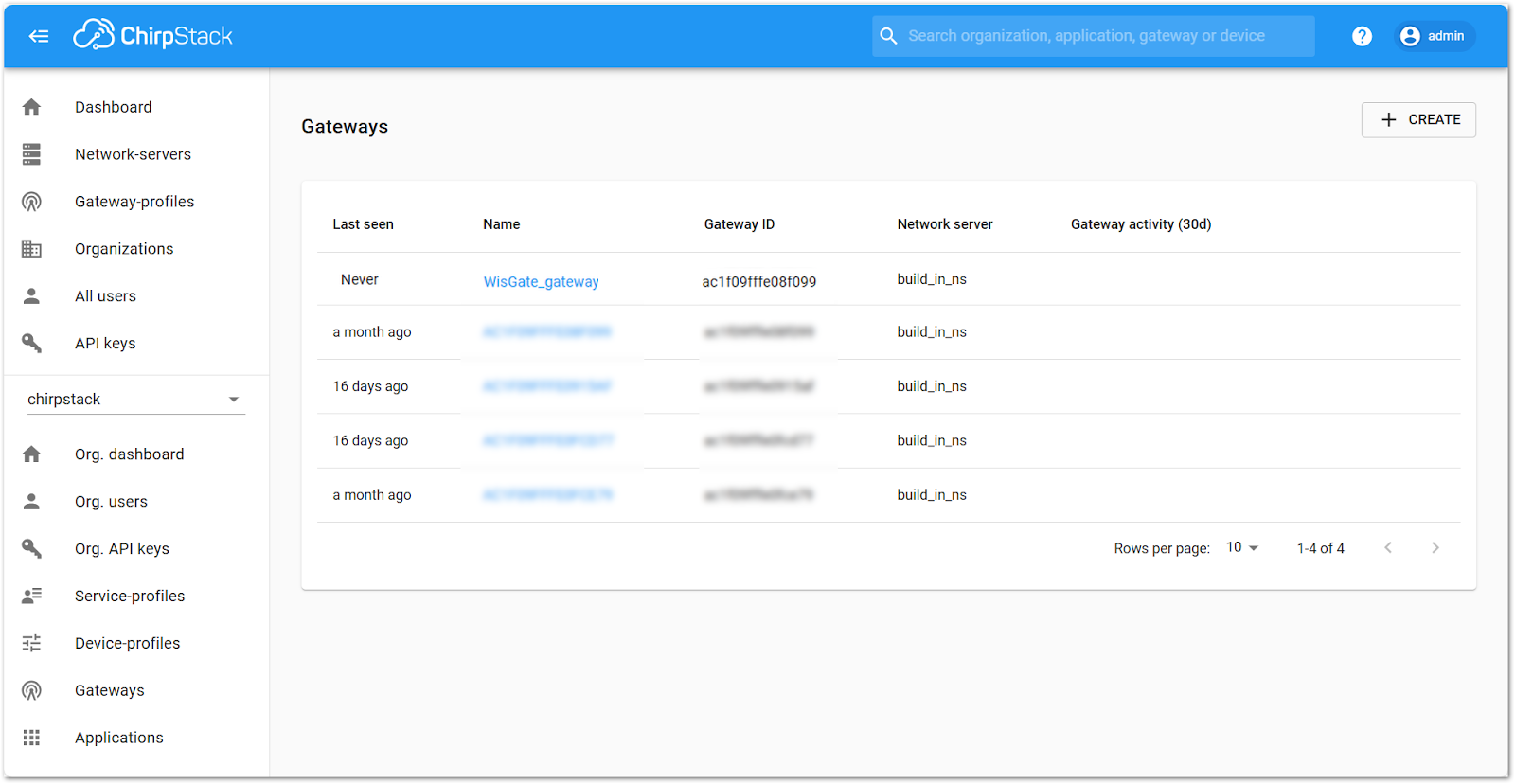

7. Click CREATE GATEWAY to complete the registration.
Gateway complete registration
