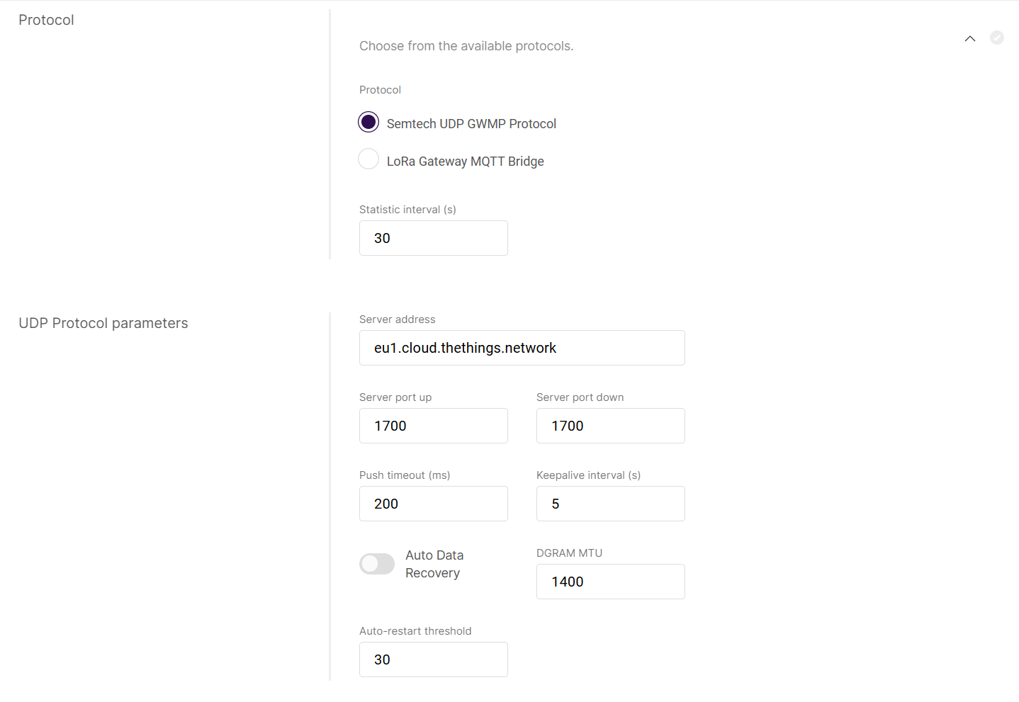

    Configure the Primary LNS
    In this example, The Things Network (TTN v3) is configured as the Primary LNS using the UDP protocol.
    1. Log in to the gateway’s web UI.
      Log in to the WisGate web UI
    2. Navigate to LoRa > Configuration in the left menu.
    3. In the Protocol field, select Semtech UDP GWMP from the dropdown list.
      Select Semtech UDP GWMP
    • If using TTN’s EU1 cluster, confirm the pre-filled server address and port.
    • For other regions, update the Server address based on your TTN cluster (port 1700 remains unchanged).

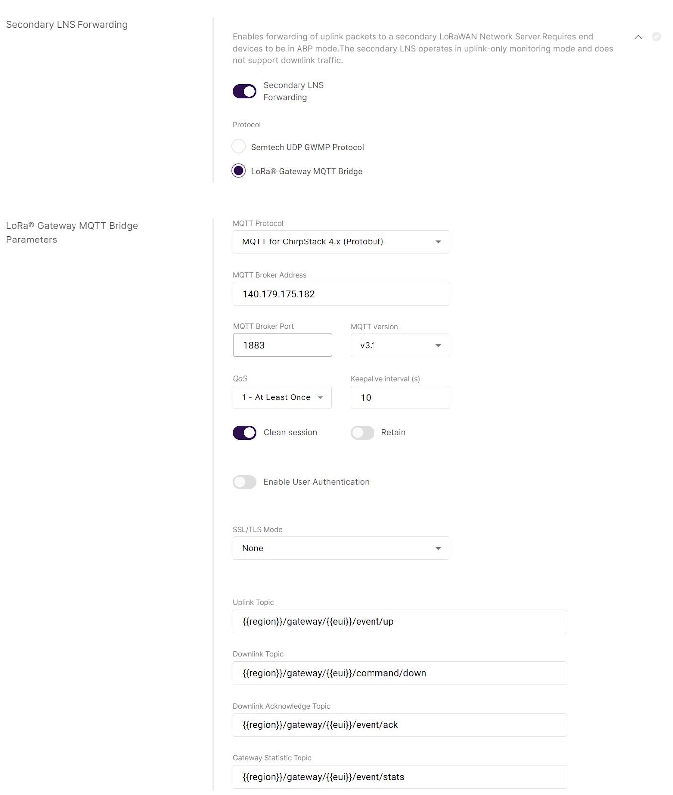

    Enable Secondary LNS Forwarding
    In this example, ChirpStack v4 is set up as the Secondary LNS, using the LoRa® Gateway MQTT Bridge protocol.
    1. On the same LoRa > Configuration page, toggle Secondary LNS Forwarding to enable the feature.
    2. Select LoRa® Gateway MQTT Bridge as the protocol.
    3. Configure the connection parameters for ChirpStack v4:
    • MQTT Broker Address: Enter the public IP address of your ChirpStack server, for example: 140.179.175.182
    • MQTT Broker Port: 1883
    NOTE
    When using MQTT, optional parameters, such as QoS, Keepalive, Clean Session, Authentication, and TLS can be configured based on the target broker requirements.
    1. Click Save changes to apply the configuration.

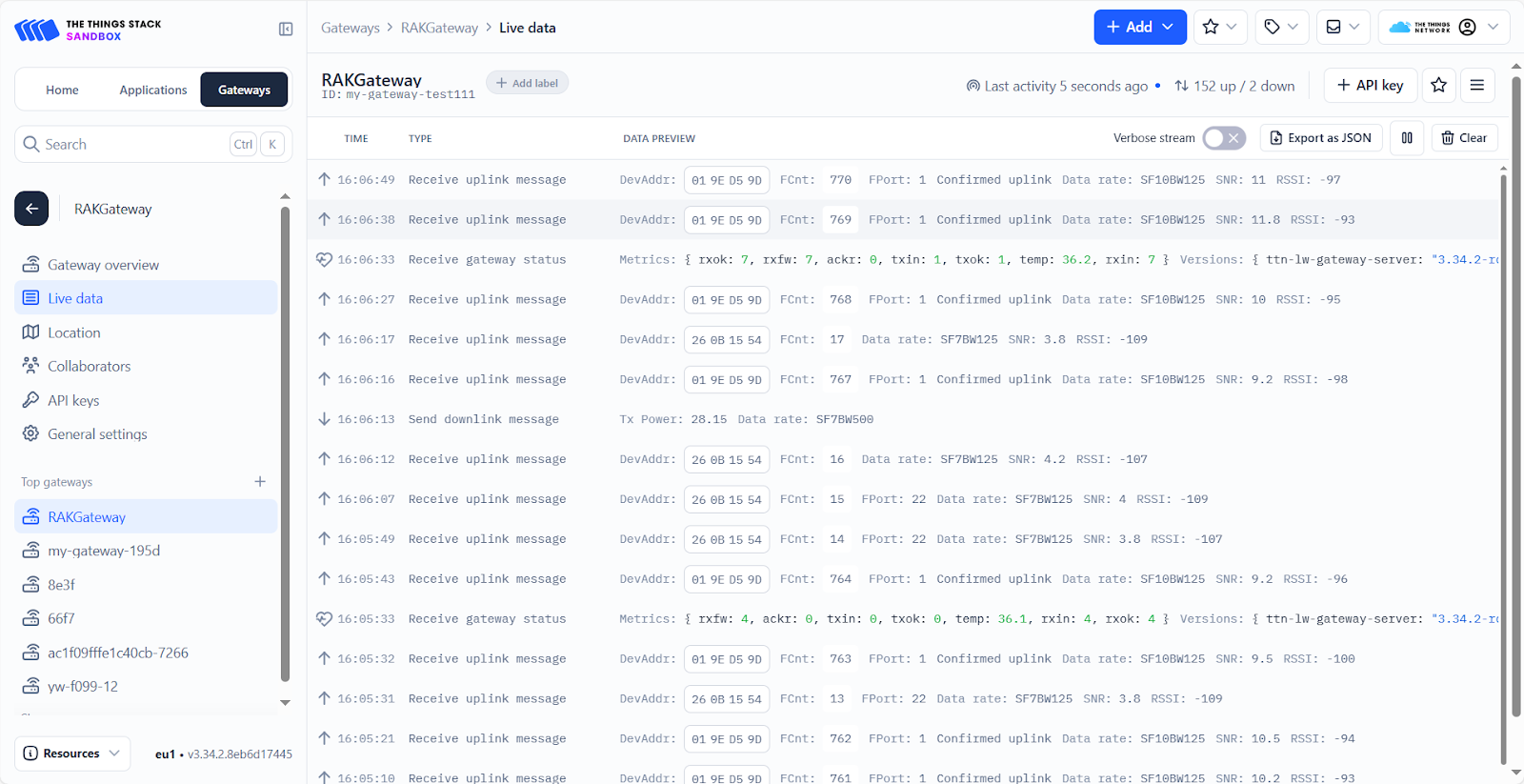

    • Primary LNS (TTN v3 via UDP):
      The TTN Console displays live uplink and gateway status messages. TTN also supports sending downlink messages, which are delivered to end devices through the gateway.

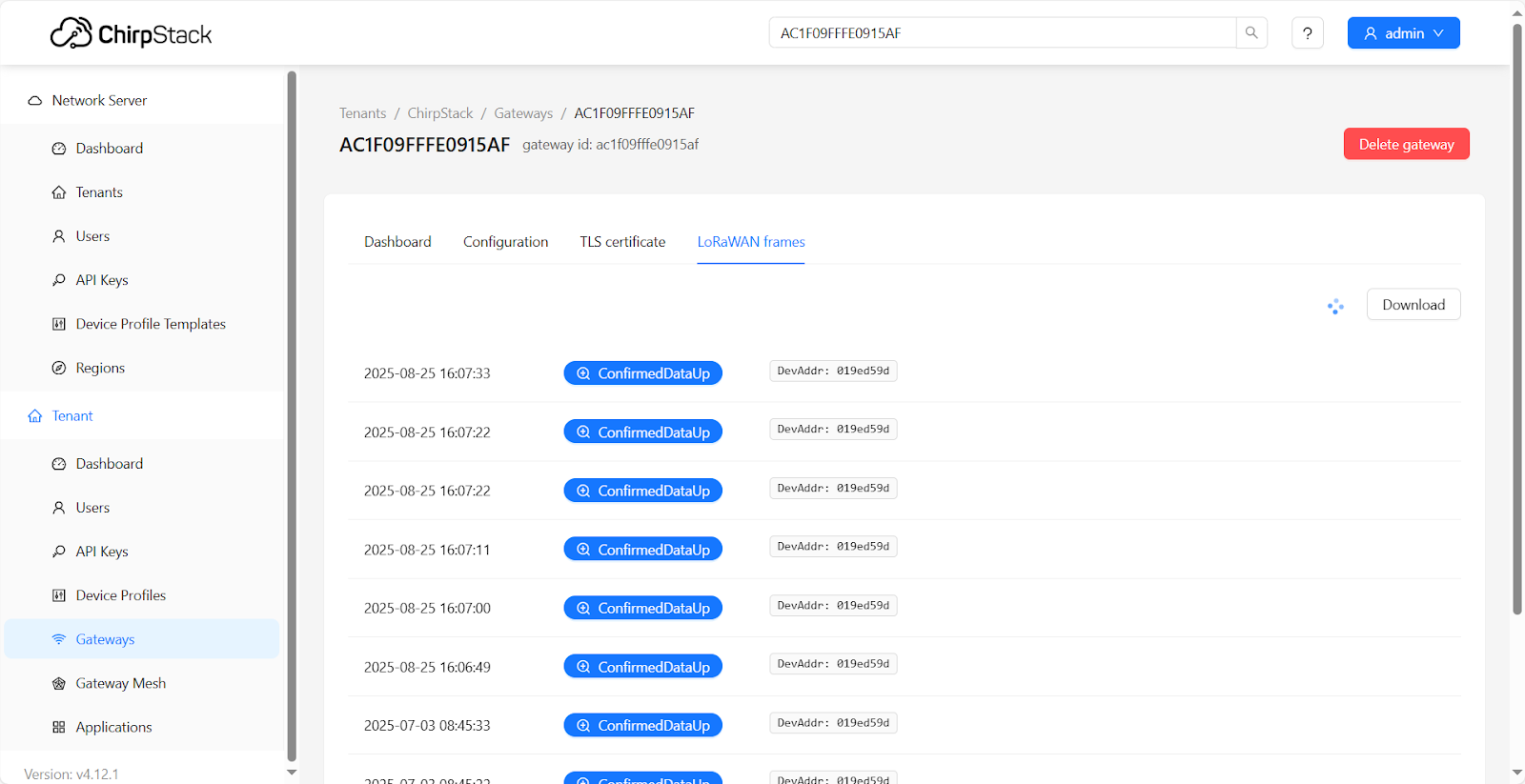

    • Secondary LNS (ChirpStack v4 via MQTT):
      In ChirpStack, the LoRaWAN Frames view shows the uplink frames (e.g., ConfirmedDataUp) received from the same device.
      Secondary LNS
    This confirms that the gateway is forwarding uplinks to both servers simultaneously, while only the Primary LNS manages downlink traffic.
