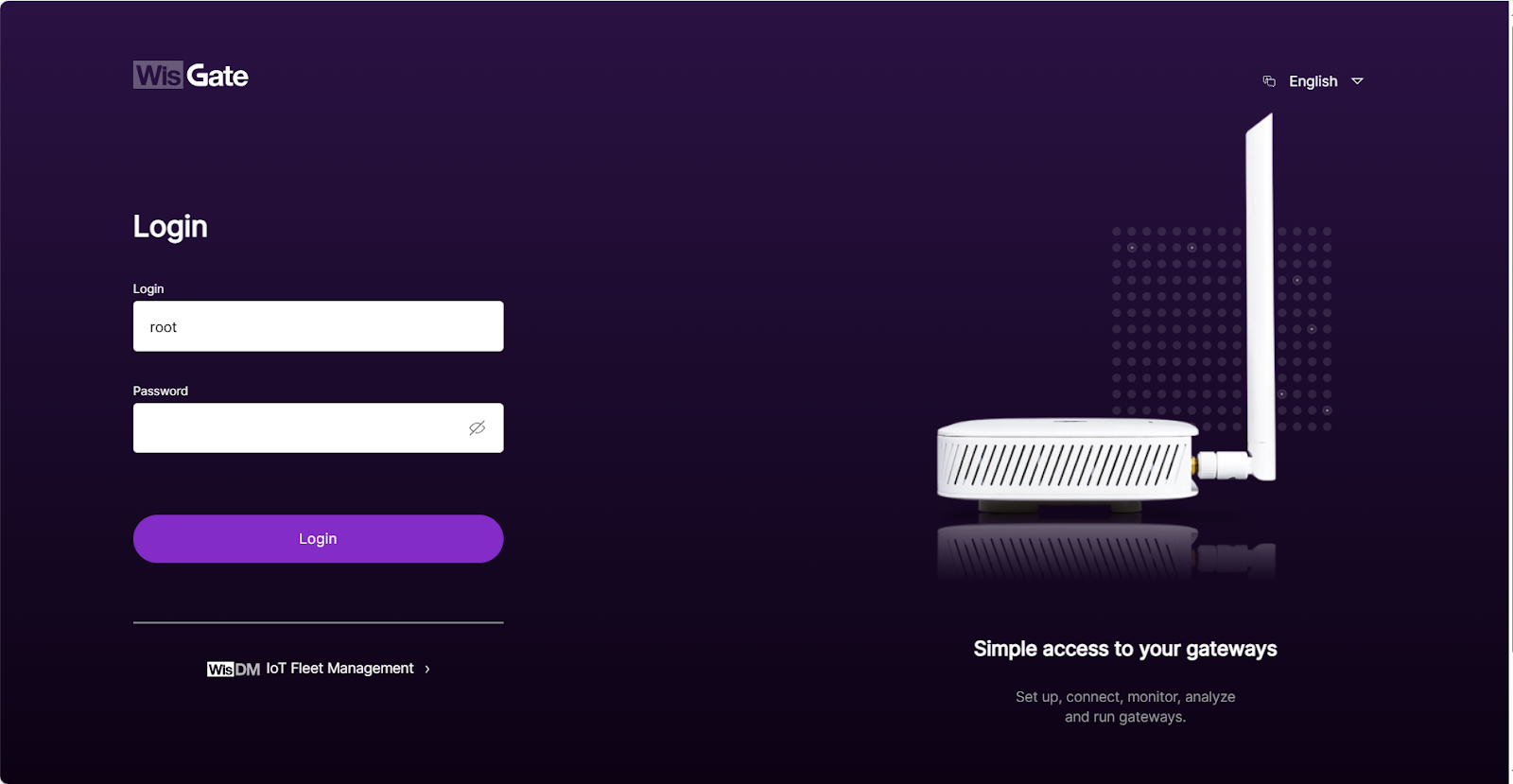

  1. Log in to the gateway’s web UI.
Log in to the WisGate web UI

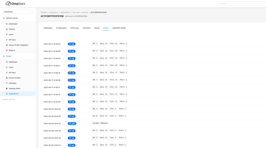

The ChirpStack Events View shows multiple uplinks with consecutive FCnt values appearing almost instantly after reconnection.
