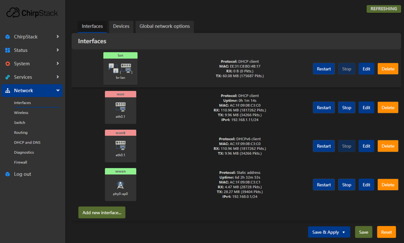

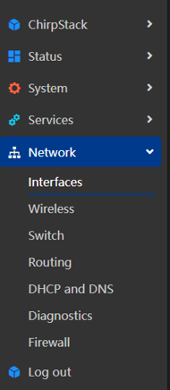

Step 1: Open the Network Interfaces Page
  1. Log in to the gateway web interface.
  2. Navigate to:
Network → Interfaces

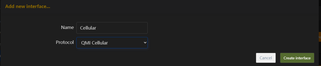

Step 2: Create a New Cellular Interface
  1. Click Add New Interface.
       2. Configure the following:
Setting Value
Name Cellular (or any preferred name)
Protocol QMI Cellular
  1. Click Create Interface.

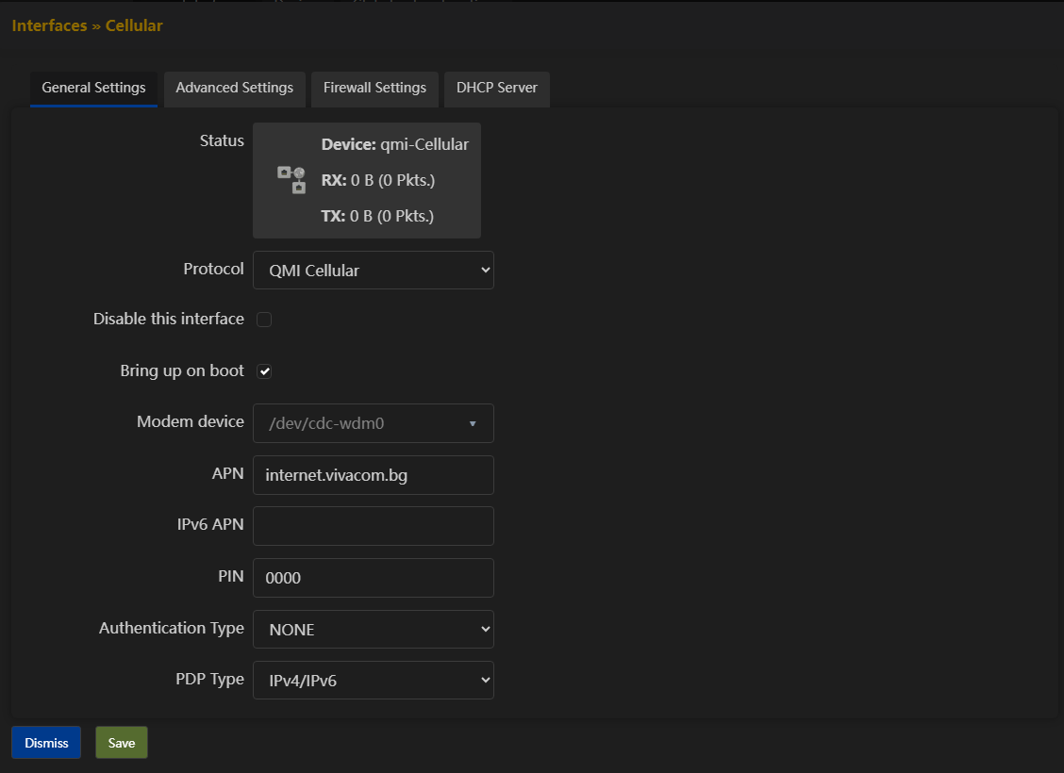

Step 3: Configure Cellular Settings
On the General Settings tab, configure the cellular modem.
Required Settings
Setting Value
Modem Device /dev/cdc-wdm0
APN Your carrier APN
Optional Settings
Configure the following only if required by your mobile operator:
Setting Description
PIN SIM PIN code
IPv6 APN IPv6 APN value
Authentication Type Operator-specific authentication
PDP Type IPv4 / IPv6 configuration

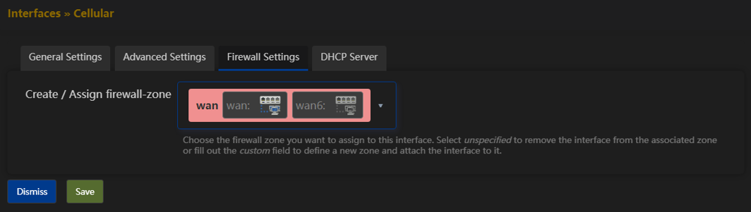

Step 4: Assign the Interface to the WAN Firewall Zone
  1. Open the Firewall Settings tab.
  2. Under Create / Assign Firewall Zone, select:
WAN
This allows the cellular interface to be used as an Internet uplink.

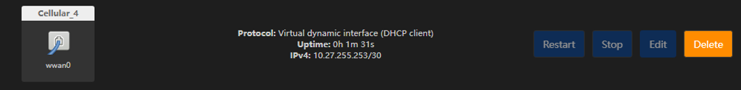

Step 6: Verify the Cellular Connection
The connection process may take several minutes.
Note: You may need to refresh the page after the modem connects.
Once connected, the new cellular interface will appear in the Interfaces list and display:
  • Interface status
  • Assigned IP address
  • Uptime
  • Traffic statistics
