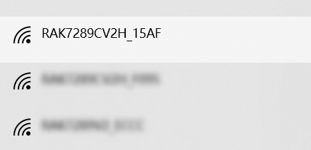

  2. Find the gateway SSID.
    • The default SSID format is gateway-model_XXXX, where XXXX represents the last two bytes of the gateway’s MAC address.
    • On your laptop or mobile device, open the Wi-Fi list and locate the SSID.
Find gateway SSID

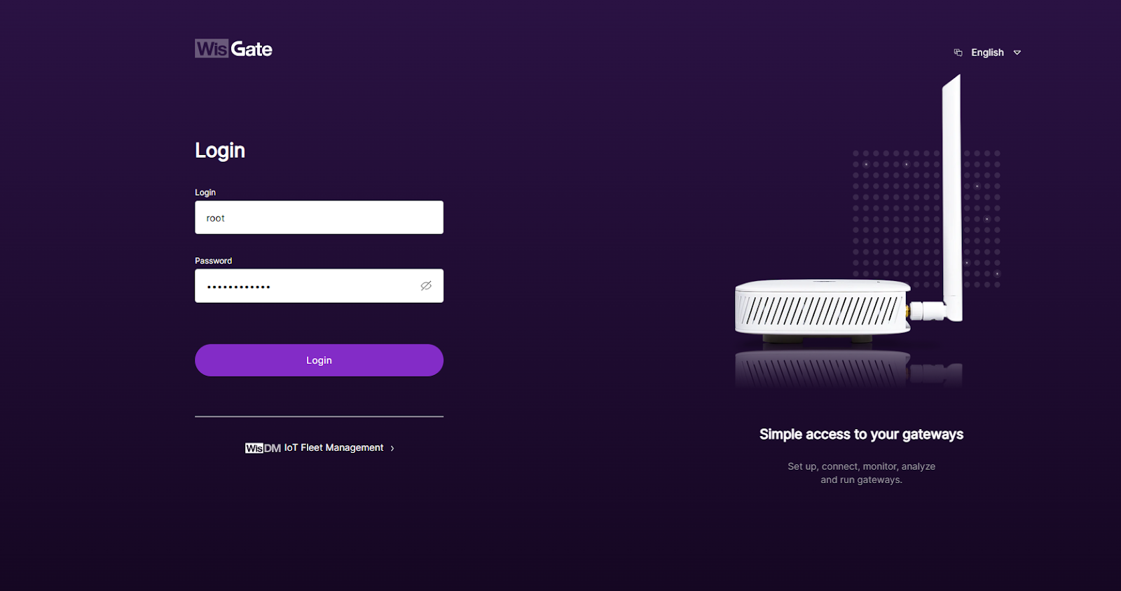

4. Access the Web UI.
  • Open a web browser and enter: 192.168.230.1.
  • Log in to the gateway’s Web UI.
NOTE
On the first login, you must set a login password before you can continue. Password requirements:
  • At least 12 characters long
  • Has at least one special character (!“#$%&\‘()*+,-./:;<=>?@[]^_{|}~)
  • Has at least one number
  • Has at least one standard Latin letter (used in the English alphabet)
Log in to the WisGate Web UI

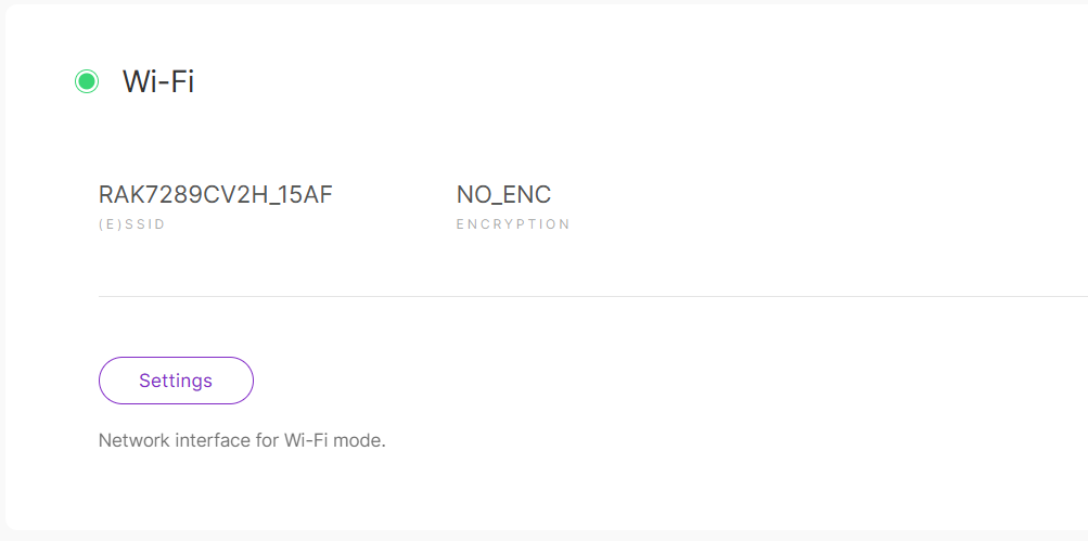

  1. Navigate to Network > LAN > Wi-Fi.
Modify the default AP configuration

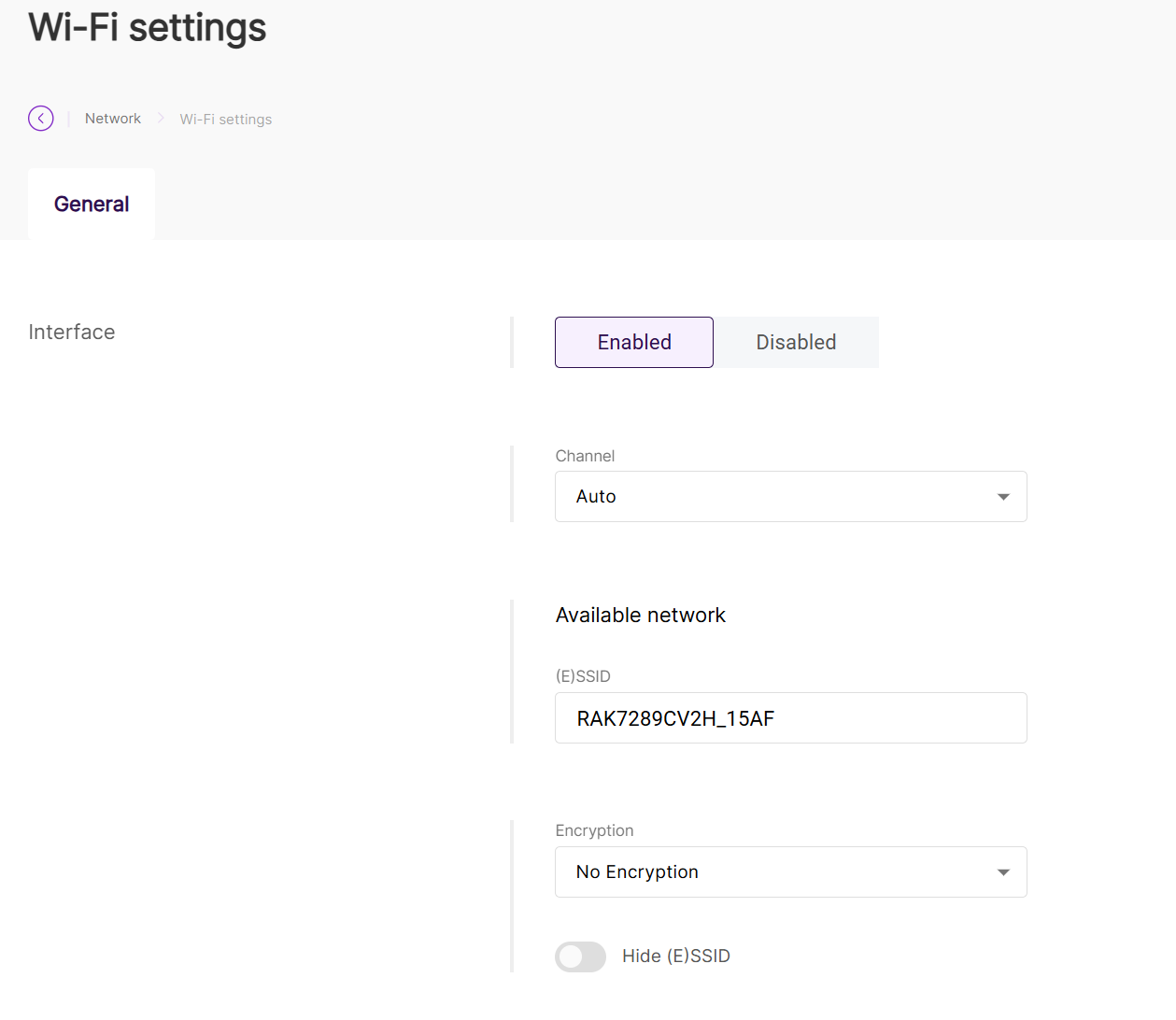

  1. Click Settings to open the configuration page.
Click Settings
  1. Adjust the parameters as needed for your deployment:
    • Enable/Disable: Enable or disable the Wi-Fi LAN interface.
    • Channel: Set the Wi-Fi channel. The default is Auto, which allows the gateway to automatically choose the optimal channel.
    • (E)SSID: Define the SSID for the wireless AP.
    • Encryption: Select the encryption type for the Wi-Fi AP.
    • Key: Set the Wi-Fi password for the wireless access point. This option is available when an encryption method is selected.
    • Hidden: Enable this option to hide the SSID, making the AP invisible to devices scanning for networks (manual entry required to connect).
  2. Click Save to apply the configuration.
