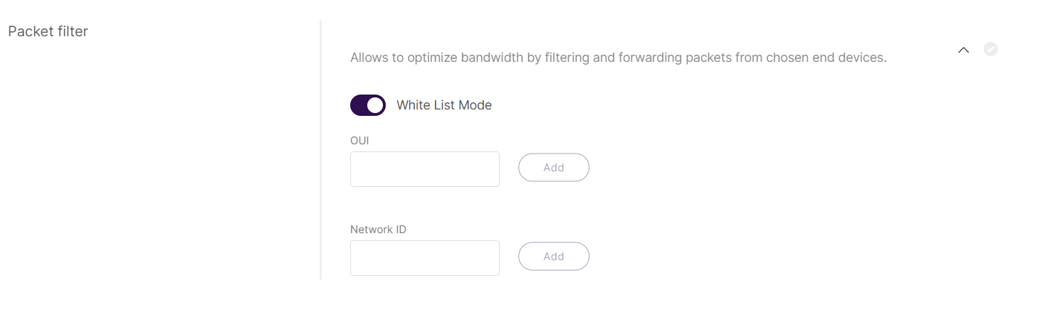

For Basic Station Mode
  1. Log in to the gateway's web UI.
  2. Go to LoRa® > Configuration > Packet filter.
  3. Only White List Mode is supported and must be enabled manually.
  4. After enabling, you can configure the following:
Configure Packet filter
Parameter Description
OUI
OUI is the first 3 bytes (i.e., 6 hexadecimal characters) of the device's DevEUI, identifying the manufacturer.
Example:
  • DevEUI 70B3D57ED0001234
  • OUI = 70B3D5
Network ID
A 6-character hexadecimal value.
Refer to NetID and DevAddr Prefix Assignments table to determine the network.
  1. Click Save changes to apply the configuration.
