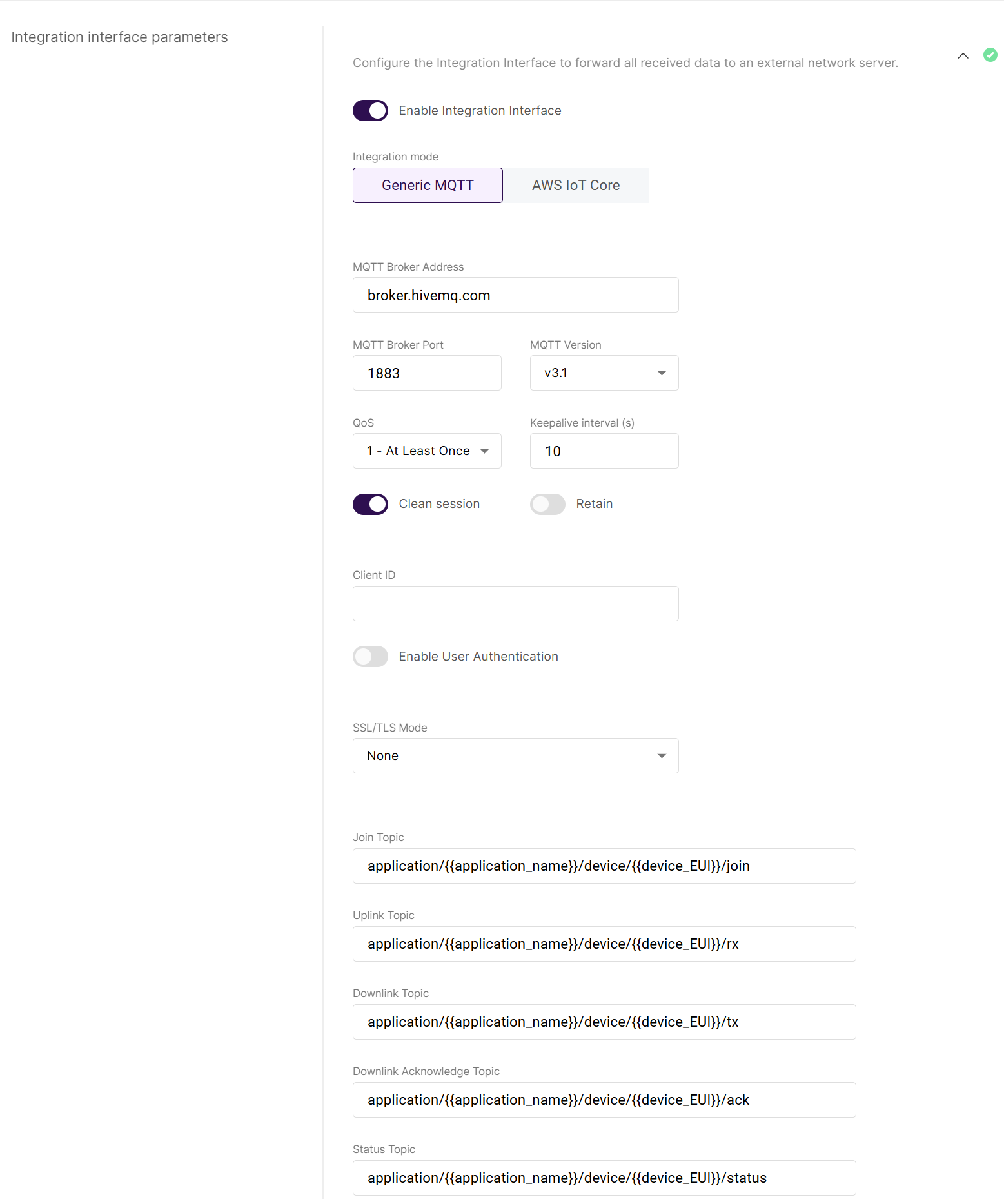

  1. Go to LoRa® > Configuration > Integration interface parameters in the gateway’s web UI.
  2. Toggle the Enable Integration Interface option and select Generic MQTT as the integration mode.
  3. Configure the following MQTT parameters:
    • MQTT Broker Address: Enter the hostname of your MQTT server. Example: broker.hivemq.com
    • MQTT Broker Port: 1883
NOTE
For X Industrial series gateways, the available MQTT integration parameters may differ slightly.
However, similar to Edge and SoHo series gateways, the primary configuration required here is the MQTT broker address and port.
Other parameters can be left at their default values unless specific customization is needed.
4. Click Save changes to apply the configuration.

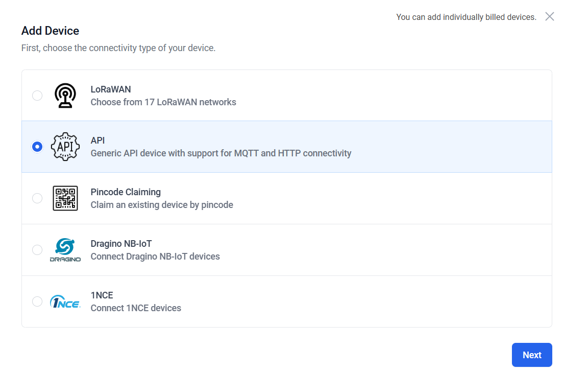

  3. Select API as the connectivity type of your device, and click Next.
    Select API

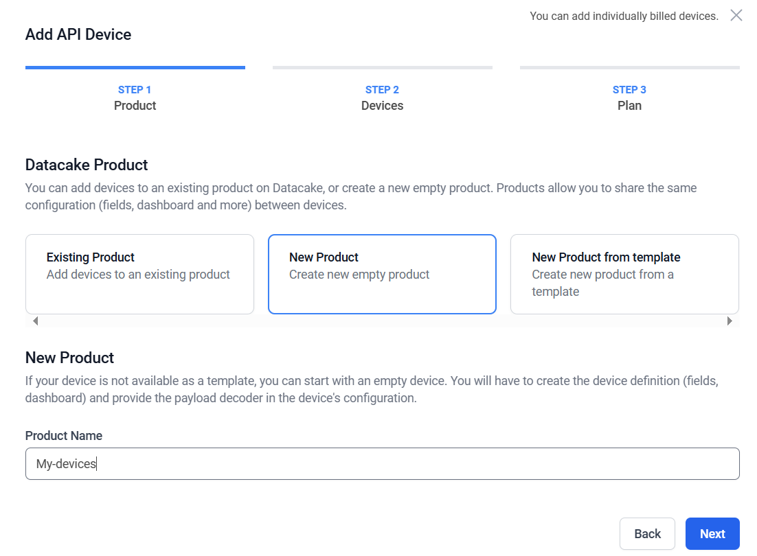

  4. Choose New Product, enter a product name, and click Next.
    Choose New Product

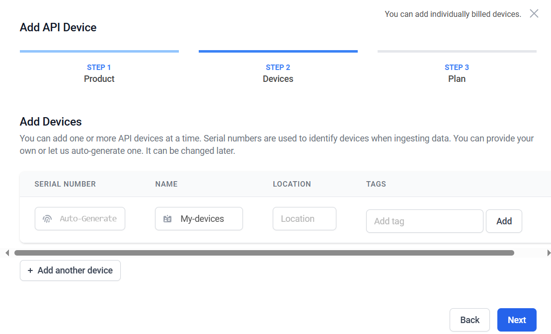

  5. On Step 2, leave the Serial Number blank (Datacake will generate one automatically), then click Next.
    Leave the Serial Number

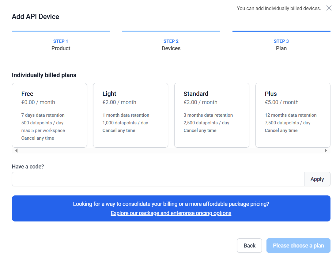

  6. Choose a payment plan and confirm.

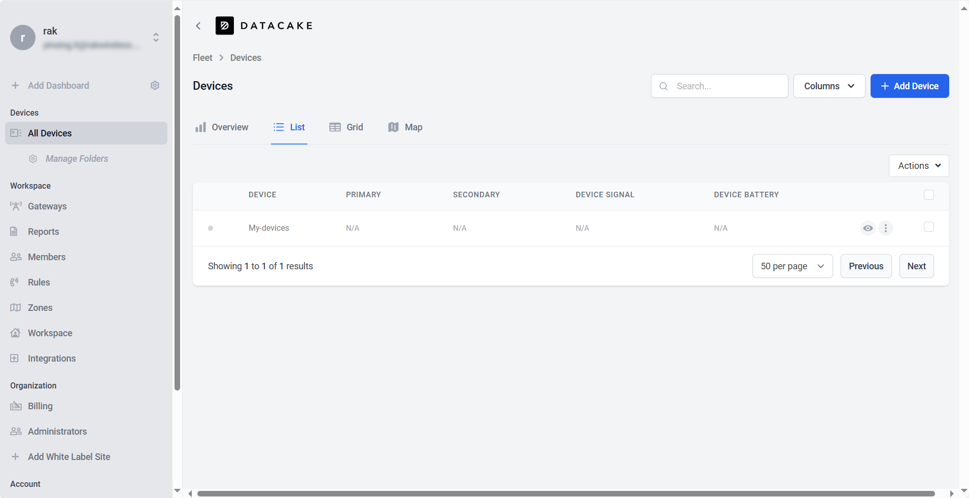

Your device now appears in the Devices list.
Devices list

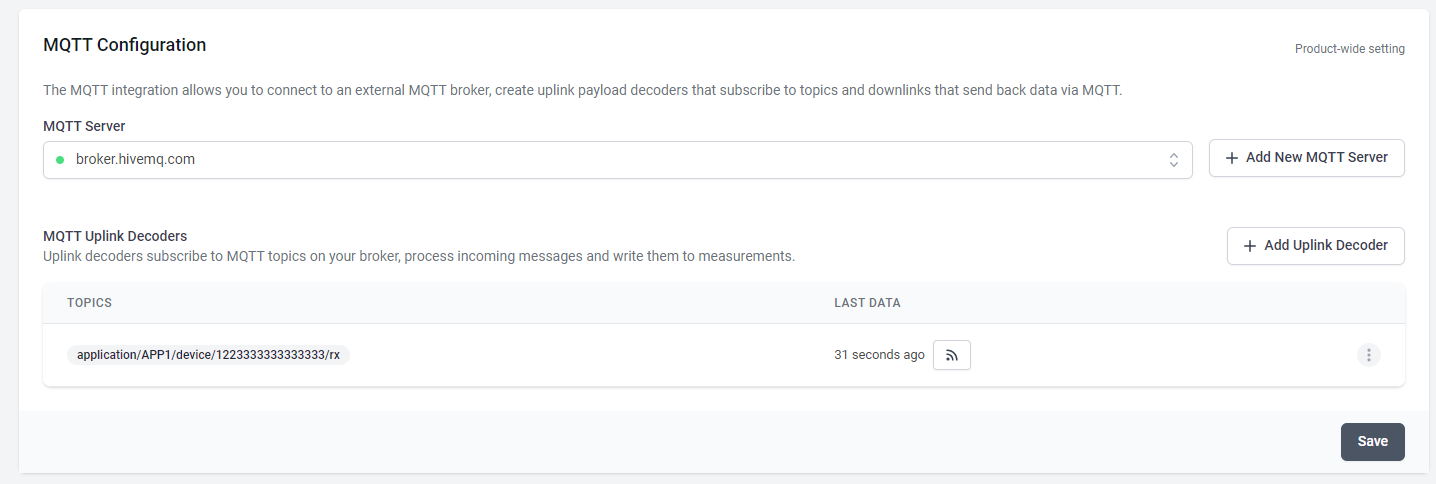

  2. Under Product & Hardware, scroll to MQTT Configuration.
    MQTT Configuration

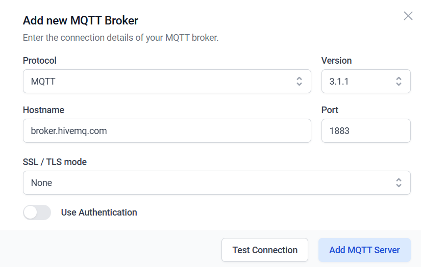

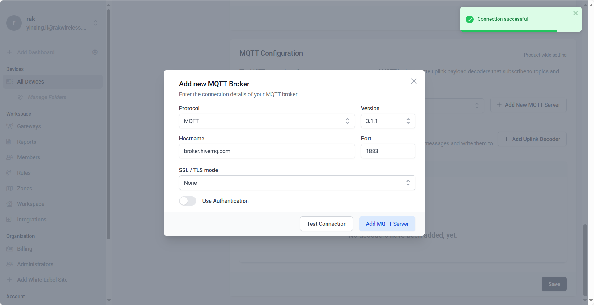

  3. Click + Add new MQTT Server and provide your broker details.
    Add new MQTT Server
NOTE
(Optional) Click Test Connection to check connectivity.
Add MQTT Broker

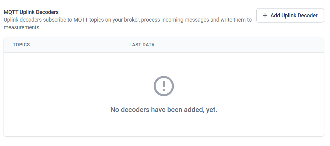

  1. Click Add MQTT Server.

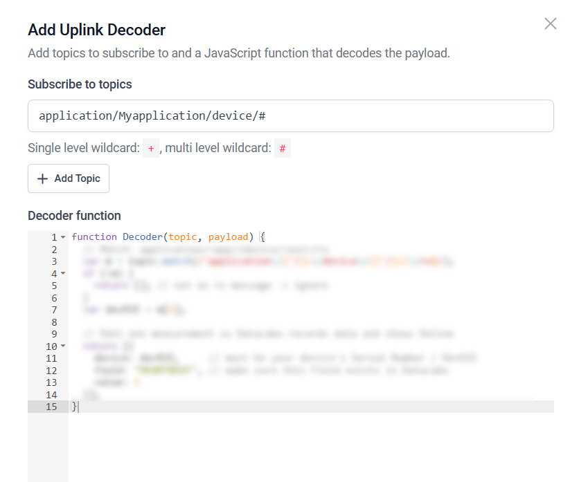

  2. Under MQTT Uplink Decoders, click + Add Uplink Decoder.
    Add Uplink Decoder

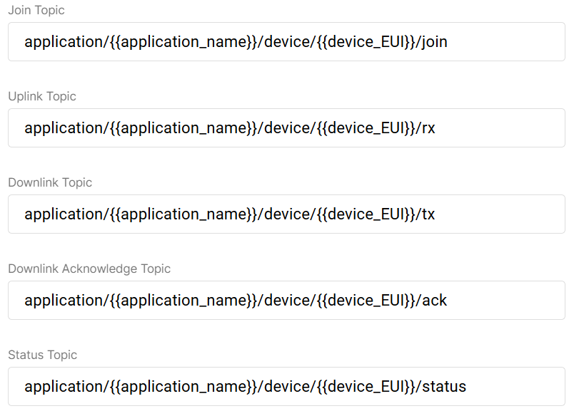

  3. Add the MQTT topics. Ensure that the format exactly matches the configuration on the gateway.
    Example: application/MyApplication/device/#
    Add the MQTT topics
  4. Provide a Decoder function if you want to parse payloads.
    Decoder function
  5. Click Add Uplink Decoder, then click Save.
Once the MQTT integration is active and uplinks are received, the Last Data column in Datacake will update with timestamps.

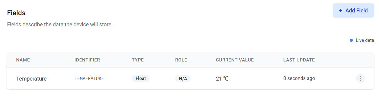

Create Fields in Datacake
In Datacake, device values are stored as Fields (data points).
  1. Go to the Fields tab.

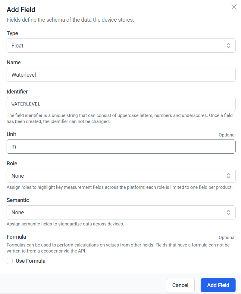

  2. Click + Add Field to create one or more data points for your device.
    Add Field
  3. Once uplink data is received, the Current Value column will update automatically.
    Current Value

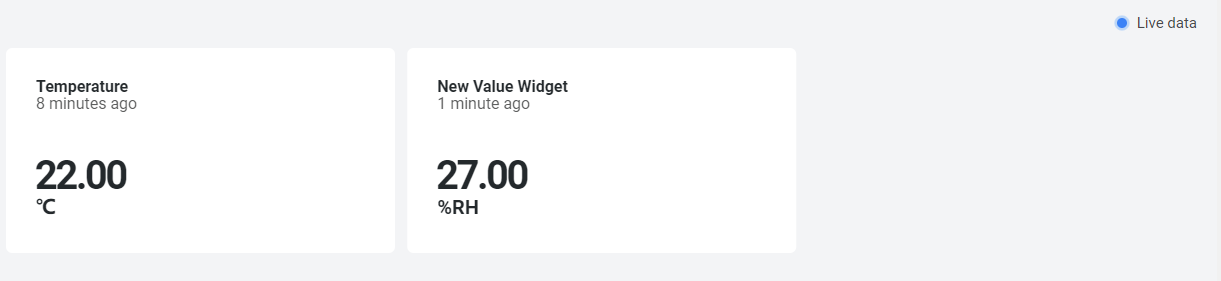

Visualize Data on Dashboard
  1. Open your device and switch to the Dashboard tab. Click the edit icon (Enable Edit mode ) to enable Edit mode.
    Dashboard tab

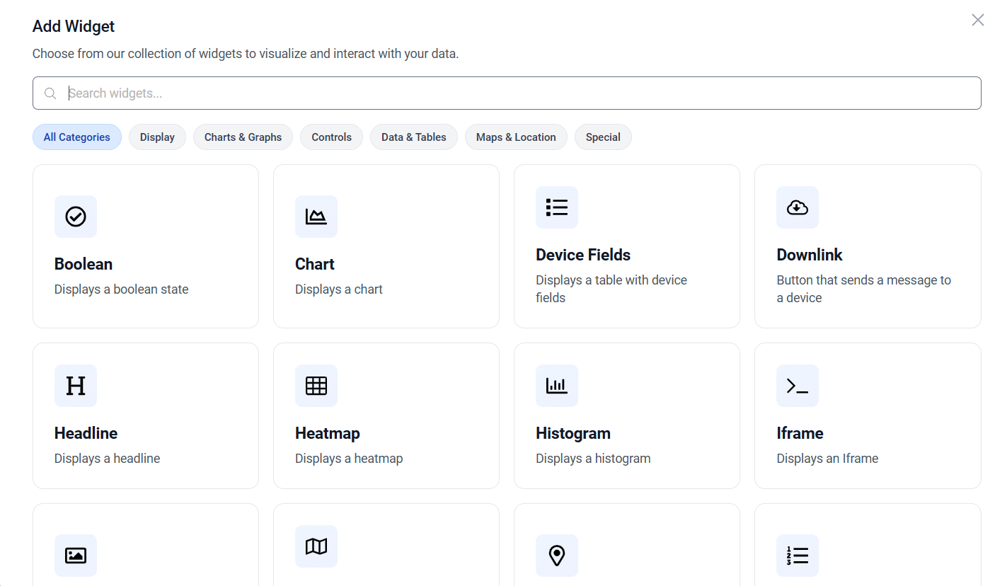

  2. Click + Add Widget and select a visualization type.
    Add Widget

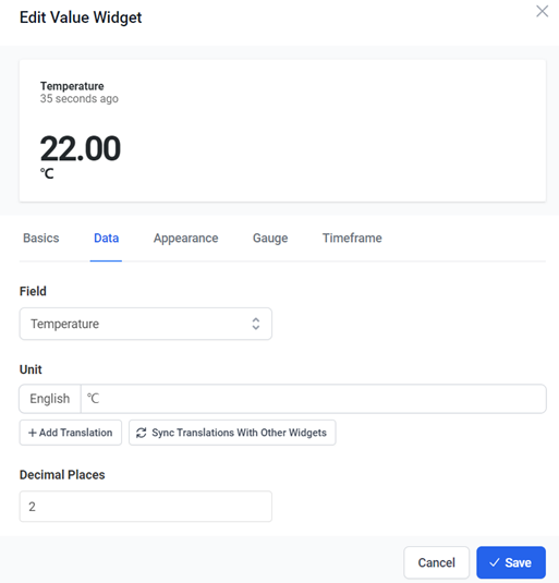

  3. Assign the widget to one of your device fields.
    Edit Value Widget
  4. Save your dashboard and exit Edit mode.
    Save Dashboard
NOTE
You can create multiple widgets if your device reports multiple sensor values.

  • Verify that the MQTT topics in Datacake exactly match the ones configured on the gateway (e.g., application/{{application_name}}/device/{{device_EUI}}/#).
