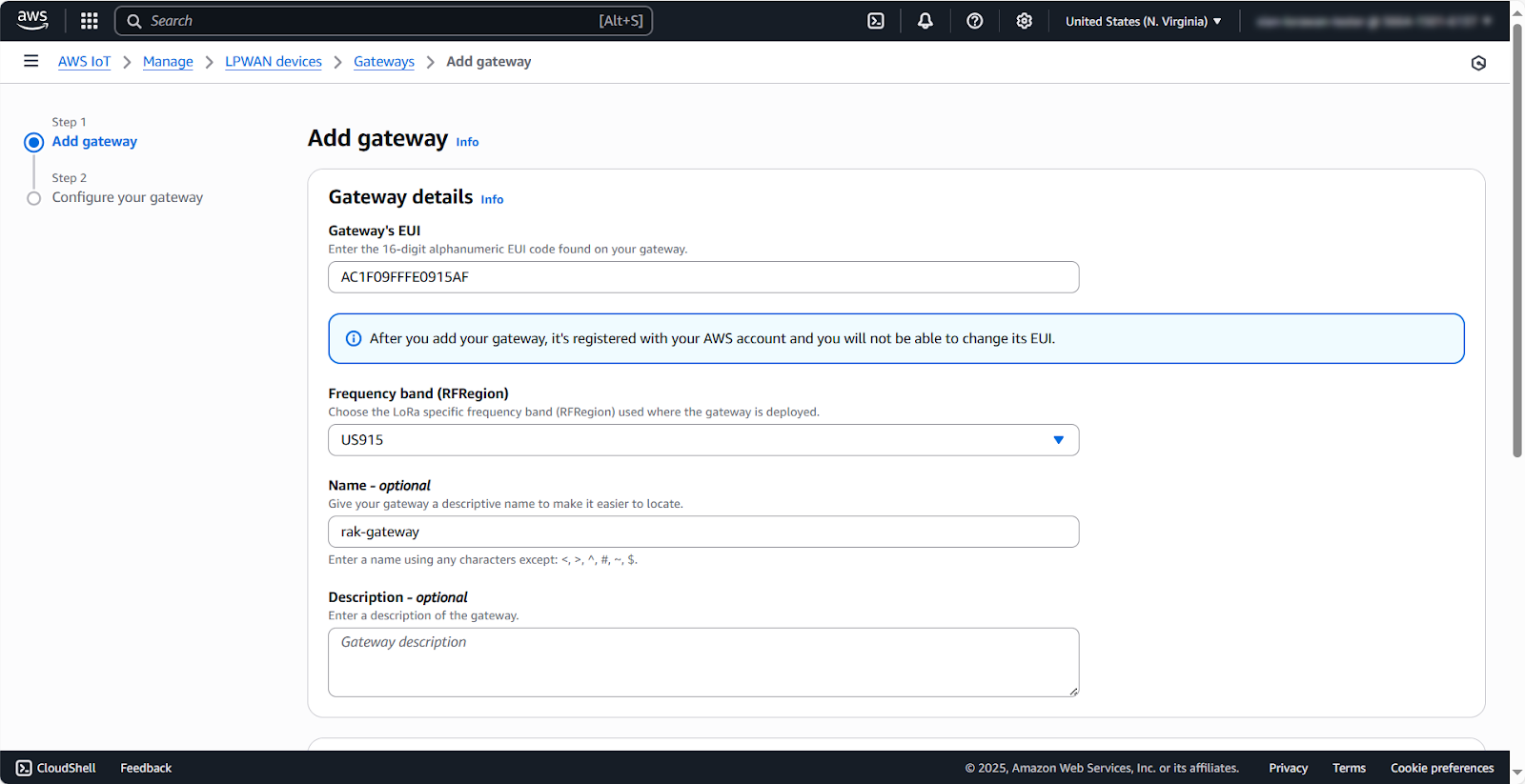

  1. In the Add gateway section, fill in the Gateway's EUI and Frequency band (RF Region) fields.
Fill in the Gateway details
  1. Click Add gateway. If a green success message appears, the gateway has been registered successfully.

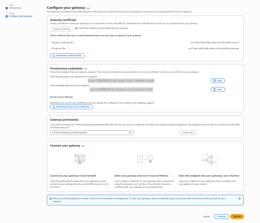

  1. On the Configure your gateway page, find the section titled Gateway certificate.
  2. Select Create certificate.
  3. Once the certificate is created and associated with your gateway message is shown, select Download certificate files to download the certificate (xxxxx.cert.pem) and private key (xxxxxx.private.key).
  4. In the section Provisioning credentials, choose Download server trust certificates to download the CUPS (cups.trust) and LNS (lns.trust) server trust certificates.
Download the CUPS
  1. Copy the LNS endpoint and save it in a .txt file for use while configuring the gateway.
  2. Choose Submit to add the gateway.

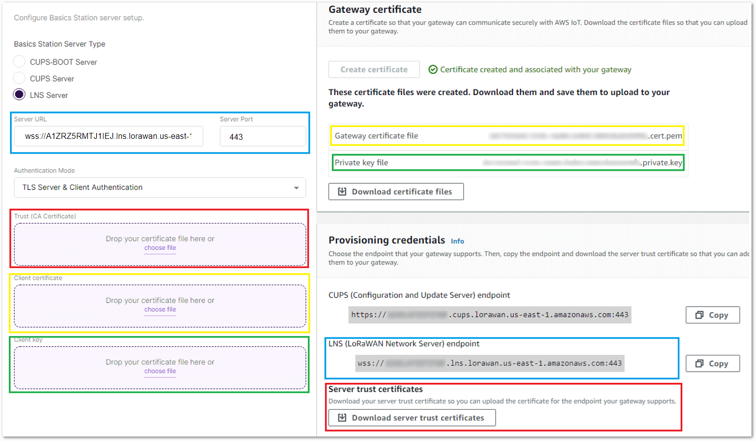

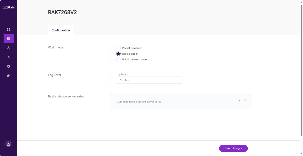

  1. Go to LoRa > Configuration, and set Work Mode to Basics station.
Changing the working mode
  1. Click Configure Basics Station server setup to expand the relevant settings panel. Configure the following parameters:
  1. Click Save changes.
