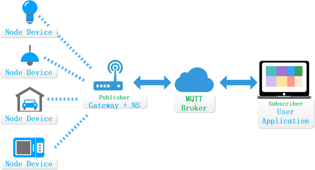

When the Generic MQTT Integration is enabled, the RAK gateway begins forwarding device events to your MQTT broker following this process:
  1. Device Communication
    End devices join the network or send uplink messages through the gateway.
  2. Packet Processing
    The Built-in Network Server (LNS) decrypts, validates, and classifies packets into event types.
  3. MQTT Message Construction
    The LNS converts each event into a structured JSON message.
  4. Topic Mapping and Publishing
    Each message is published to a predefined MQTT topic based on its event type.
  5. MQTT Broker Distribution
    The MQTT broker (local or cloud-based) distributes published messages to all subscribed clients.
  6. Data Consumption by Applications
    Applications or platforms subscribed to the relevant topics process the data in real time.

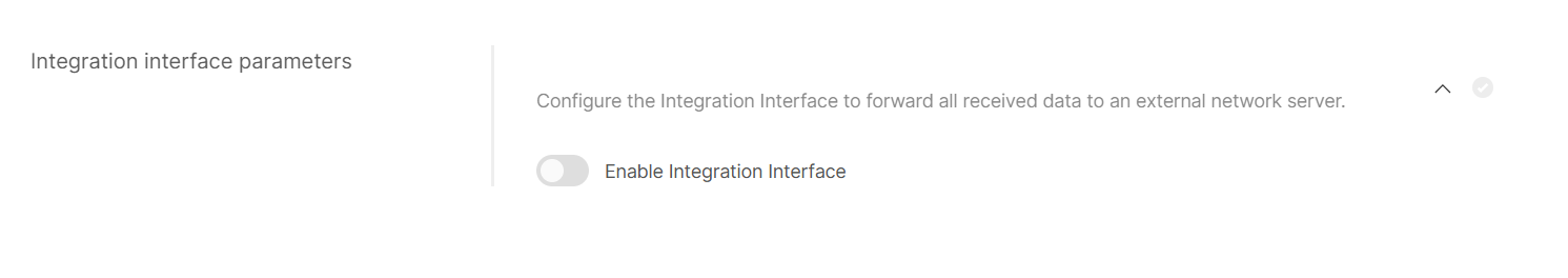

  1. Log in to the Web UI of the gateway.
  2. Navigate to LoRa® > Configuration > Integration interface parameters.

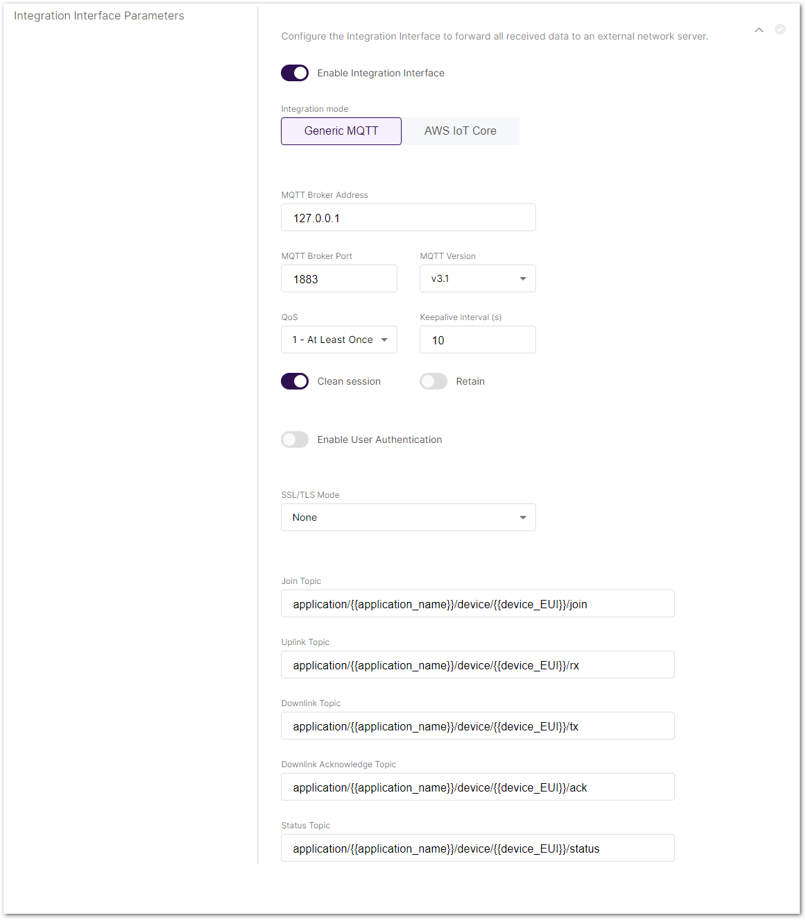

  1. Toggle Enable Integration Interface and select Generic MQTT .
  2. Configure the following parameters:
图形用户界面, 应用程序, Teams
描述已自动生成
  • MQTT Broker Address: The IP address of the MQTT broker.
  • MQTT Broker Port: The port used by the broker (default: 1883).
  • MQTT Version: MQTT protocol version .
  • QoS: Quality of Service level
  • Keepalive interval (s): Interval in seconds to keep the connection alive (default: 10).
  • Clean session: When enabled, the broker does not store session data.
  • Retain: If enabled, the last published message is retained.
  • Client ID: ID used to associate with the topic (auto-generated if left empty).
  • Enable User Authentication: Enable and provide MQTT username/password credentials.
  • SSL/TLS Mode: Choose connection security
  • TLS Version: Select TLS version.
  • Join Topic / Uplink Topic / Downlink Topic / Downlink Acknowledge Topic / Status Topic: Predefined MQTT topics for uplink, downlink, and status updates.
  1. Click Save changes to apply your settings.
