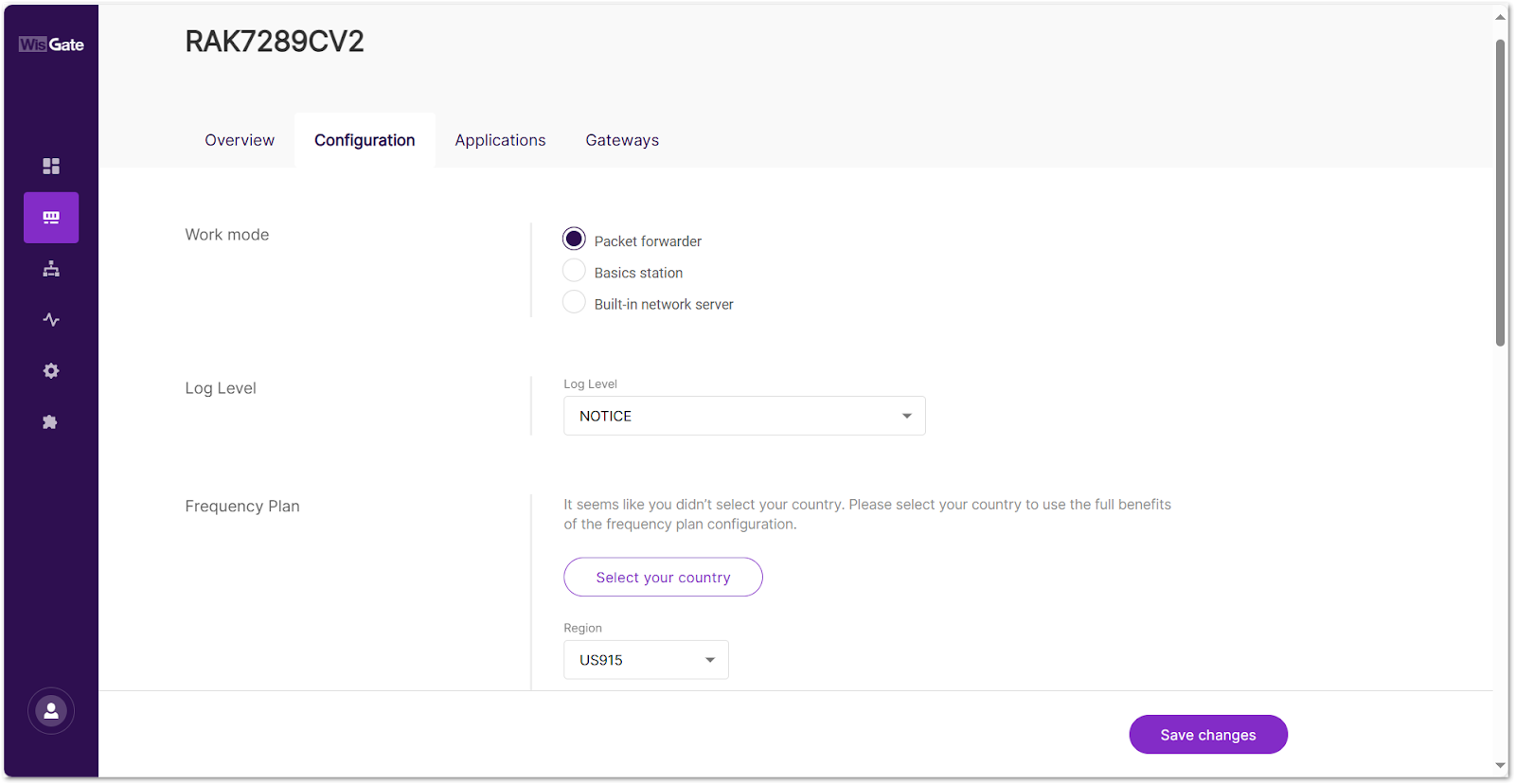

  1. Navigate to the LoRa > Configuration tab.
  2. Set Work mode to Packet forwarder.
NOTE
Fake GPS is only available in Packet Forwarder mode.
Figure 2: Packet Forwarder mode

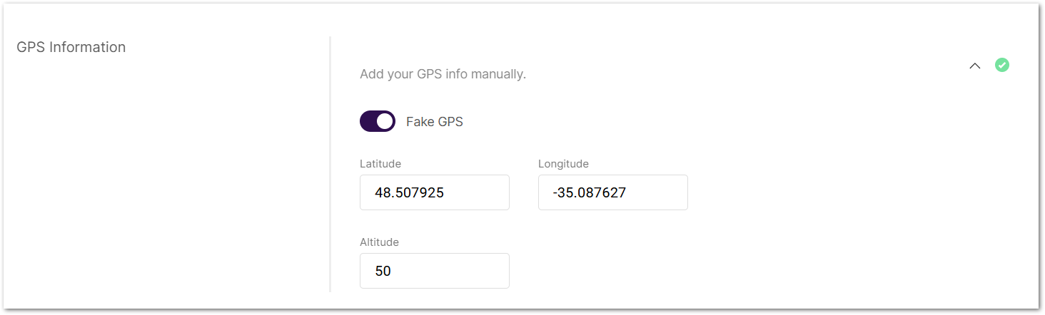

  1. In the GPS Information section, click Add your GPS info manually to expand the menu.
  2. Enable Fake GPS and enter the following values:
    • Latitude
    • Longitude
    • Altitude
Enable Fake GPS
Figure 3: Enable Fake GPS
  1. Click Save changes.
NOTE
Once the Fake GPS is enabled, the gateway will always use the manually configured coordinates, even if real GPS signals are available.

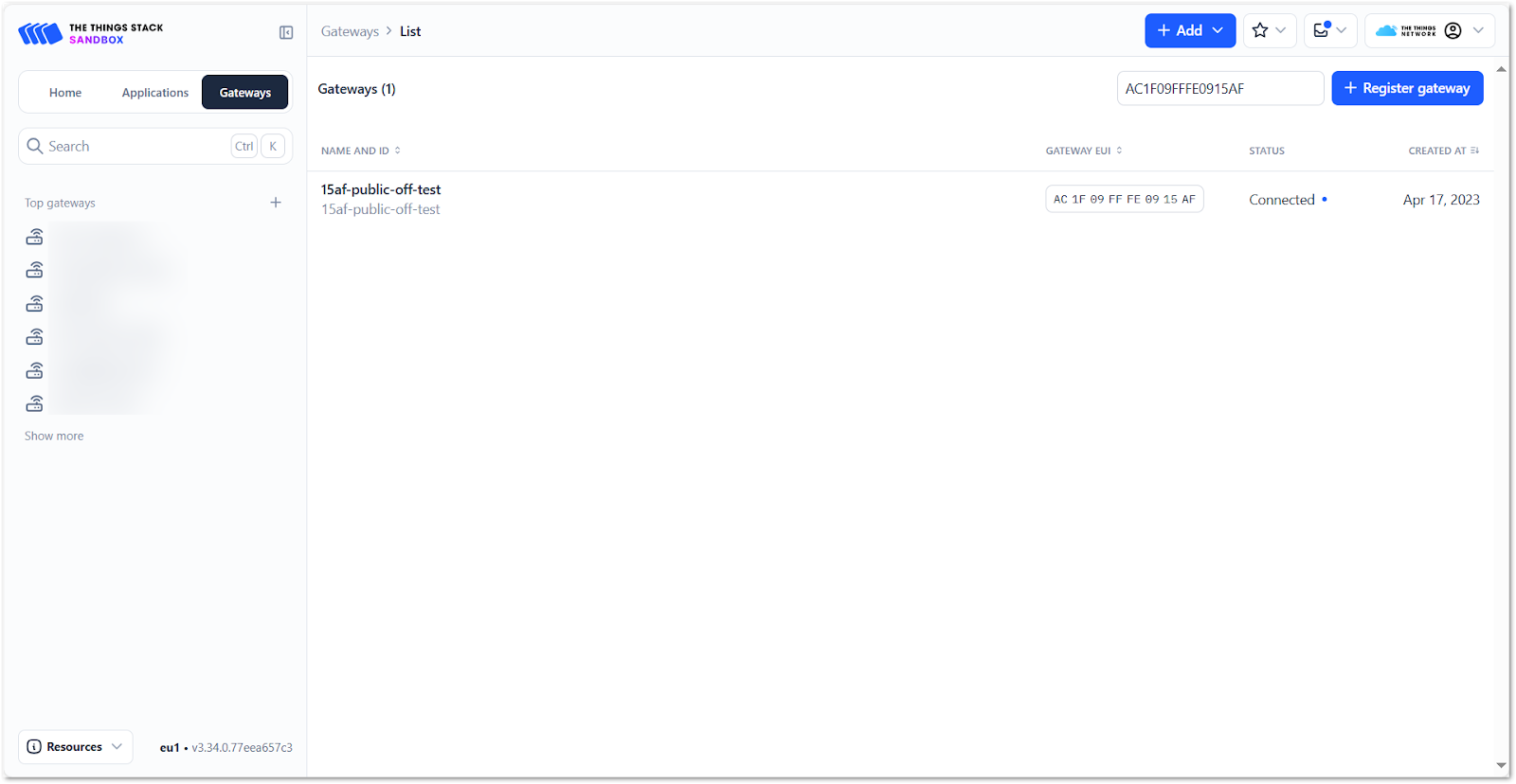

Check GPS Info in Location
  1. In TTN, go to Gateways and select the target gateway.
Select gateway
Figure 4: Select gateway

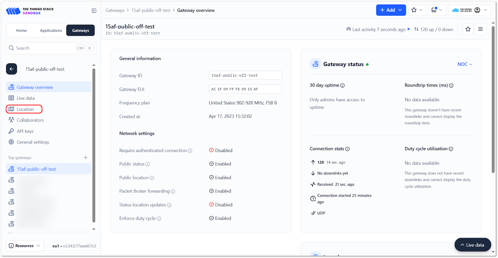

  1. Click Location in the left menu.
Click Location
Figure 5: Click Location

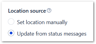

  1. Set Location Source to Update from status messages, then click Save Changes.
Location settings
Figure 6: Location settings

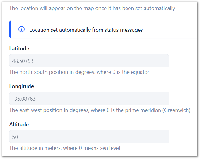

  1. Confirm that the GPS coordinates in the details panel match your Fake GPS settings.
GPS information
Figure 7: GPS information

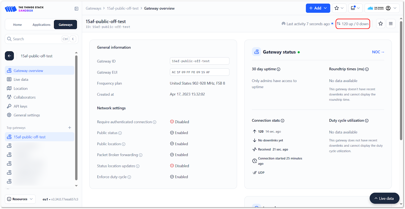

  1. Open the gateway’s detail page and view the Uplink/Downlink status.
Figure 8: Uplink/Downlink status

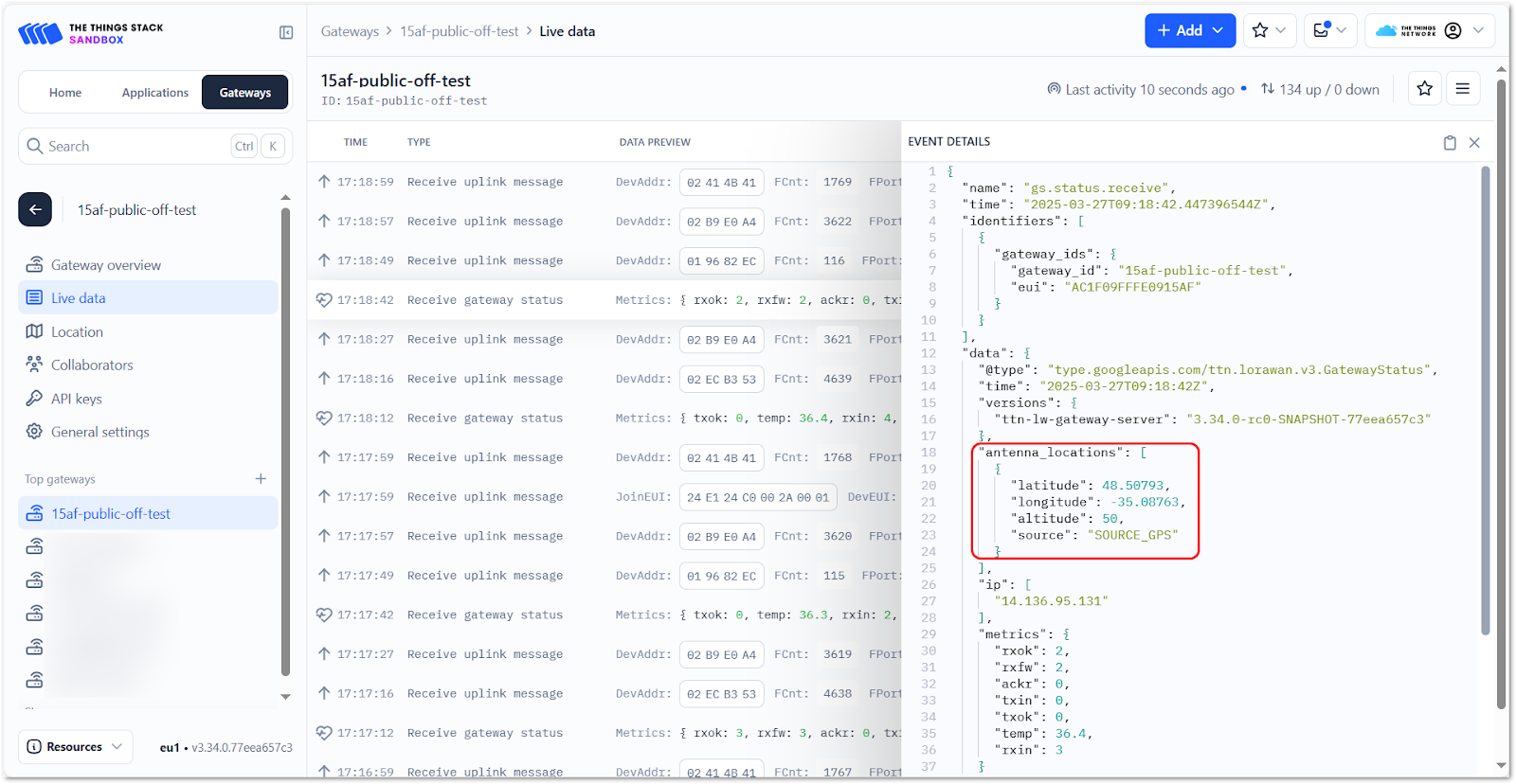

  1. Open the Receive gateway status uplink message.
  2. Check if the antenna_locations field matches the Fake GPS coordinates.
Confirm GPS data
Figure 9: Confirm GPS data
