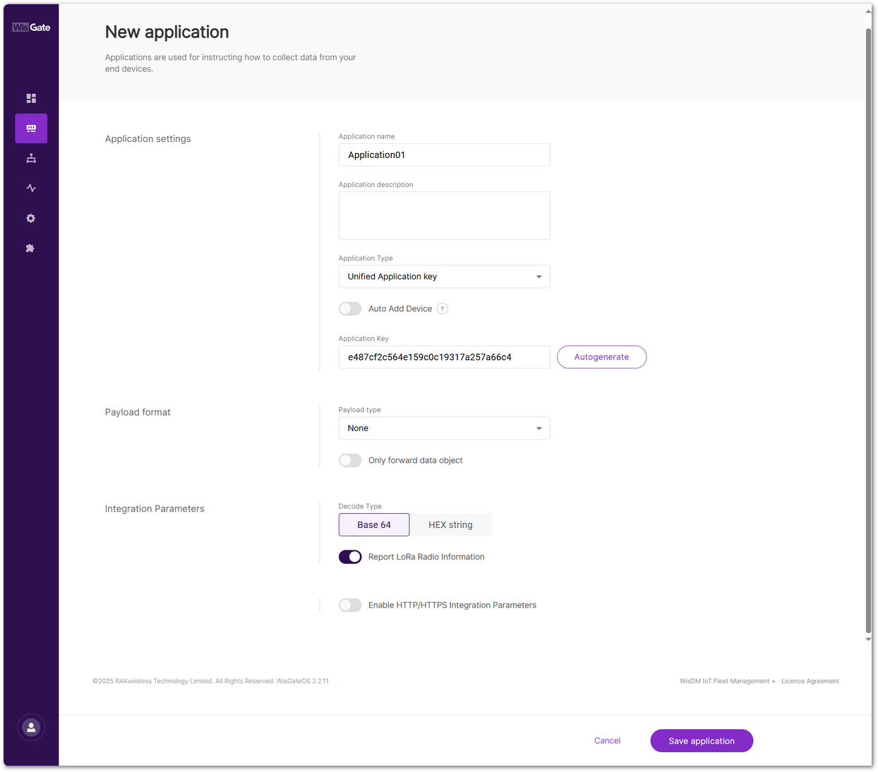

  1. Set the following parameters:
  • Application name: A unique name for the application.
  • Application description: (Optional) description of the application.
  • Application Type
    • Unified Application key: All devices will use the same application key.
    • Separate Application keys: Each device or group of devices has a unique key.
  • Auto Add Device: When enabled, devices with a matching AppKey and Application EUI will be added automatically after a successful join request. This is useful for mass deployment of identical devices.
  • Application Key: Required for Unified Application Key setup.
  • Application EUI: Required for automatic device registration when Auto Add Device is enabled.
  • Payload type
    • None:  No specific payload format.
    • CayenneLPP: Payload format based on the Cayenne Low Power Payload (LPP) standard.
  • Only forward data object: If enabled, the gateway will only forward the raw data object to the server without processing or decoding it.
  • Decode Type
    • Base 64
    • HEX string
  • Report LoRa Radio Information: If enabled, the gateway will include LoRa signal data (RSSI, SNR, etc.) in the payload sent to the server. This may increase packet size.
  • Enable HTTP/HTTPS Integration Parameters: If enabled, allows forwarding of uplink data and events to external HTTP/HTTPS endpoints.
    • Header name
    • Header value
    • Uplink data URL
    • Join notification URL
    • Ack notification URL
    • Device-status notification URL
    • Maximum number of concurrent connections
    • Maximum length of the queue
Enter new application details
Figure 3: Enter new application details
5. Click Save application.

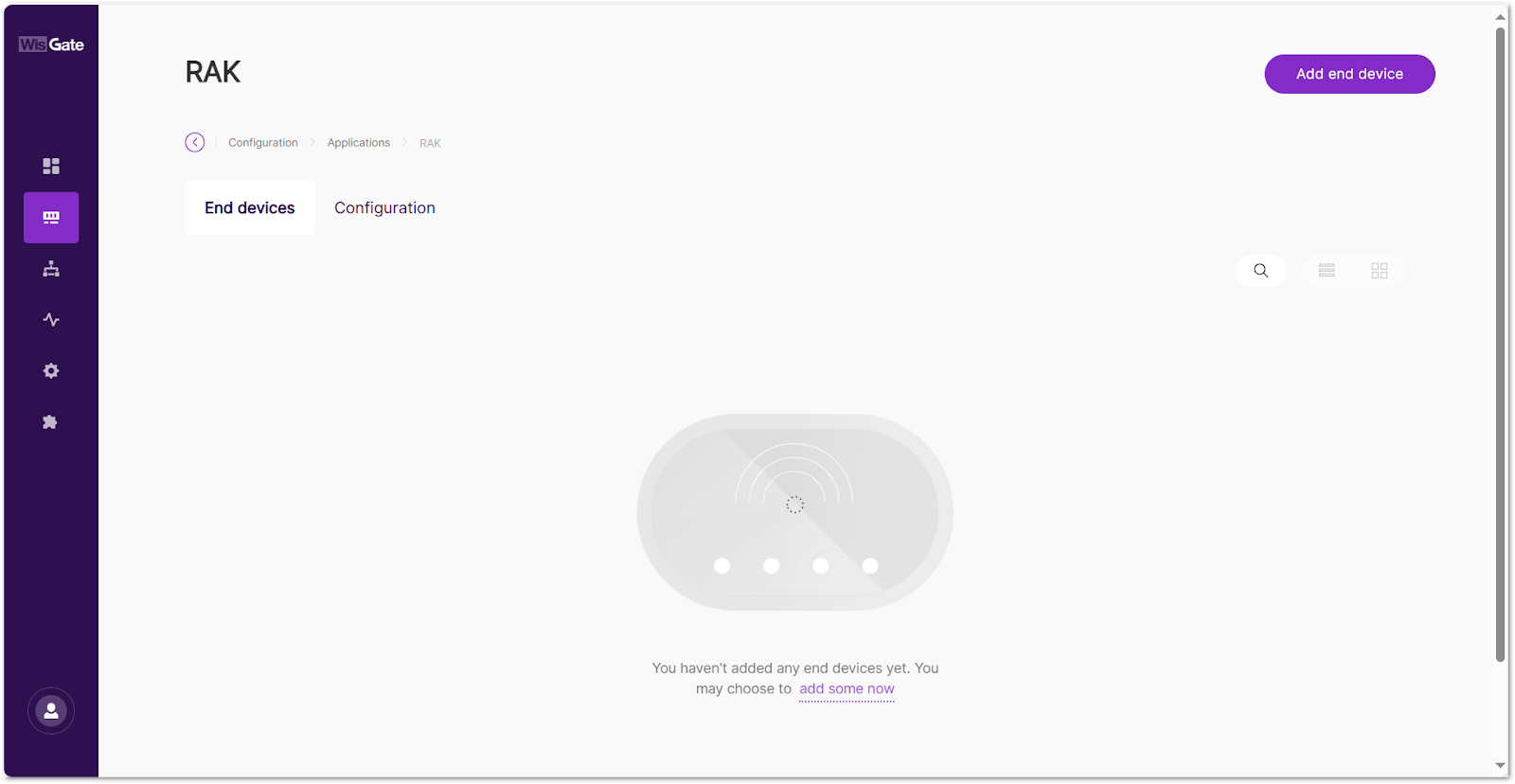

  1. Navigate to the LoRa > Applications tab.
  2. Click on the application where the device should be added.
Figure 4: Enter new application details
NOTE
You can also click Add end devices in the END DEVICES list. This option appears only if no end devices are currently registered.
  1. In the End devices tab, click Add end device.
Add end device
Figure 5: Add end device

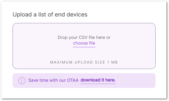

CSV Import
CSV importing is the most efficient method for registering large numbers of devices.
  1. Prepare a CSV file in one of two ways:
  • Download the template by clicking download it here.
  • Create your file following the required structure.
Prepare a CSV file
Figure 13: Prepare a CSV file
Required CSV fields:
Mode Required Fields Parameter Format
OTAA
End Device EUI
16-digit EUI from product label
ABP
End Device EUI, End Device Address
16-digit EUI and 8-digit address from product label
IMPORTANT
The CSV file size must not exceed 1 MB.

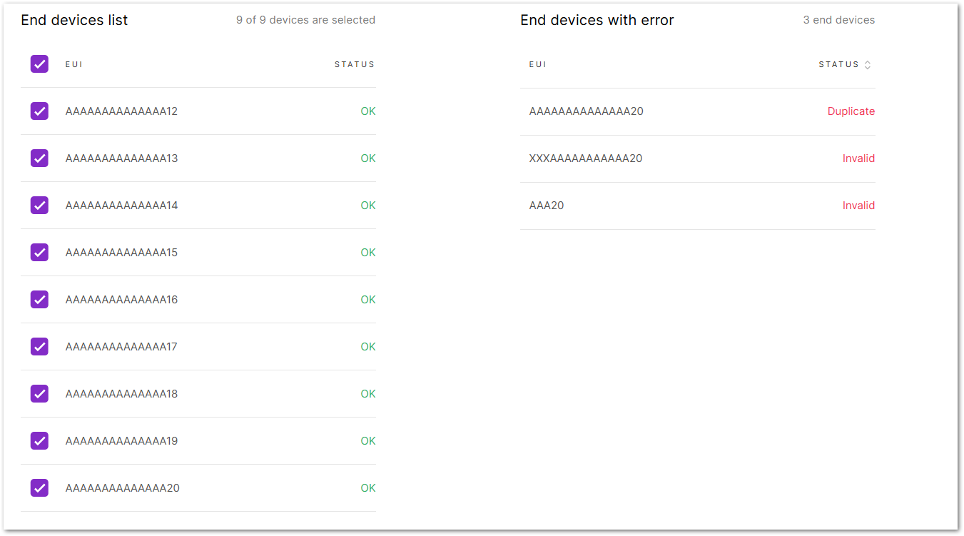

  1. Click choose file or drag and drop your CSV into the upload box.
NOTE
The system will verify all entries together in one batch.
  • Valid devices appear under the End devices list.
  • Duplicate or invalid devices appear under End devices with error for correction.
End devices list showing valid entries and errors
Figure 14: End devices list showing valid entries and errors

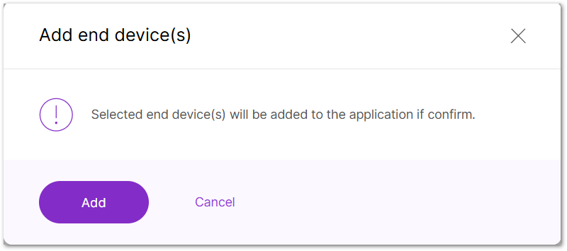

  1. To finalize the registration, click Add end devices, then Add to confirm and proceed.
Click Add end devices
Figure 15: Click Add end devices

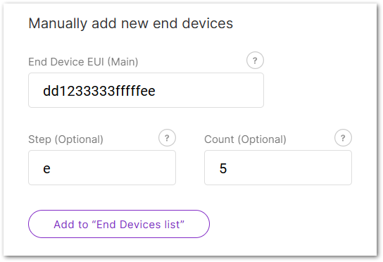

Bulk Generate
Bulk generating is ideal for production-line provisioning or when devices follow a predictable sequence.
  1. In the Adding end devices interface, enter the following:
  • End Device EUI (Main): Base EUI to start the sequence. (Required)
  • End device address (Main): Base address. (Required for ABP mode)
  • Step (Optional):  HEX increment value.
  • Count (Optional): Number of devices to generate.
Enter device EUI, Step, and Count
Figure 10: Enter device EUI, Step, and Count

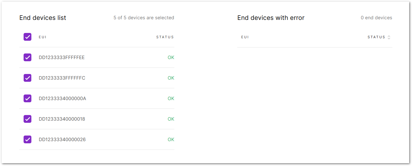

  1. Click Add to "End Devices list". The system will verify the generated entries.
Figure 11: End devices list showing valid entries and errors
Figure 12: Click Add end devices
Troubleshooting
Issue Possible Cause Solution
CSV Import Error: "Invalid"
The DevEUI is not 16 hexadecimal digits, or the field is empty.
Make sure the DevEUI is correctly formatted as 16 hexadecimal digits, then retry.

  2. What happens if I upload a CSV file with duplicate devEUIs?
    Duplicates appear under End Devices with an error and are not registered. Correct them and re-upload the CSV.
  3. Can I re-upload the same CSV after fixing errors?
    Yes. After correcting the file, re-upload it. Only valid, non-duplicate devices will be registered.
