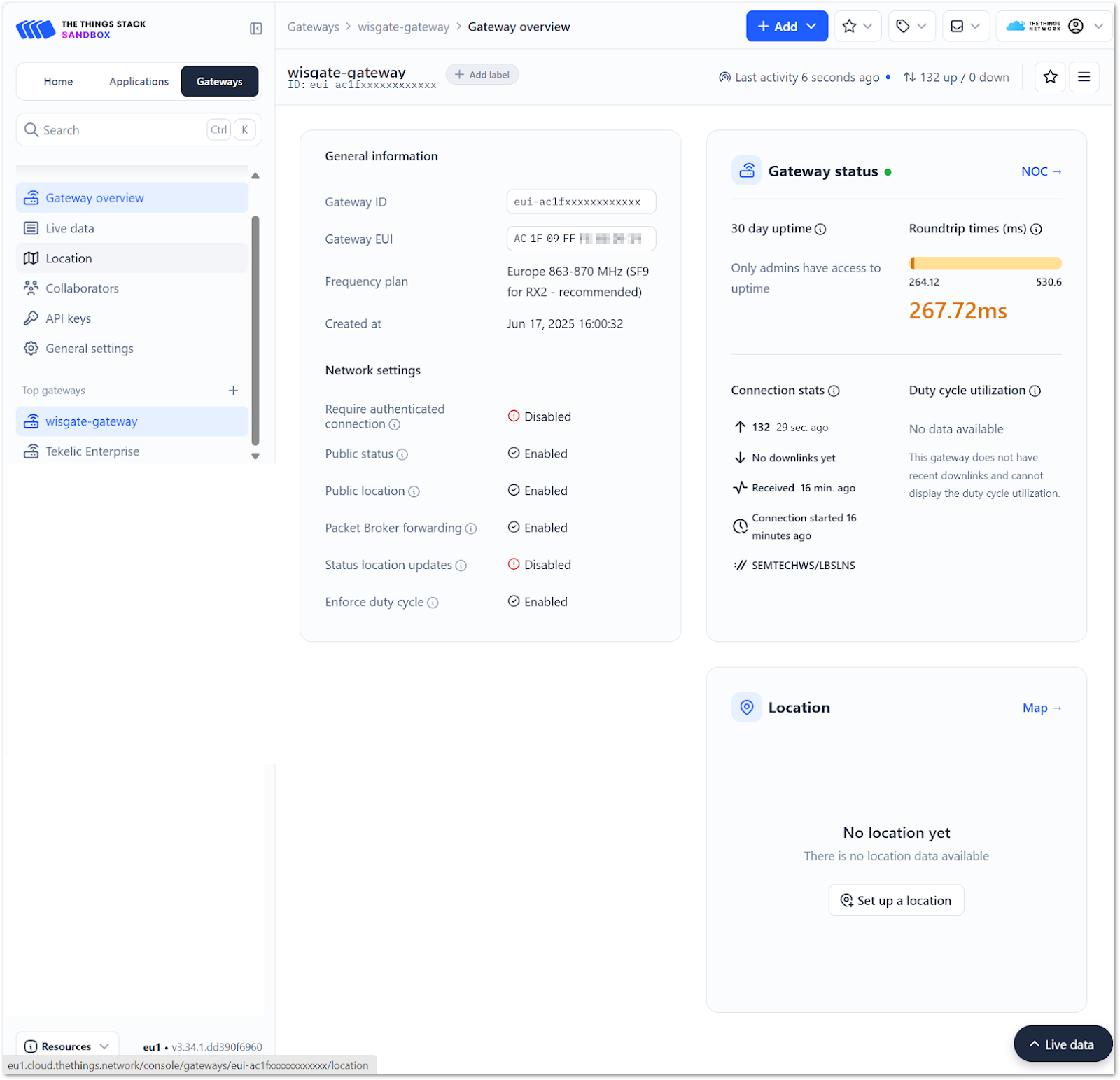

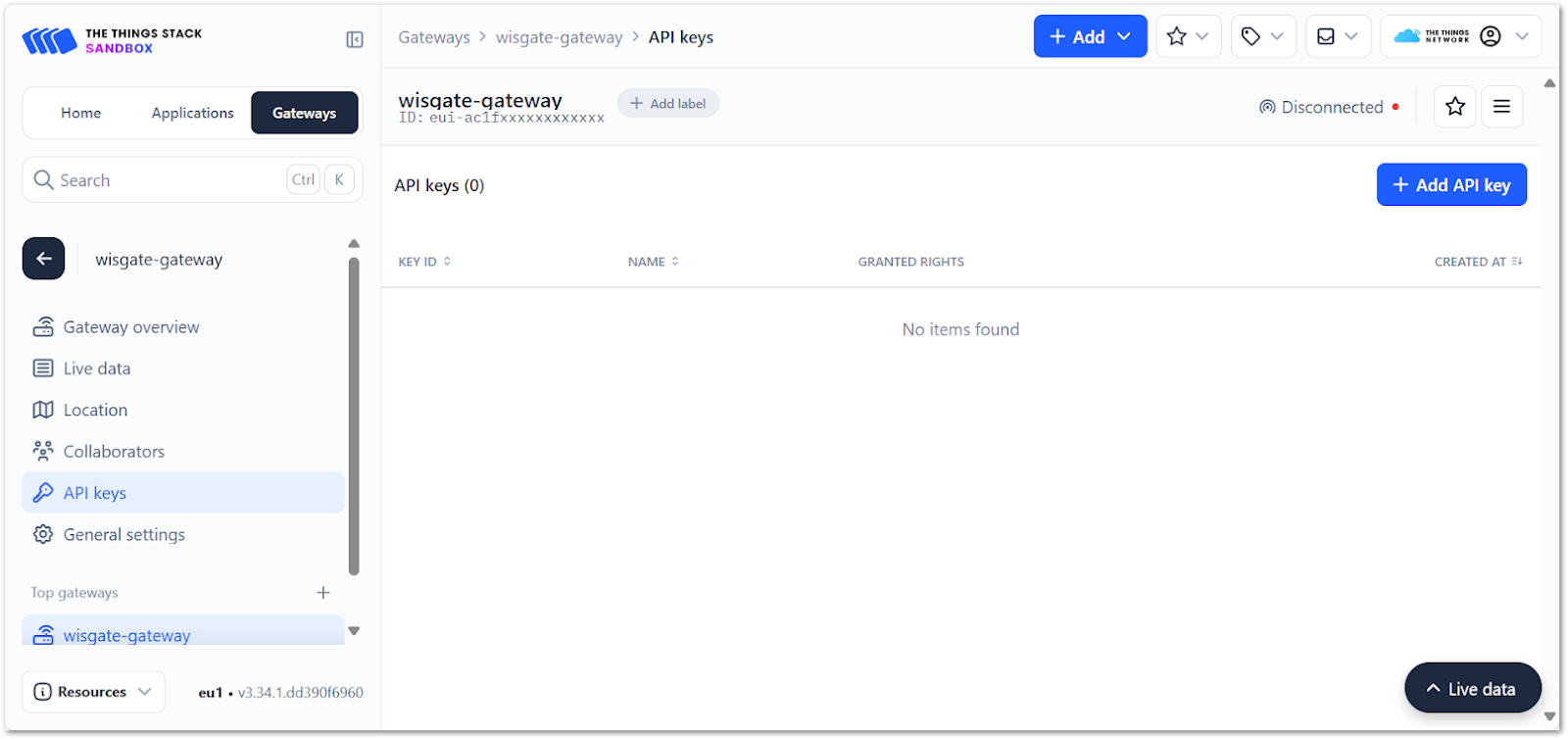

  1. To generate a key file, navigate to API keys from the Overview page of the registered gateway.
Figure 1: The Things Stack Gateway Overview
  1. On the API Keys page, click + Add API Key.
Figure 2: The Things Stack Gateway API Keys Overview

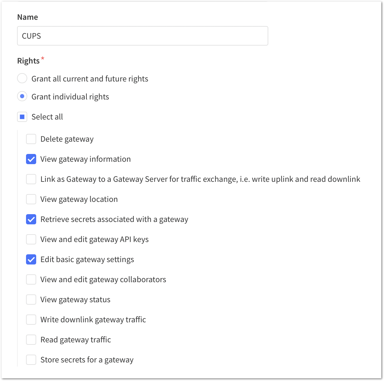

  1. In the Name field, enter a name such as CUPS.
  2. Select Grant individual rights, then enable the following permissions:
  • View gateway information
  • Retrieve secrets associated with a gateway
  • Edit basic gateway settings
Figure 3: The Things Stack CUPS API Key Parameters
  1. Click Create API Key to proceed.

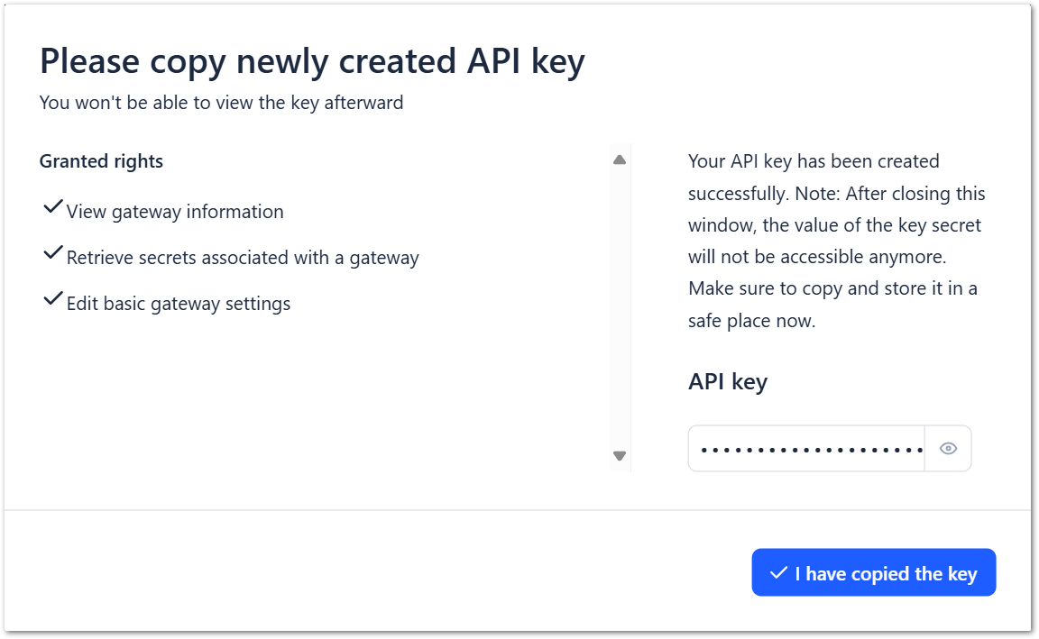

Figure 4: The Things Stack CUPS API Key Created
WARNING
Copy the key and save it in a .txt file (or other), because you won’t be able to view or copy your key after that.
  1. Click I have copied the key to continue.

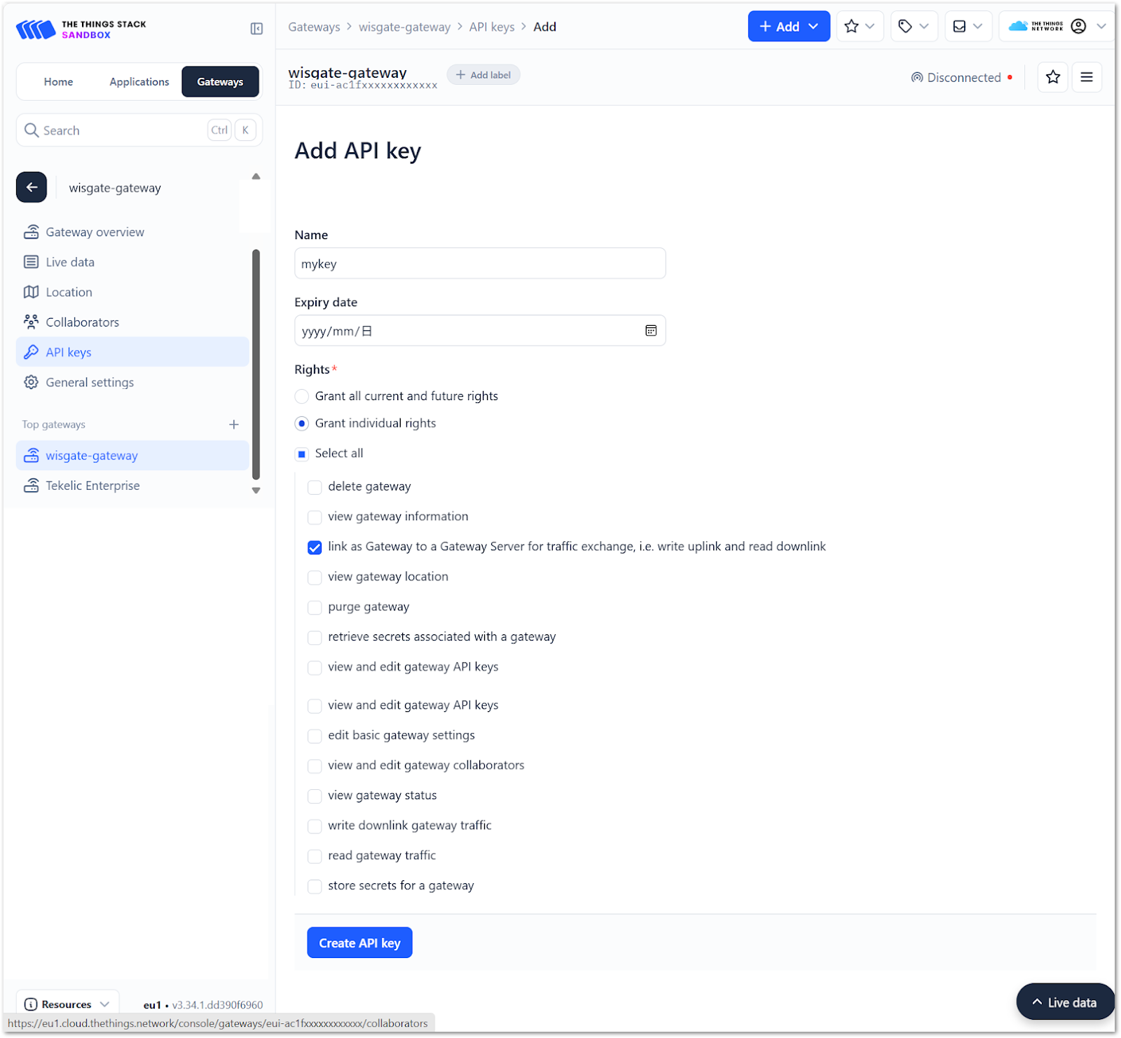

  1. On the same API keys page, click + Add API key again.
  2. In the Name field, enter a name such as LNS.
  3. Select Grant individual rights, then enable:
  • Link as Gateway to a Gateway for traffic exchange, i.e., write uplink and read downlink.
Figure 5: The Things Stack Add LNS API Key

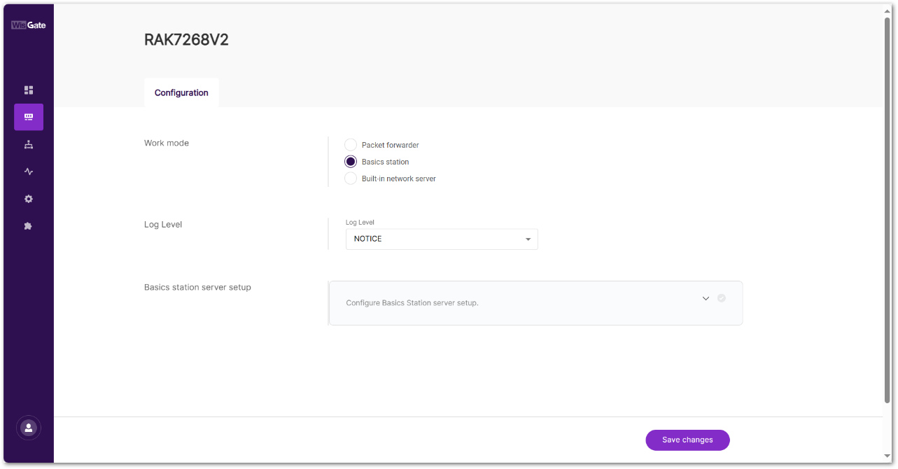

  1. Go to LoRa > Configuration and set Work Mode to Basics Station.
Figure 9: WisGateOS 2 Configuration Page

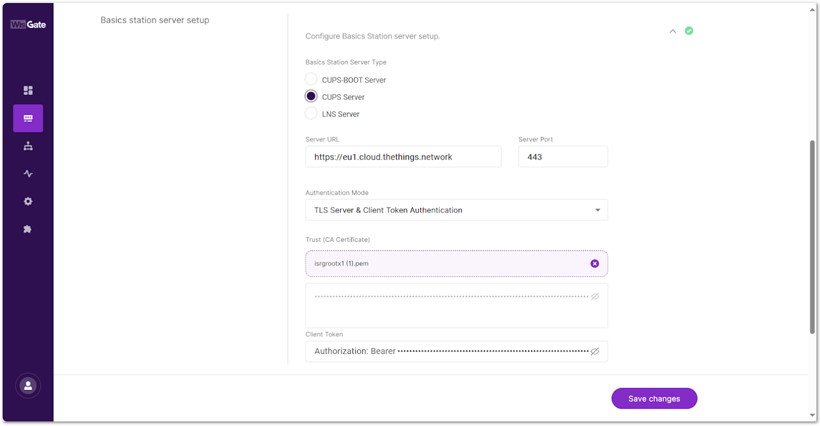

  1. Click Configure Basics Station server setup to expand the settings panel. Configure the following parameters:
  • Basics Station Server Type: CUPS Server.
  • Server URL: This is the link to The Things Network server. For this tutorial, the gateway is connected to the European cluster. For Europe, enter: https://eu1.cloud.thethings.network.
  • Server Port: 443
  • Authentication Mode: TLS Server & Client Token Authentication
  • Trust (CA Certificate): For Trust, upload the Let’s Encrypt ISRG ROOT X1 Trust certificate by clicking Choose File. You can download the certificate file here.
  • Client Token: Paste the CUPS API key you generated in the previous step.
Figure 10: WisGateOS 2 CUPS Server Configuration
  1. To save your changes, click Save changes.
If everything is configured correctly, you should see that the gateway is connected to TTN console.
Figure 11: The Things Stack Gateway Connected  Using CUPS
