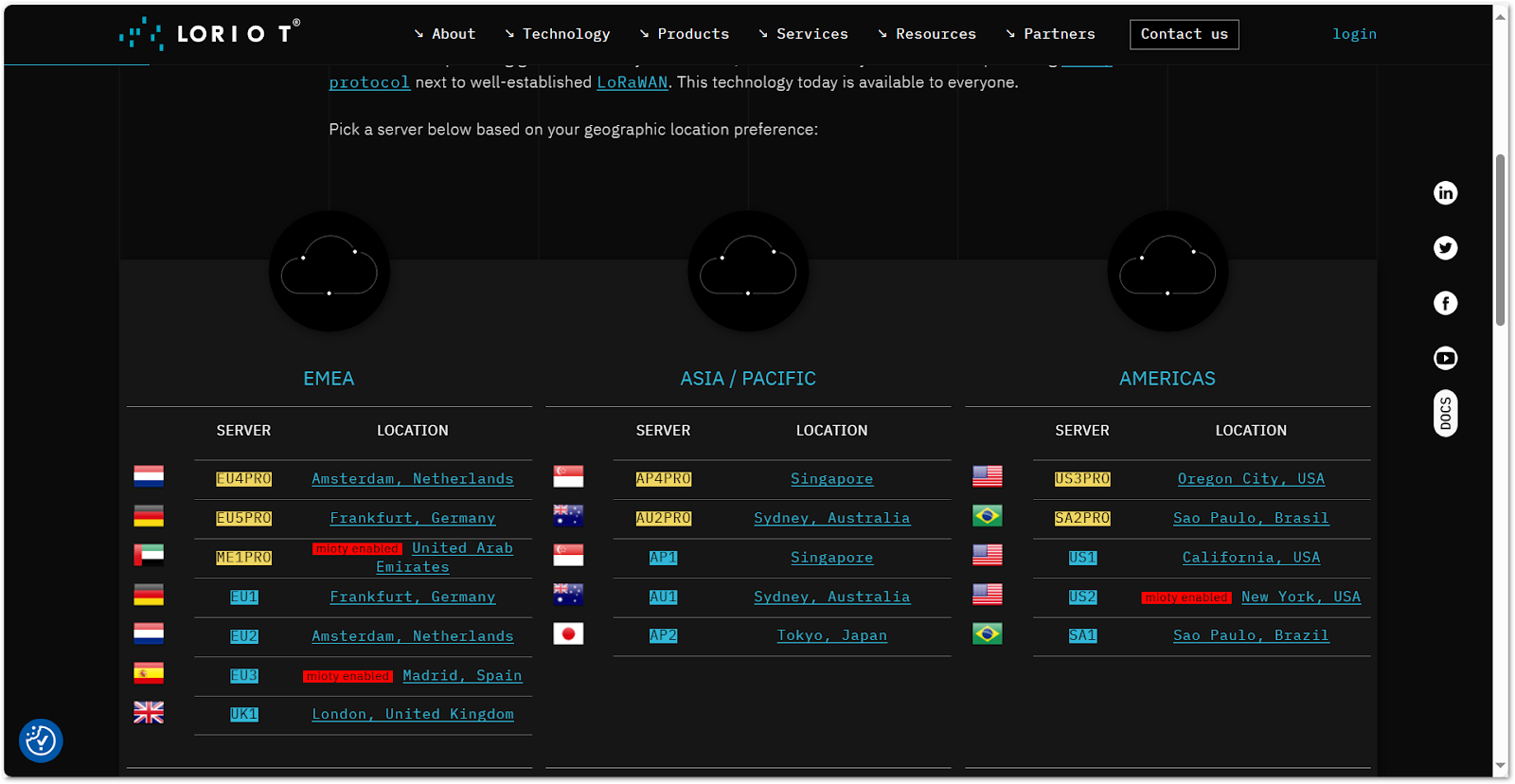

1. Based on your deployment location, choose the appropriate LORIOT server cluster.
LORIOT server cluster options
Figure 1: LORIOT server cluster options

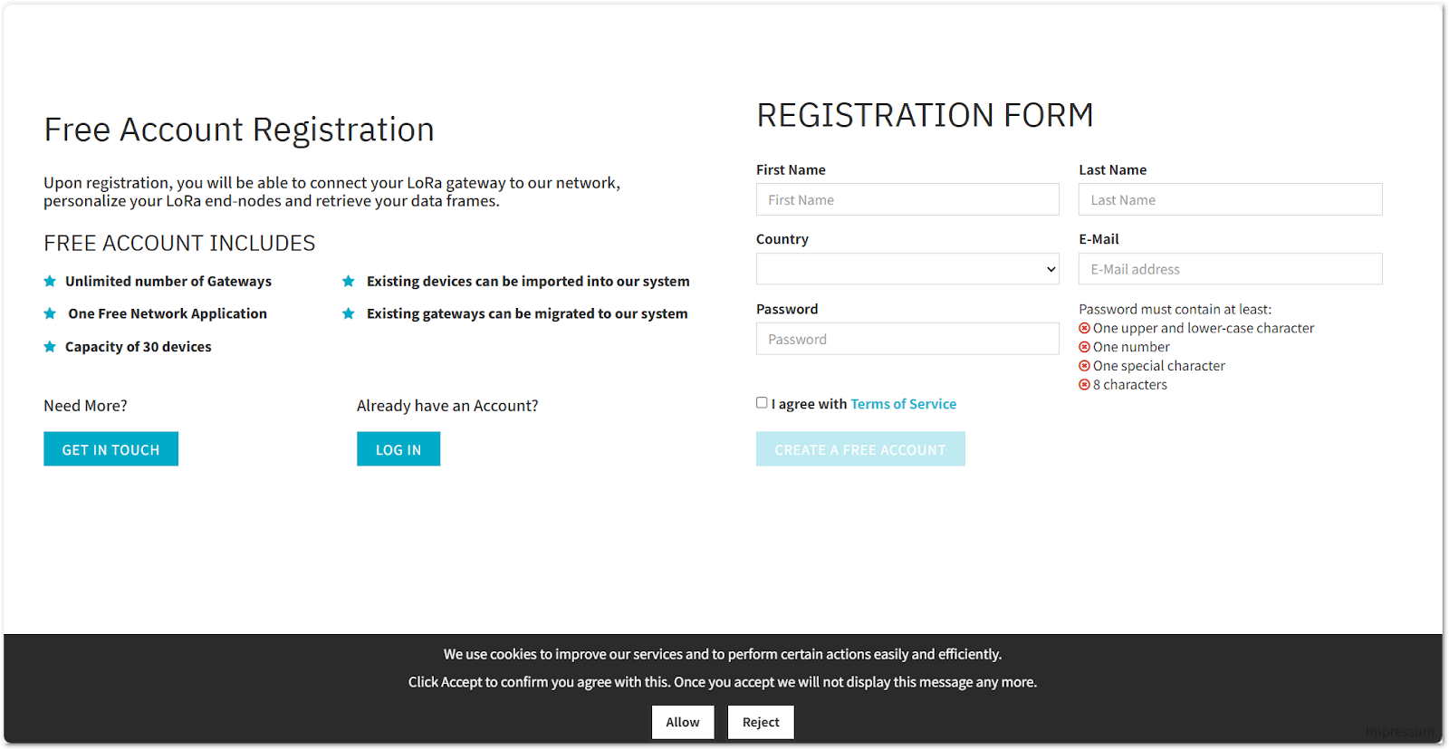

  1. Click LOG IN to access your account. If you don’t have an account yet, complete the registration form on the same page to create one.
LORIOT Web UI Registration Page
Figure 2: LORIOT web UI registration page

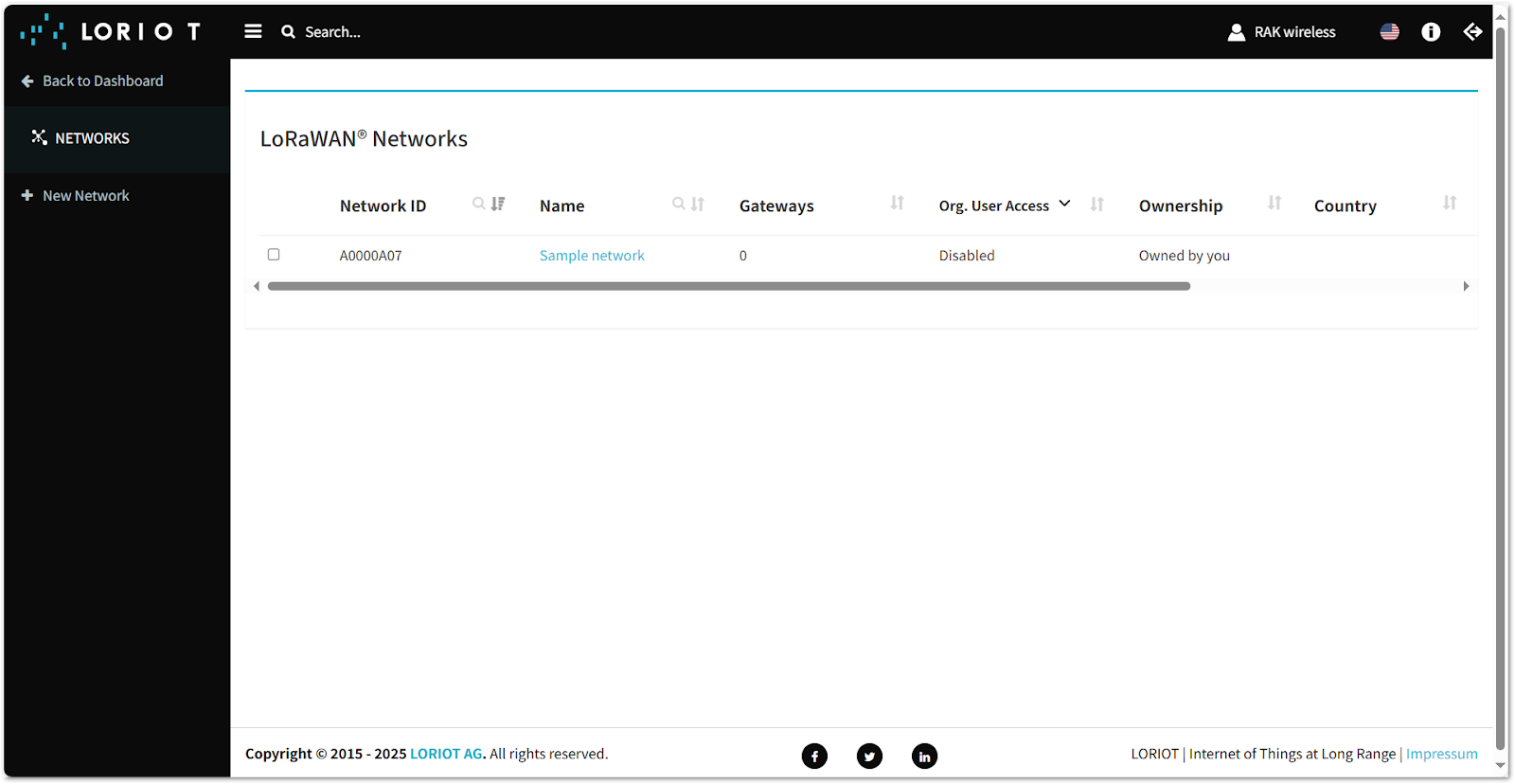

  1. In the left navigation menu, go to Networks.
LORIOT Networks Tab
Figure 3: LORIOT networks tab

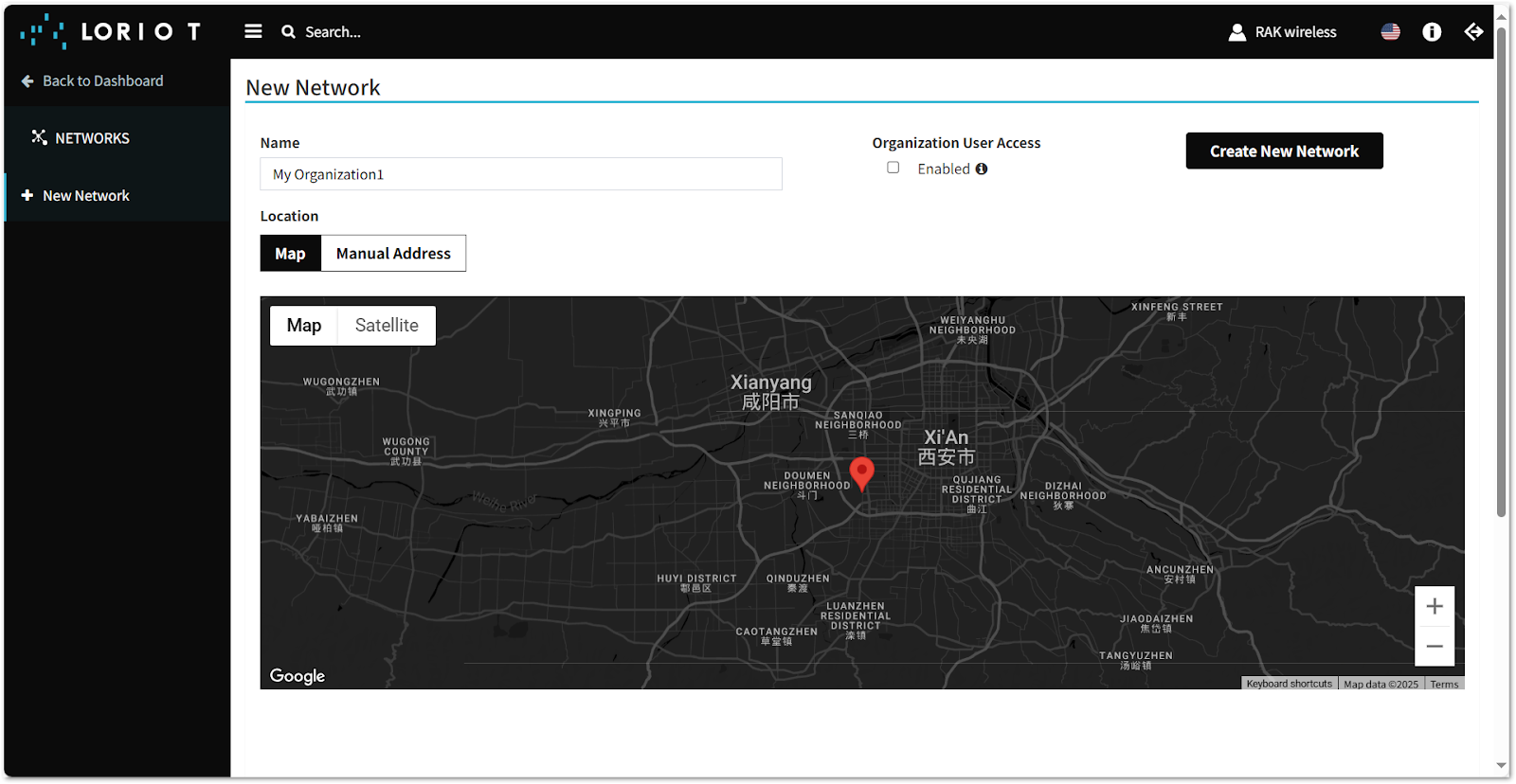

  1. Click + New Network.
Add New Network
Figure 4: Add new network
  1. Fill in the required details, such as Name, Organization User Access, and Location, then click Create New Network to proceed.
Fill in Network Details
Figure 5: Fill in network details

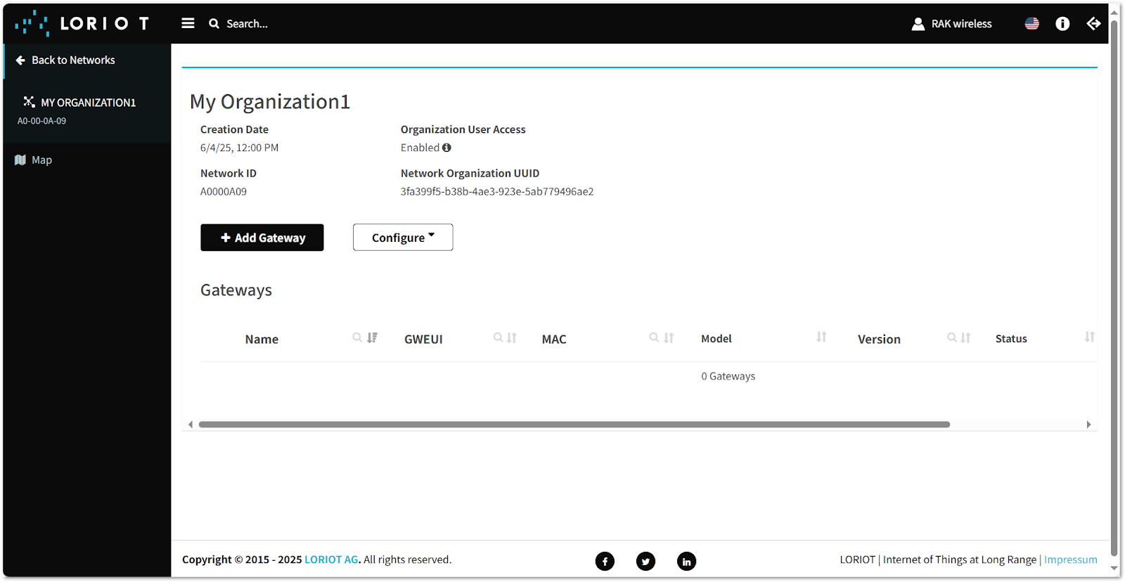

  1. Click + Add Gateway.
Figure 6: Add your gateway

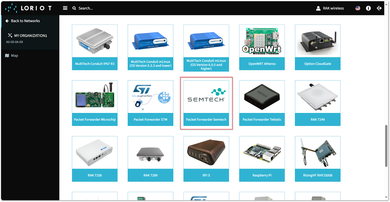

  • On the platform selection screen, choose Packet Forwarder Semtech to indicate that your gateway will use the standard Semtech UDP protocol.
Choose Packet Forwarder Semtech
Figure 7: Choose Packet Forwarder Semtech

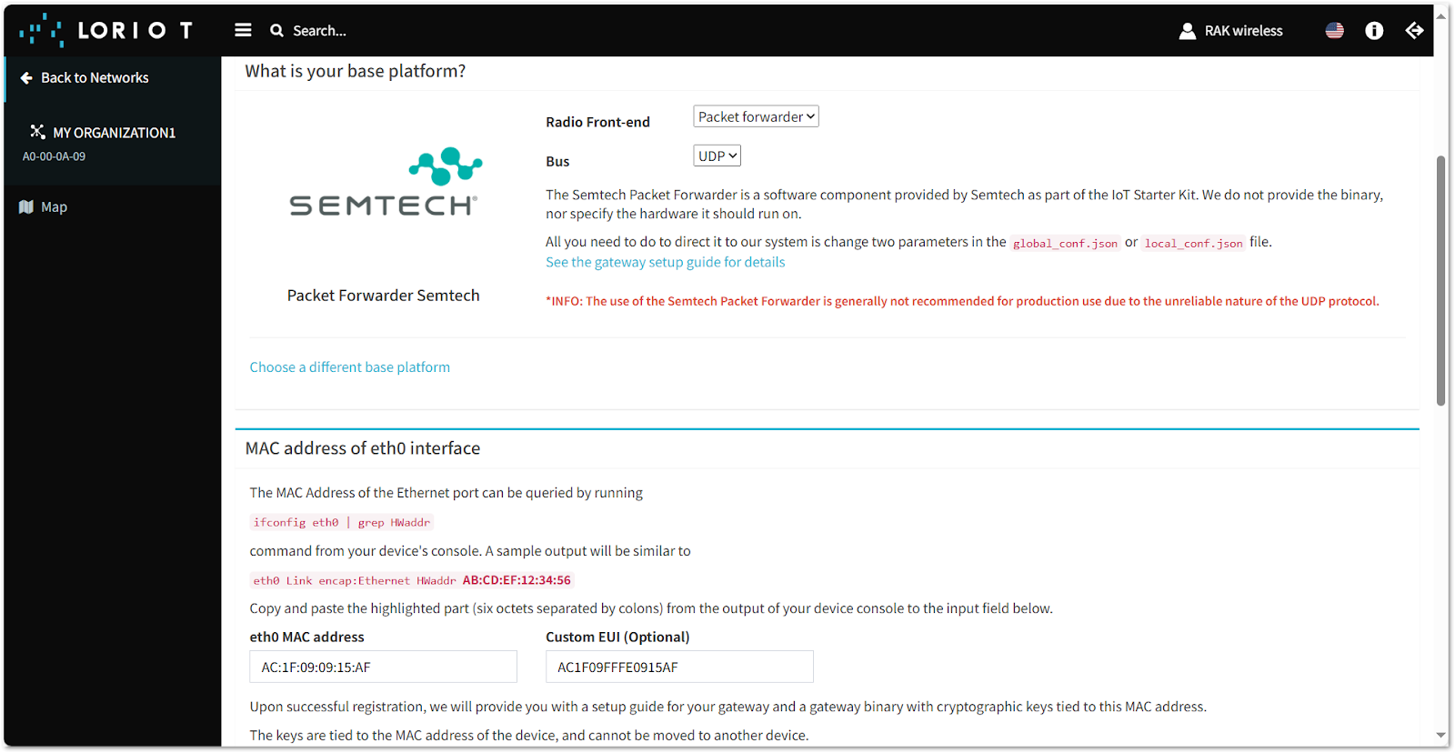

  • In the following form, provide your gateway’s MAC address and EUI.
Gateway MAC address and EUI
Figure 8: Gateway MAC address and EUI

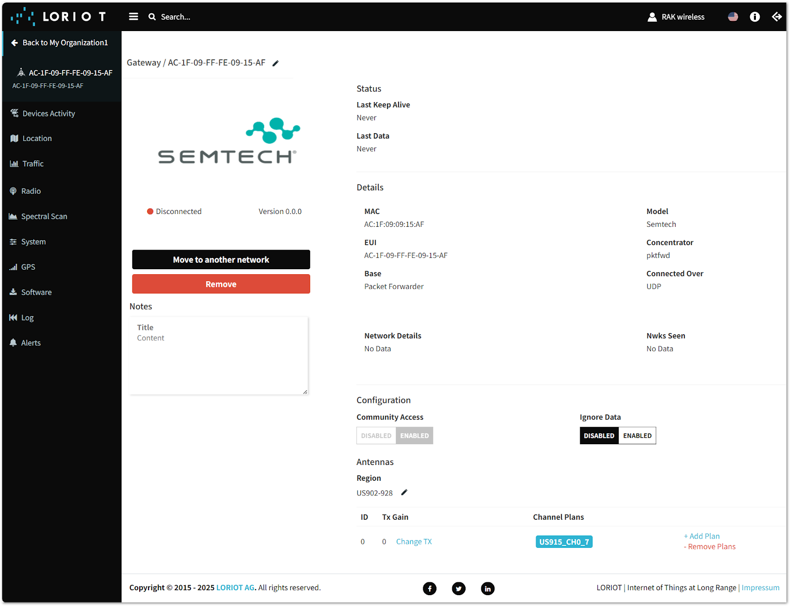

  1. Click Register Packet Forwarder Semtech gateway to complete the registration.
Completed gateway registration in LORIOT
Figure 9: Completed gateway registration in LORIOT

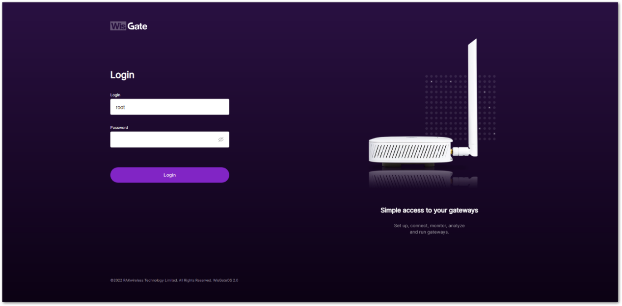

  1. Log in to the gateway's Web UI.
WisGate web UI login page
Figure 10: WisGate web UI login page

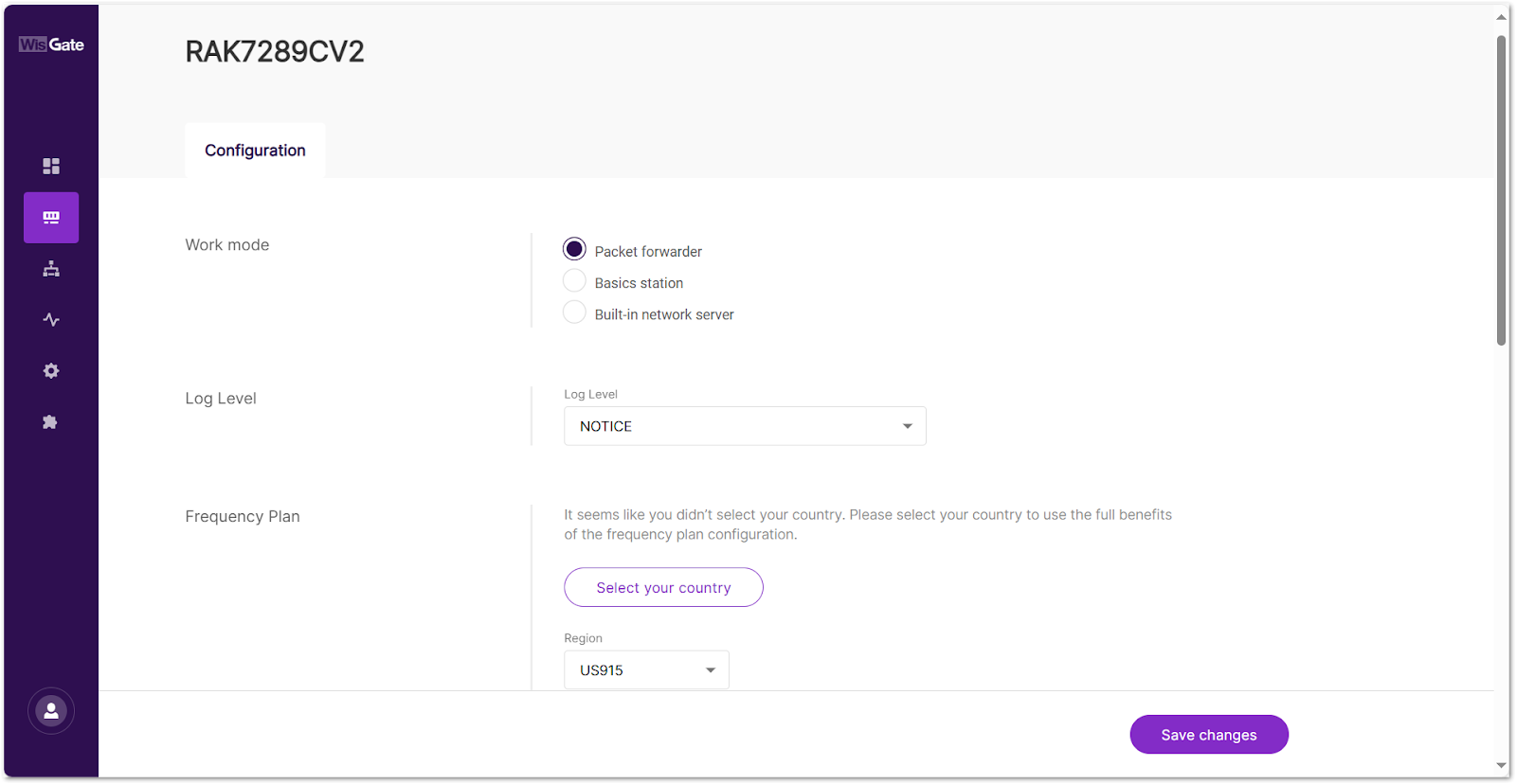

  1. Go to LoRa > Configuration, and set Work Mode to Packet forwarder.
Select Packet forwarder in the Work Mode field
Figure 11: Select Packet forwarder in the Work Mode field
NOTE
Ensure that the configured frequency band matches the frequency plan selected in the LORIOT Console.

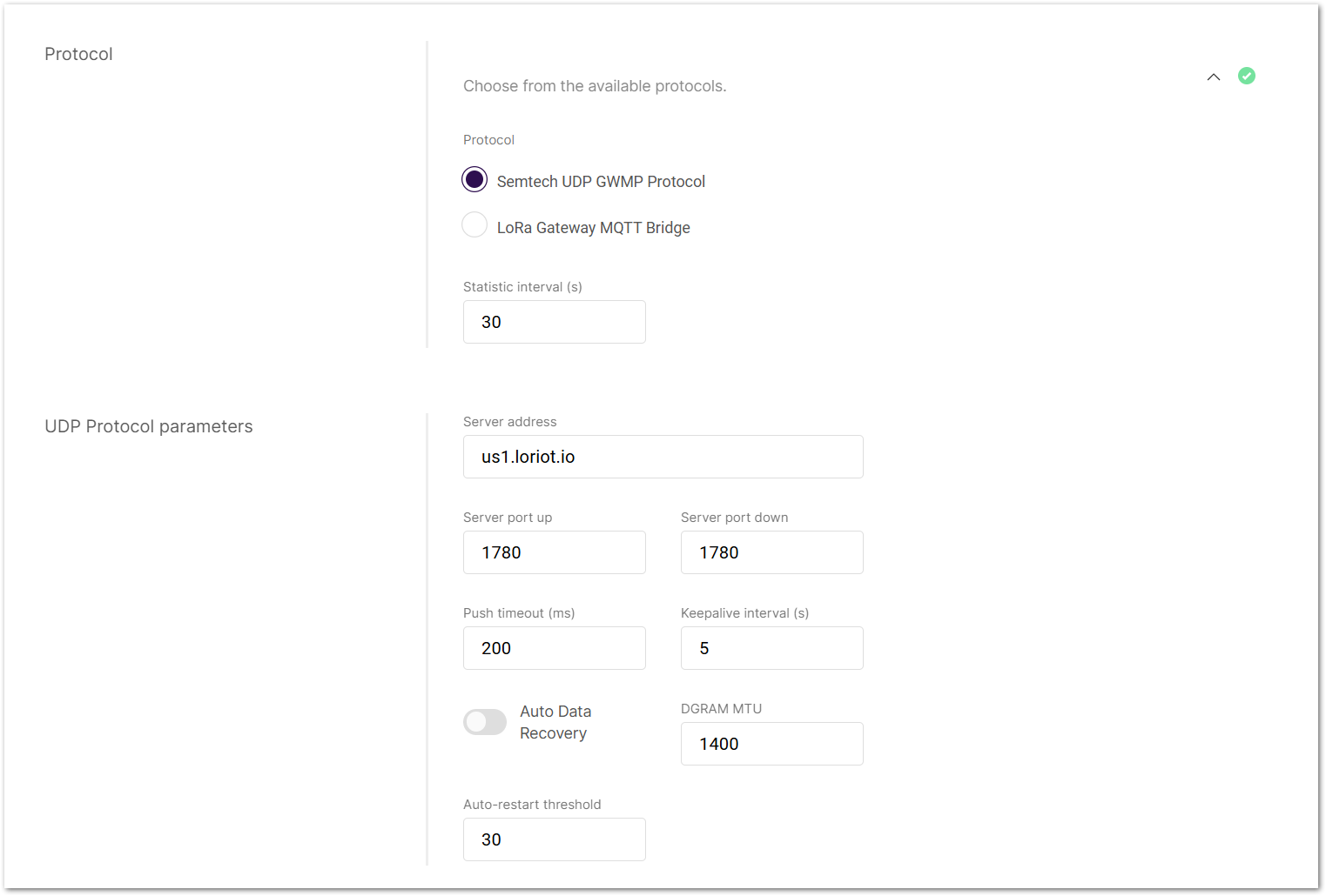

  1. In the Protocol field, select Semtech UDP GWMP Protocol from the dropdown.
Select Semtech UDP GWMP as the protocol
Figure 12: Select Semtech UDP GWMP as the protocol
  • Server address: e.g., us1.loriot.io
  • Server port (up/down): 1780
  1. Click Save changes to apply the configuration.

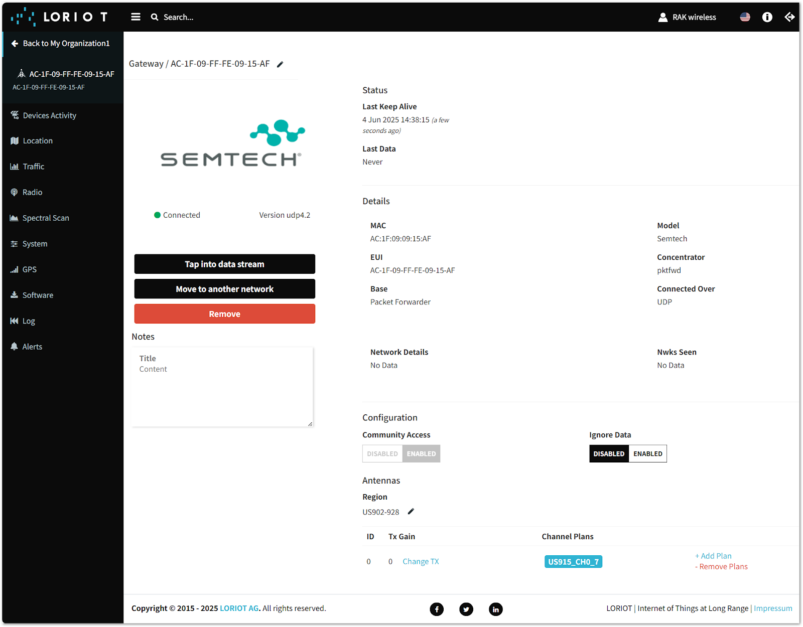

Verify the Gateway Status
After the gateway configuration, go back to the LORIOT Console. The gateway status will show Connected if it is online and sending packets.
Gateway connected status
Figure 13: Gateway connected status
