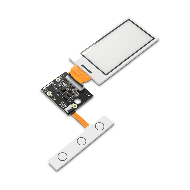

To display the data, you must use the WisBlock RAK14000 E-Ink (E-Paper) Module. This display module is very low-power, making it ideal for IoT projects that are battery-powered or for projects that are running continuously for 24 hours. The RAK14000 also has three push-button membrane switches that can be used to toggle through the specific cryptocurrency you want to see the current value of.

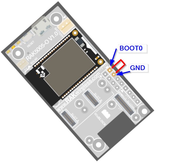

| 📝 NOTE: Before doing any firmware upload with the RAK11200, make sure to press the reset button first while the BOOT0 pin is shorted. If you don't do this, your upload will fail. |
For more details, you can refer to the RAK11200 quick start guide.

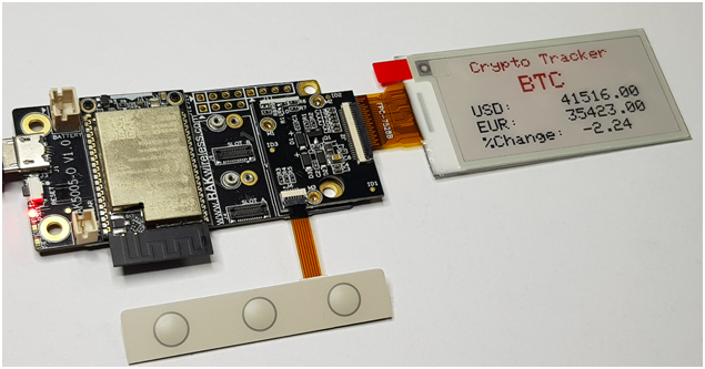

If you uploaded the Cryptocurrency Tracker sketch successfully, you should see WisBlock Crypto Tracker at the start (some kind of splash screen).
Then, in less than a minute, it will show BTC as the default coin selected.

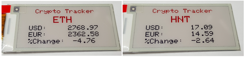

The three buttons represent BTC, ETH, and HNT, respectively. You can select which coin you want to see by pressing the button. Every minute, the selected coin's value will be updated, and you can adjust the update interval to your liking.
