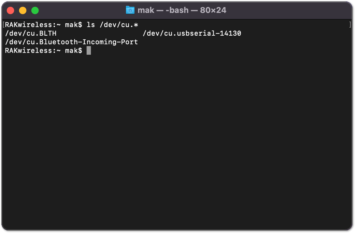

List the connected devices ls /dev/cu.*
If there are no other USB serial devices connected the one starting with cu.usbserial* will be the gateway.

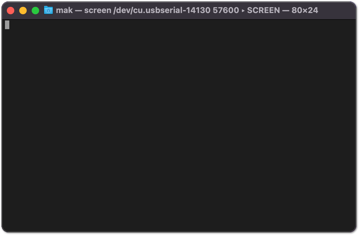

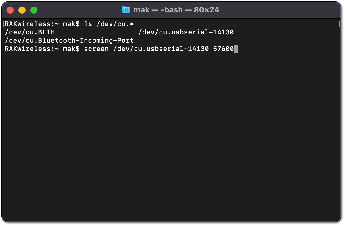

To establish a connection, type in screen /dev/cu.usbserial-XXXXX 57600 (Change the XXXXX with your specific USB serial port number.)
The terminal will clear.
Power on the gateway.

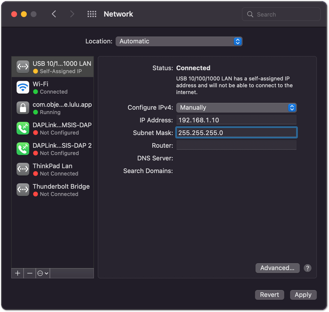

LAN Card Configuration
To be able to send the firmware to the gateway, you need to set the LAN card to a static address.

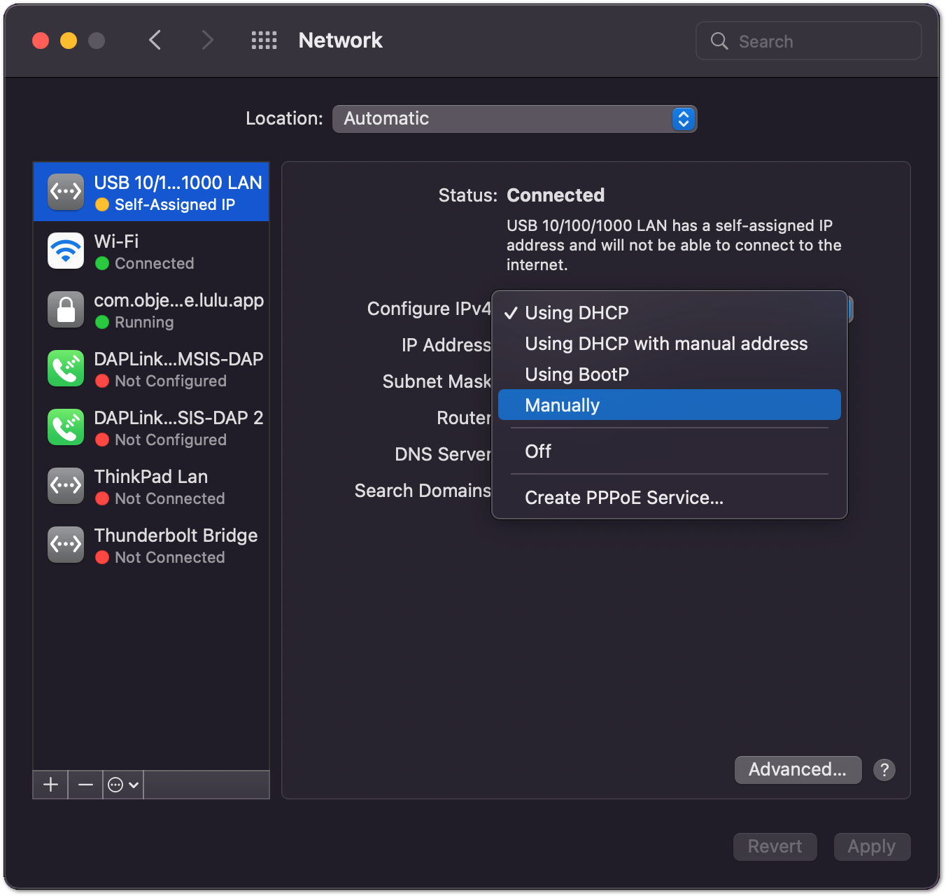

Go to the Network Preferences of your MAC OS and select the LAN card settings. In this example, it is a USB LAN card.
Change the Configure IPv4 option to Manually.

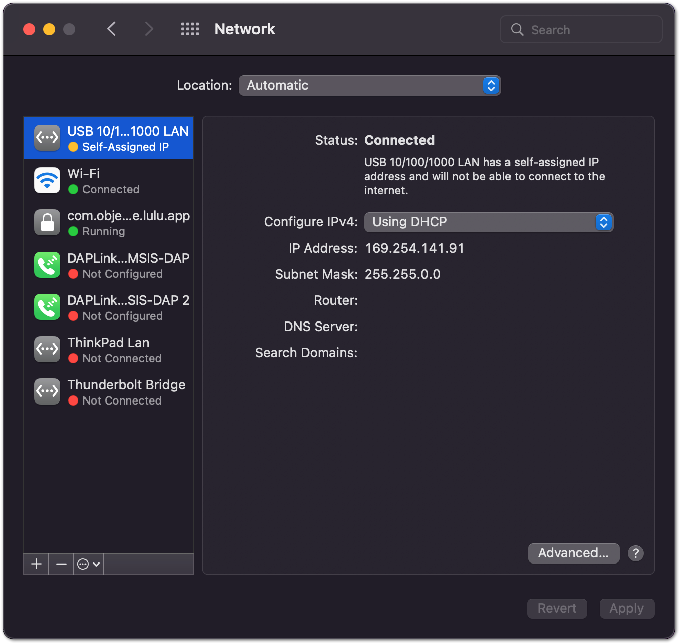

Change the IP Address to 192.168.1.10 and the Subnet Mask to 255.255.255.0.
Apply the changes by pressing the Apply button.

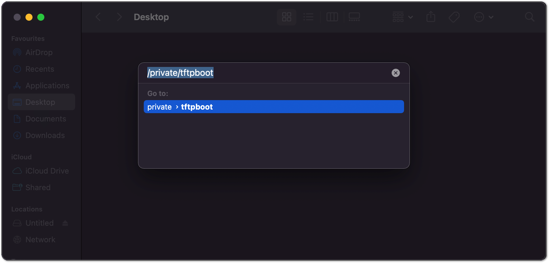

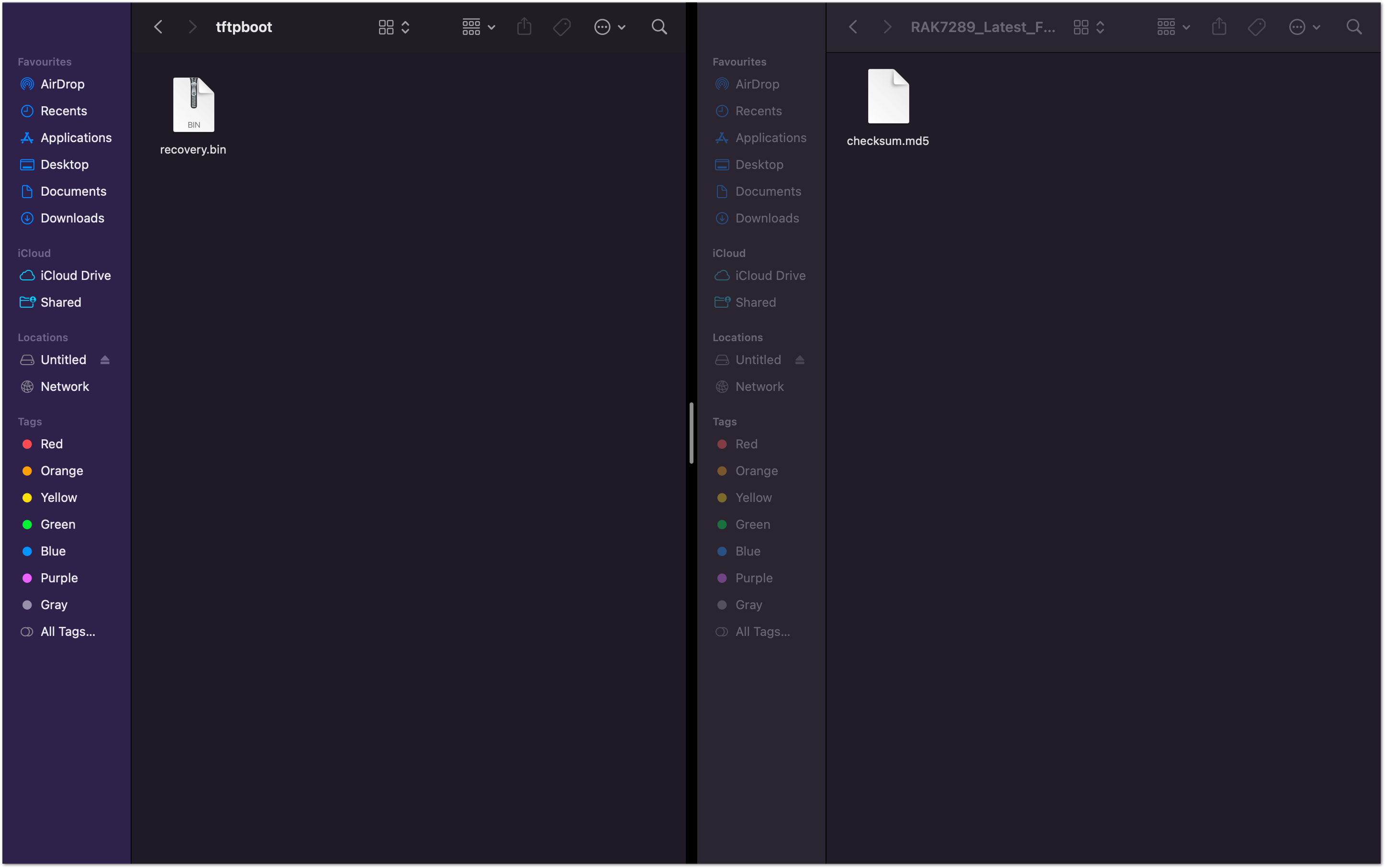

You can use the built-in TFTP server in the MAC OS X. Usually, the server uses the /private/tftpboot folder. Have in mind that by default, the folder is hidden in the finder. To access it, open the finder. Use Cmd+Shift+G and enter /private/ftpboot.
Copy the recovery.bin file from earlier into the tftpboot folder.

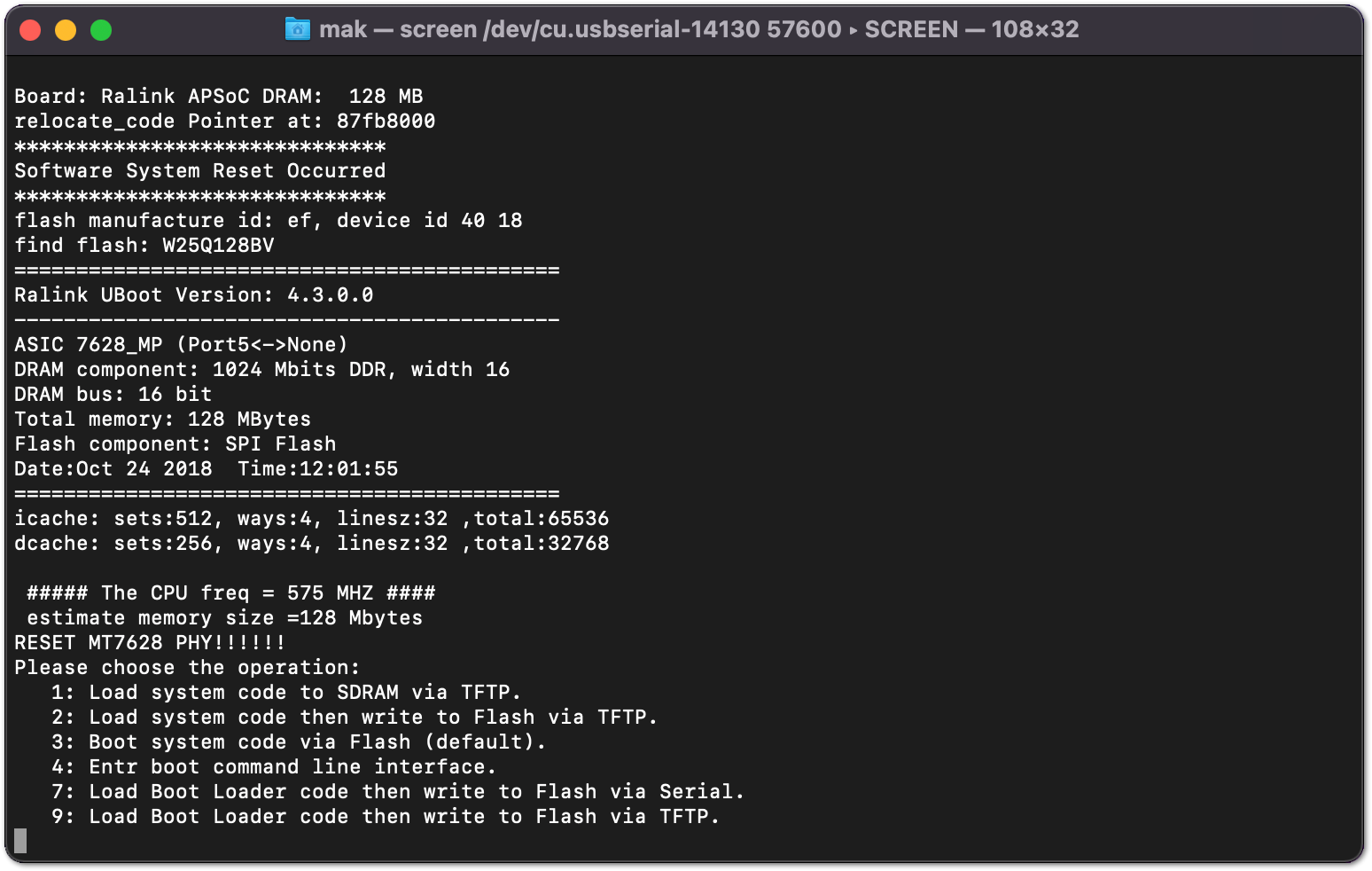

Go back to the terminal you used to configure the communication.

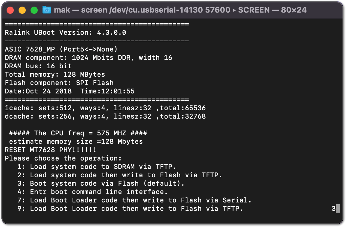

Restart the gateway with the reset button.

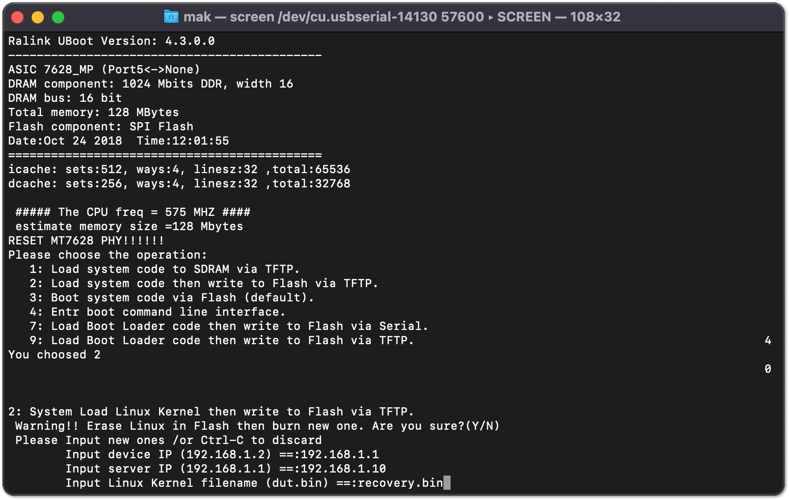

A dialog will appear in the terminal, press 2 on the keyboard to select the Load system code then write to Flash via TFTP option.
For the next dialog enter the answers below:
- Are you sure? (Y/N) – press Y;
- Input device IP - type 192.168.1.1, then press Enter;
- Input server IP - type 192.168.1.10, then press Enter;
- Input Linux Kernel filename - type recovery.bin, then press Enter.

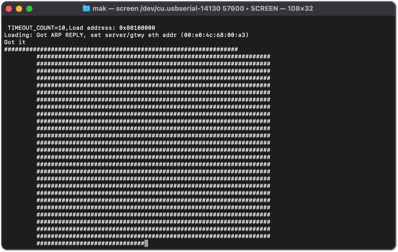

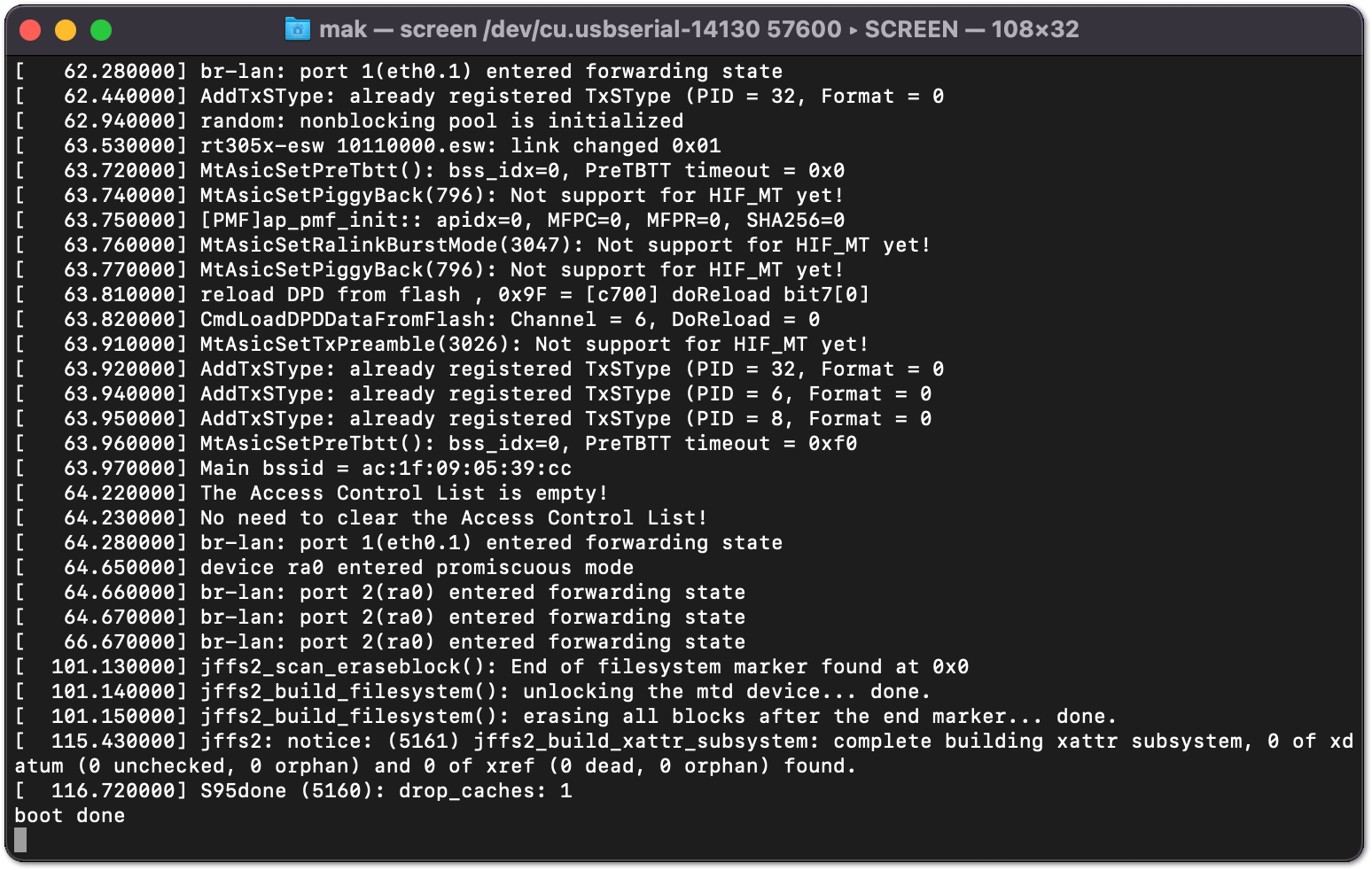

If everything is ok you should see the firmware transfer and flash. It takes some time to download, flash, and boot. Do not power off or disconnect anything.
When the console output prints Boot done, you are good to go. You should be able to see the Wi-Fi AP and connect to your gateway as usual.
