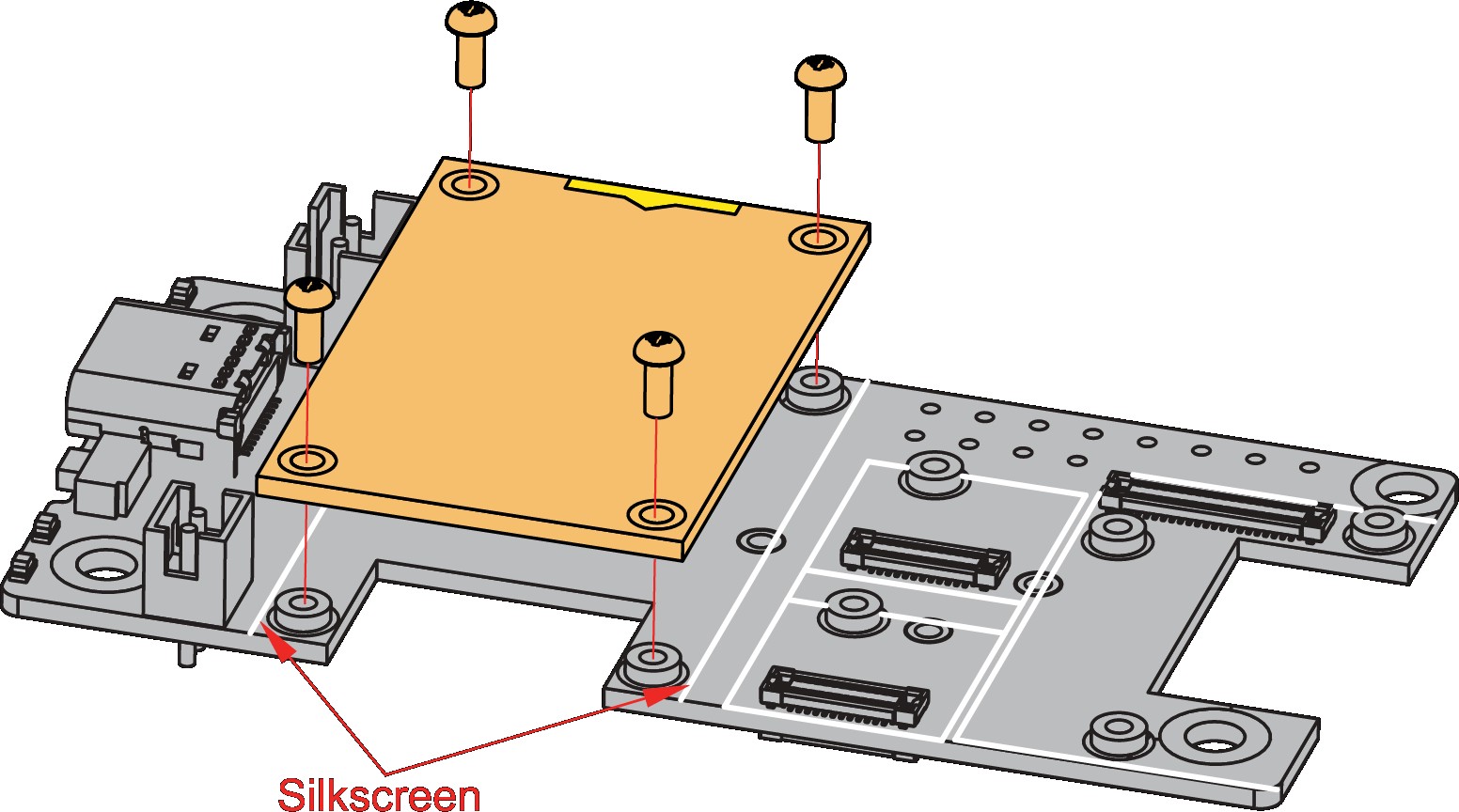

WisBlock Assembly
To put together the different modules, you need to connect them to the respective slots in the base board. For further information, refer to the Assembling and Disassembling section in the Quick Start Guide.

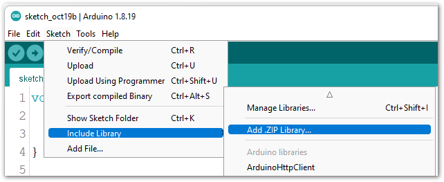

To open the code, first, you need to install the RAKwireless Audio Library from our repository.
Download it, and search for the ZIP file by navigating to Sketch > Include Library > Add .ZIP Library…

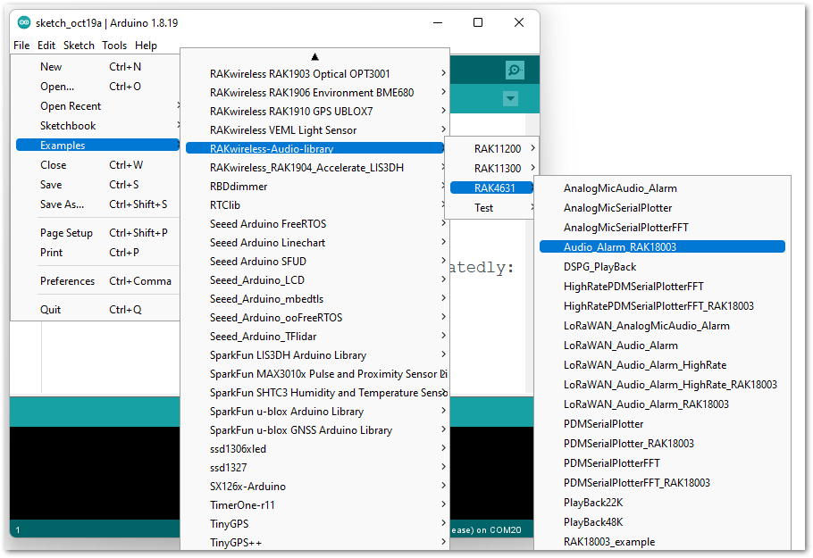

On the Arduino IDE, navigate to File > Examples > RAKwireless Audio Library > RAK4631 > Audio_Alarm_RAK18003.

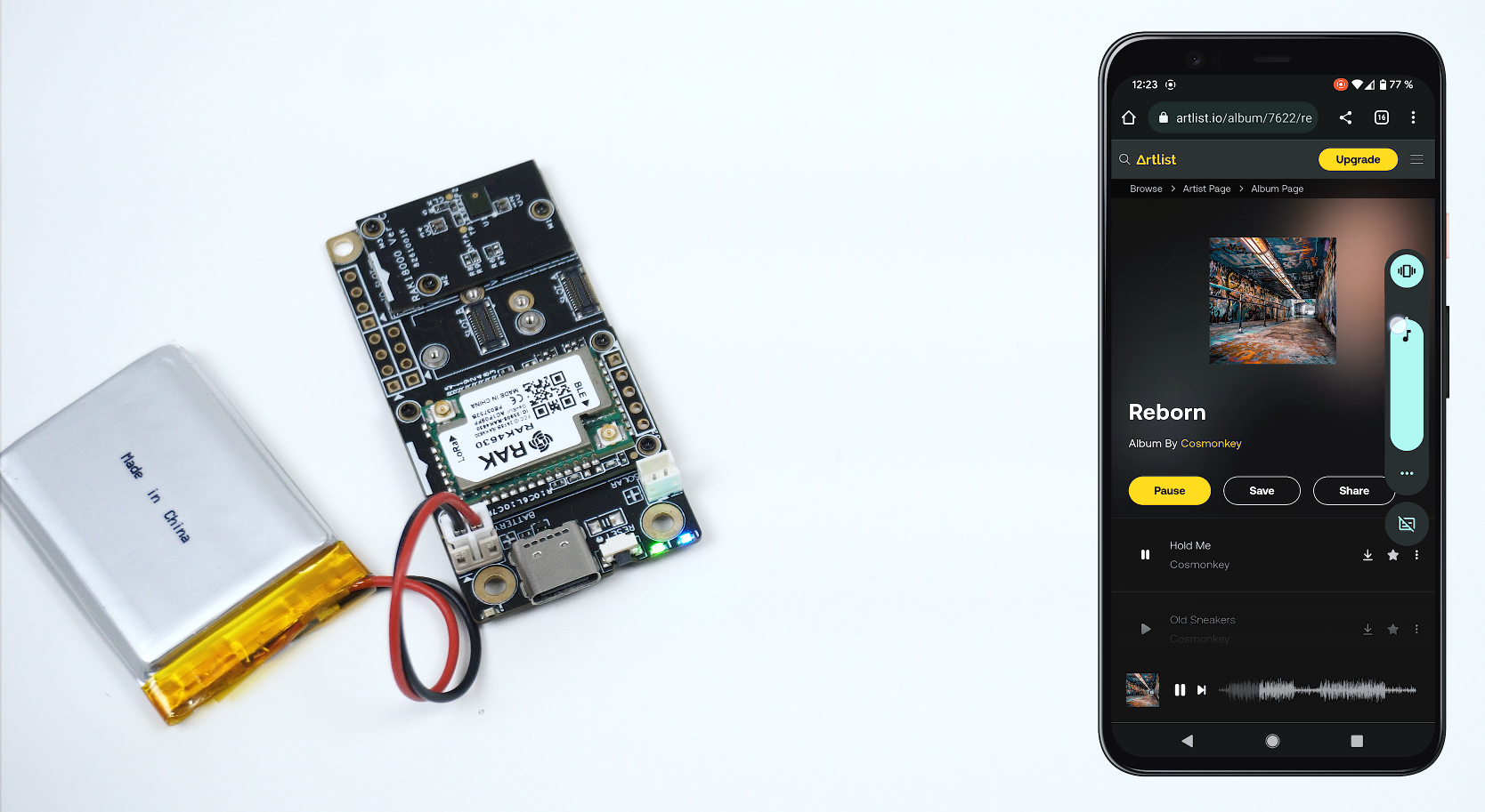

Testing
Once the code is uploaded, you can play some music or start talking and see how your board hears you and activates its LEDs when you reach a certain level of loudness meanwhile.
Instead of just controlling LEDs, you can modify the code to send an email notification or to drive a screen to show a dB live measurement.
