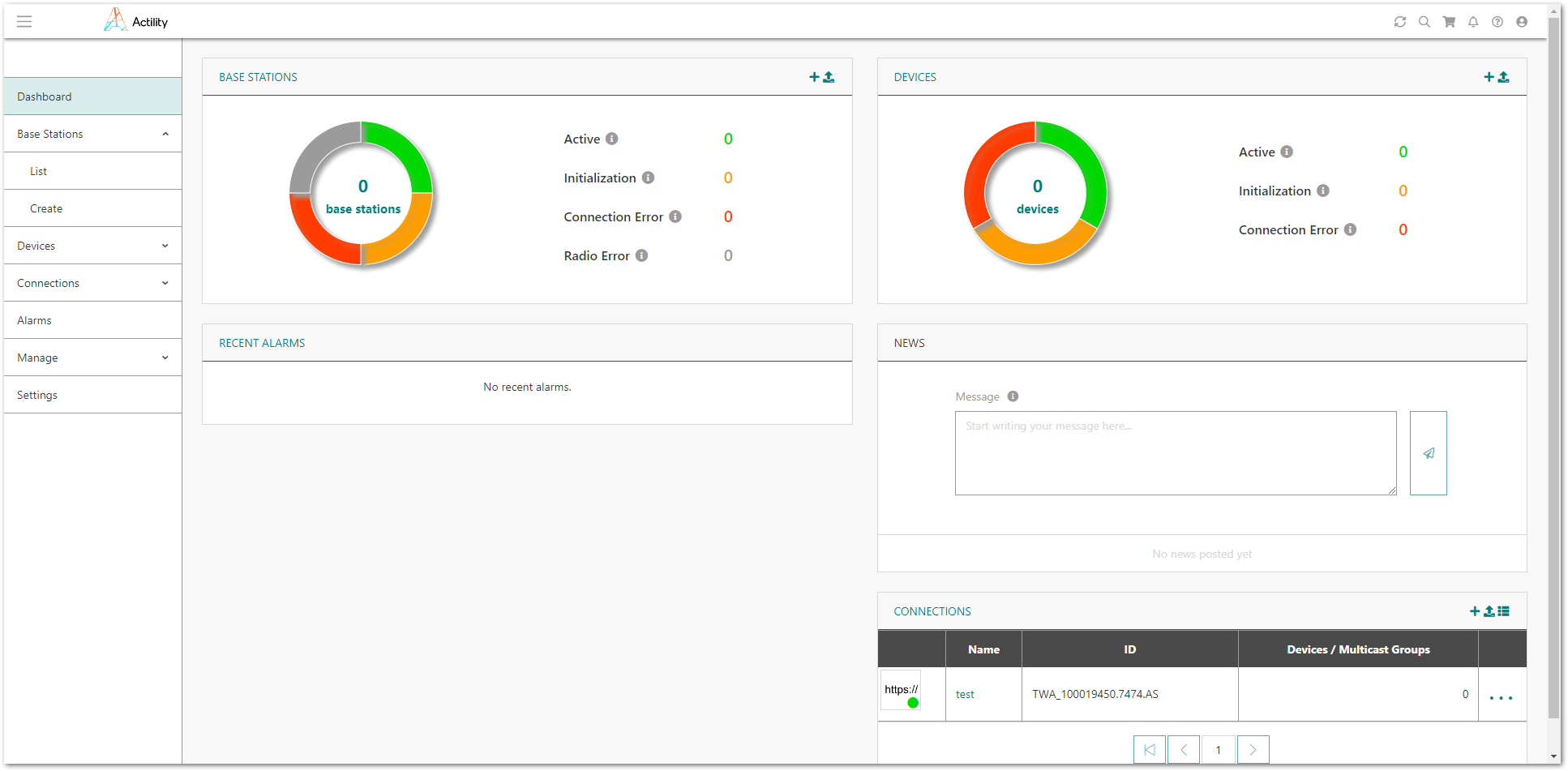

Log in to the ThingPark Admin console. If you do not have an account, you need to create one.
On the Admin console, navigate to the Base Stations drop-down menu and choose Create.

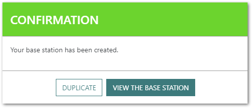

Once everything is set, click Create to register the gateway in ThingPark.

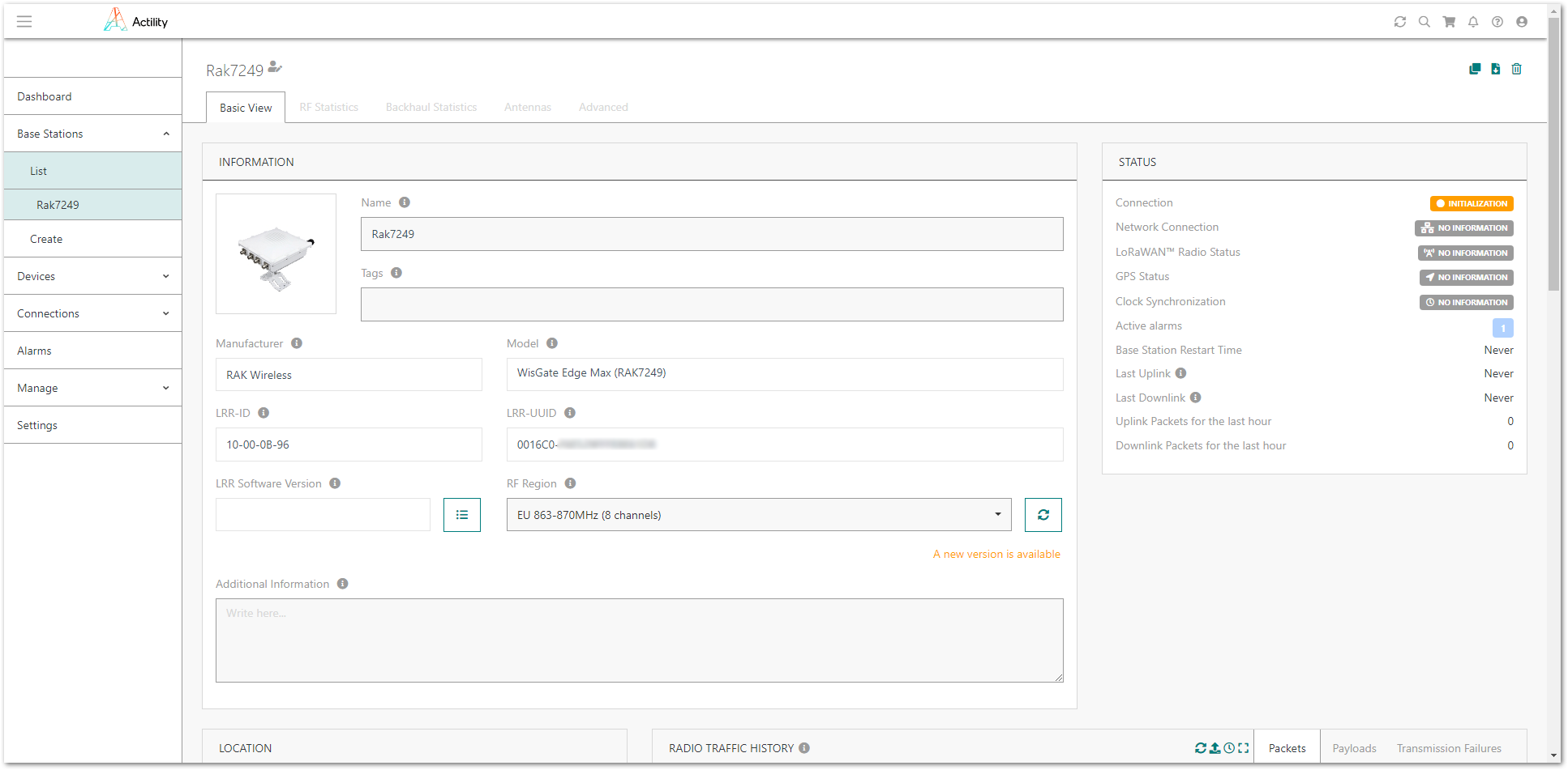

A confirmation window will pop up. Click VIEW THE BASE STATION.
You will be redirected to the Dashboard of the registered gateway.

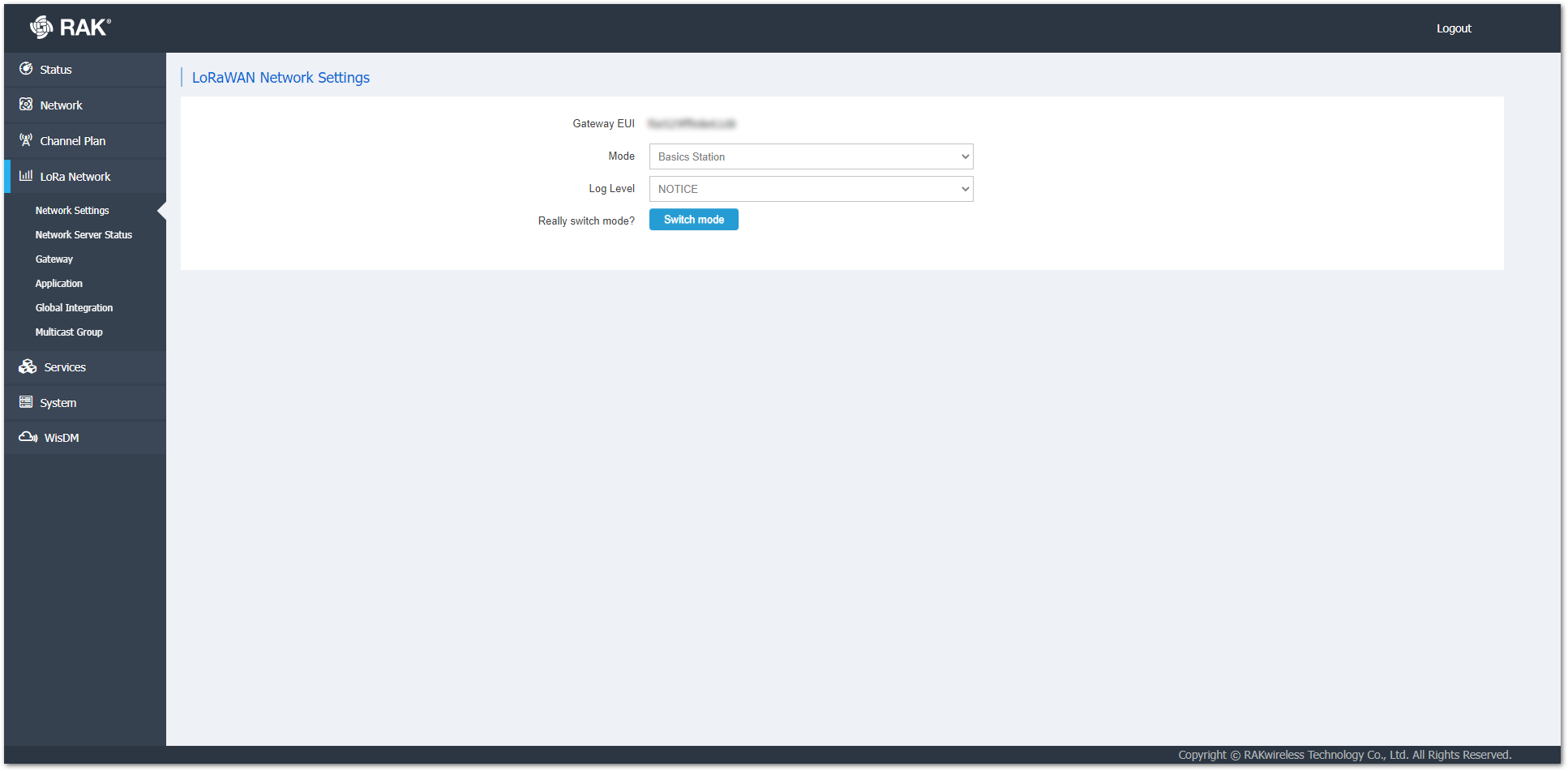

Navigate to LoRa®. By default, the gateway works in built-in network server mode.
From the Mode drop-down menu, choose Basics Station and click Switch mode to change the mode.

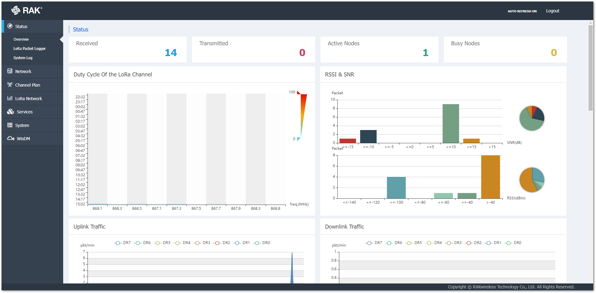

If everything is set up correctly, you can see that the gateway is connected to ThingPark in the STATUS area in ThingPark.
