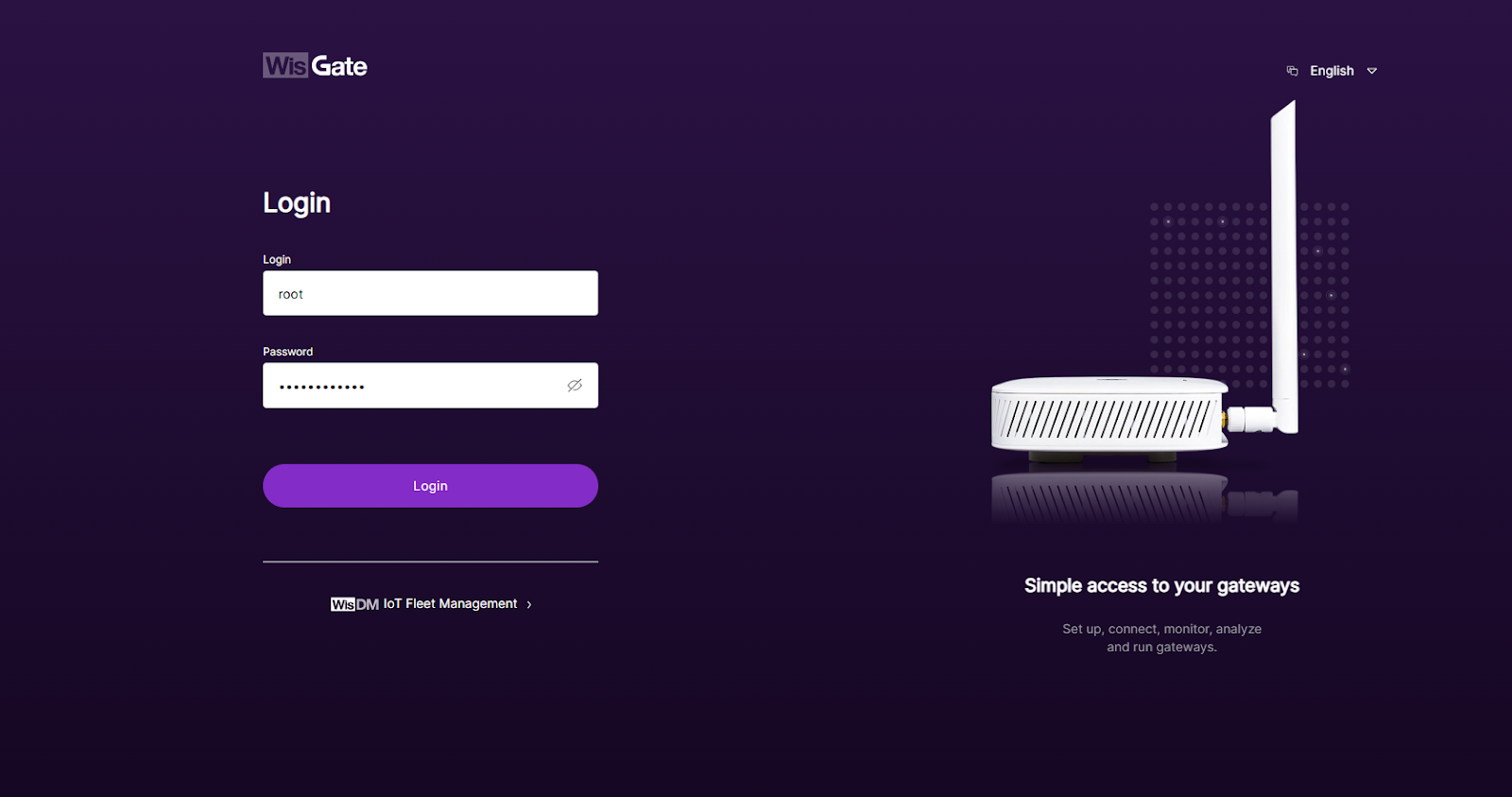

  1. Log in to the gateway’s web UI.
Log in to the WisGate web UI

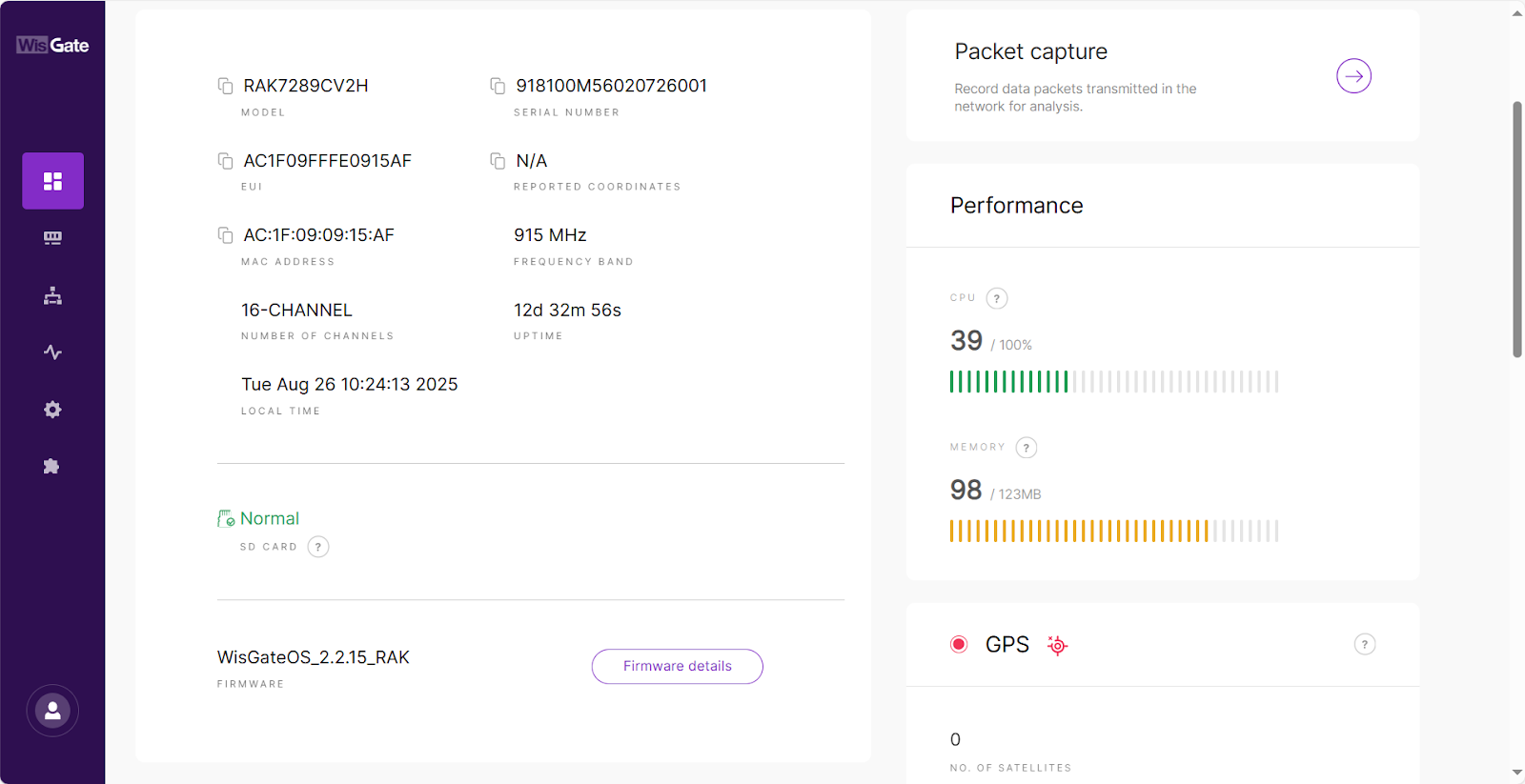

  1. Go to Dashboard > Overview > SD CARD.
SD Card status
Status Definition
Normal
Status Normal SD Card Status
Description SD card is detected and functioning properly.
What to do No action required.
