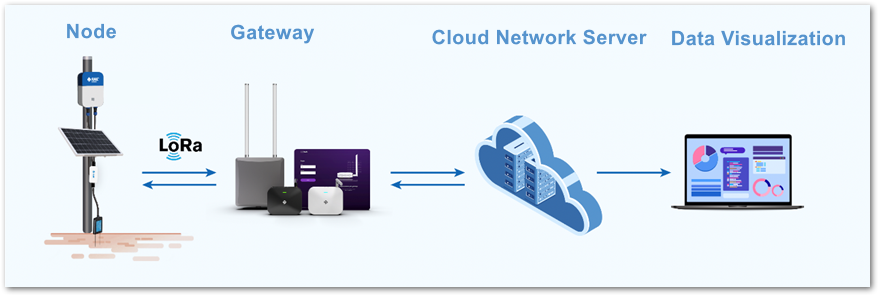

What Affects Cellular Data Usage in RAK Gateway?
Figure 1: Typical IoT Architecture
The primary consumer of cellular data on a LoRaWAN gateway is LoRaWAN Network Server (LNS) communication. The gateway continuously forwards messages between IoT devices and the LNS, ensuring a smooth data flow between sensors and applications. While this process keeps the network operational, cellular data usage depends on several factors:
