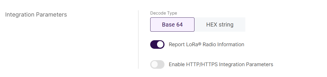

  1. Go to the gateway web UI and navigate to:
    LoRa® > Applications > [Your Application] > Configuration > Integration Parameters.
Go to Integration Parameters
  1. Toggle the switch Enable HTTP/HTTPS Integration to turn on the feature.

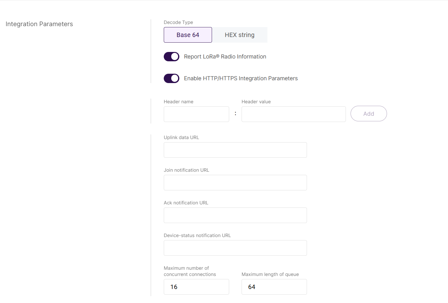

  1. Provide the destination URL(s) for each type of event:
    • Uplink Data URL
    • Join Notification URL
    • ACK Notification URL
    • Device-Status Notification URL
  2. Configure optional settings.
    • Decode Type: Choose either Base64 (default) or HEX
    • Report LoRa® Radio Information: Enable this option if you wish to include RSSI, SNR, and frequency
    • Headers name/Header value: Add key-value headers for API authentication
    • Maximum number of concurrent connections
    • Maximum length of queue
  3. Click Save changes to activate the integration.
