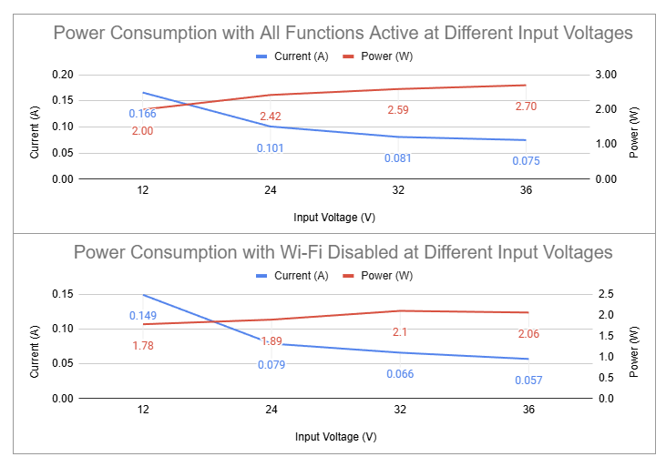

Here's the graphical representation:
Key Observations
- Power Draw: The power consumption slightly increased with higher input voltages, but the variation remained minimal across the tested range.
- Wi-Fi Impact: Disabling Wi-Fi consistently reduced power usage by up to 20%, offering significant energy savings in solar-powered LoRaWAN deployments .
