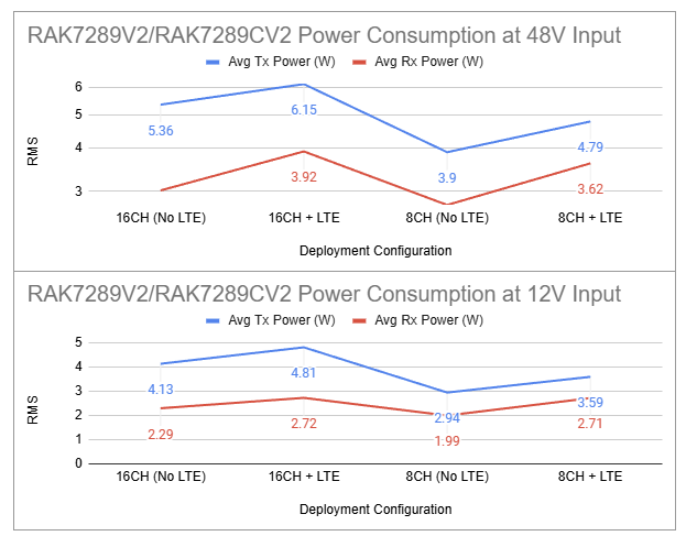

Here's the graphical representation:
Key Takeaways
✅ LTE increases power demand
Enabling LTE significantly increases overall current and power consumption, particularly in 16-channel configurations. If LTE isn’t required, turning it off provides a notable power saving.
✅ More LoRa channels = higher power draw
Operating in 16-channel mode offers greater capacity but costs more in power, both at 12 V and 48 V input.
✅ Optimal low-power mode
The most energy-efficient setup is 8 channels without LTE at 12V, consuming under 3 W RMS, ideal for solar or battery-powered deployments.
