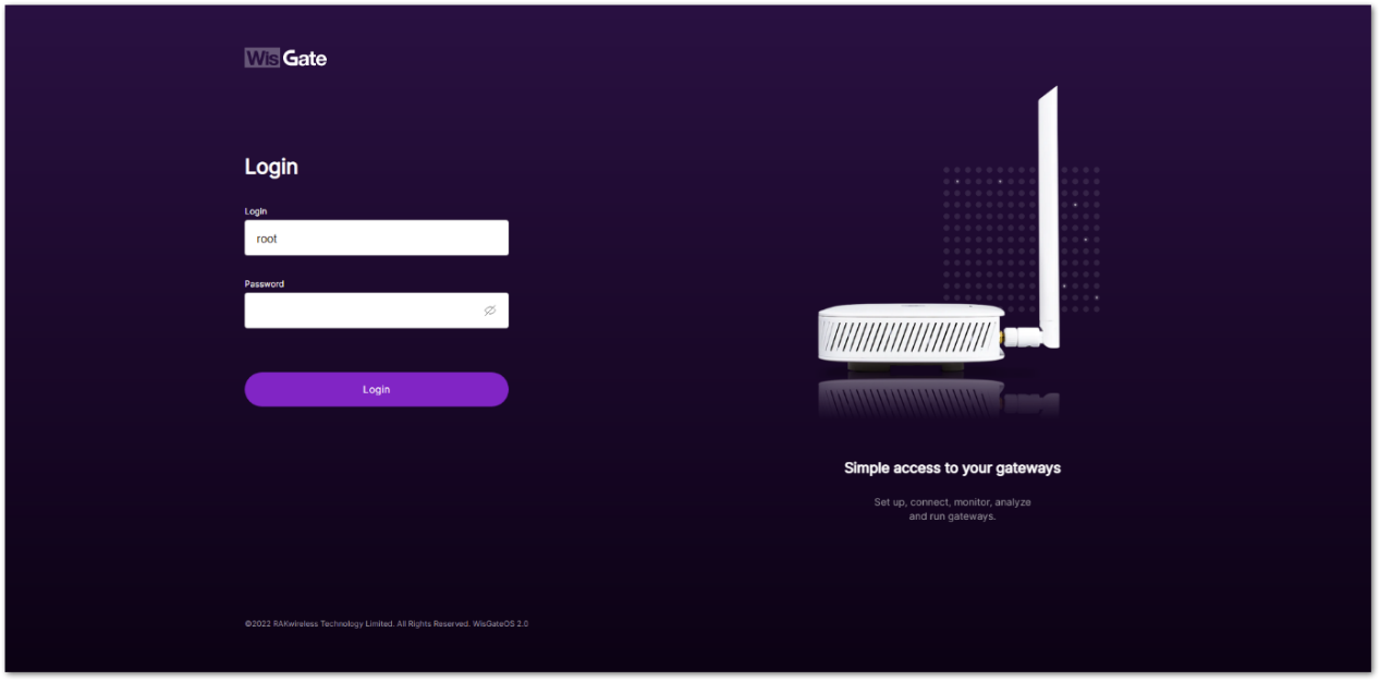

  1. Log in to the gateway's web UI.

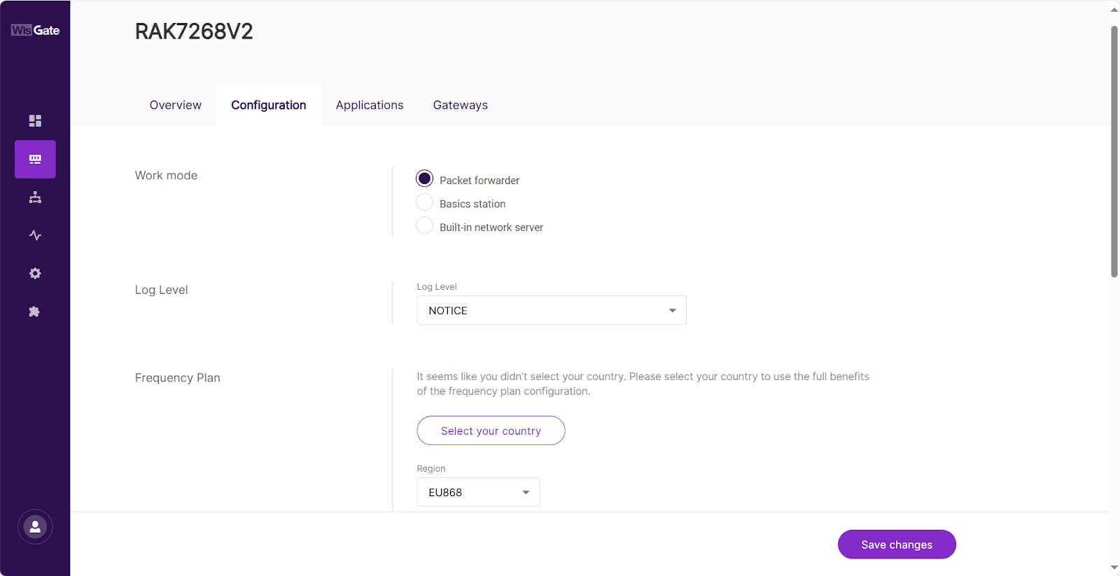

  1. Go to LoRa > Configuration, and set Work Mode to Packet forwarder.
Set Work Mode to Packet forwarder

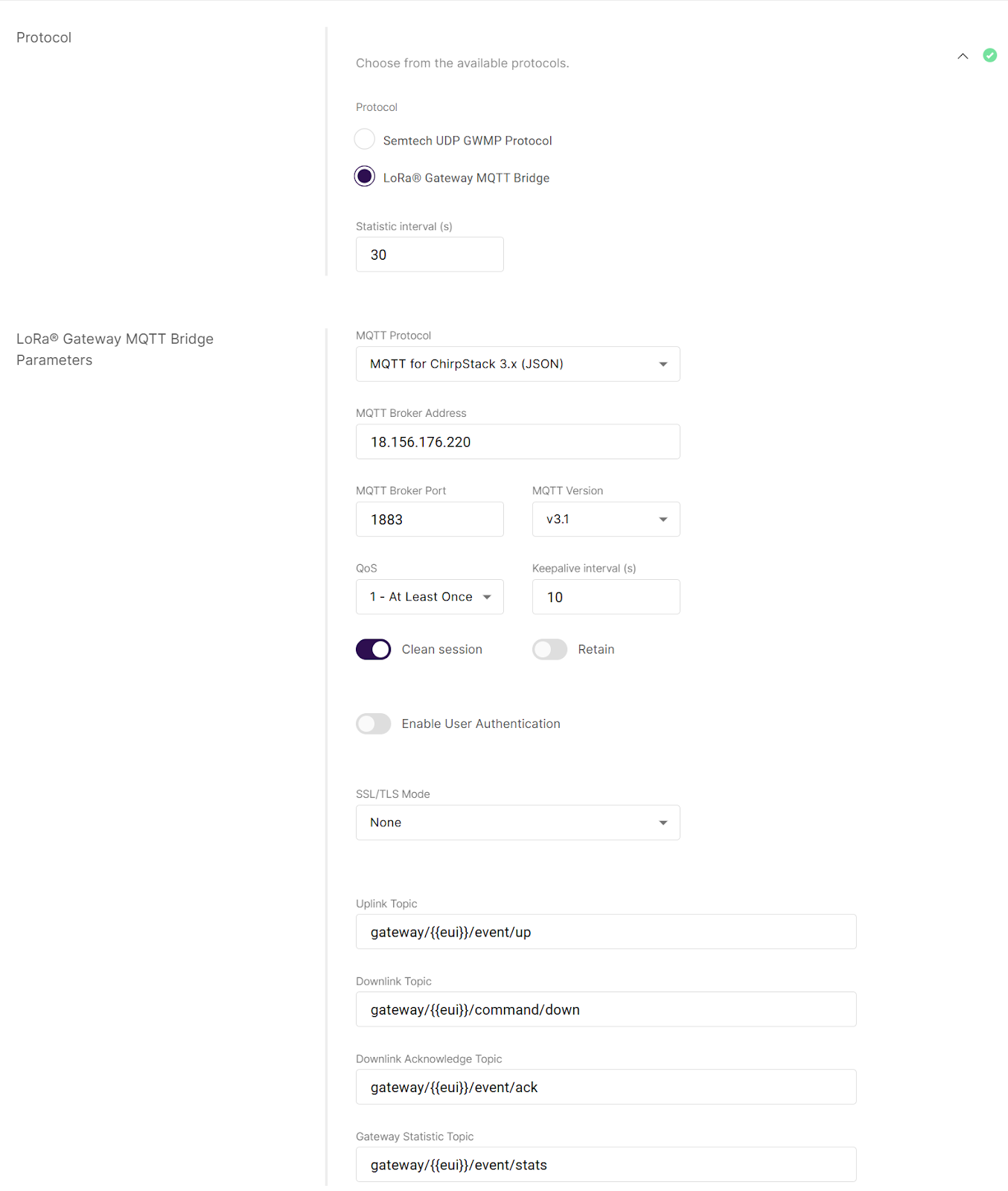

  1. In the Protocol field, click the dropdown. Then configure the following parameters.
Configure the Protocol paramenters
  • Protocol: Select LoRa® Gateway MQTT Bridge.
  • MQTT Protocol: Select MQTT ChirpStack 3.x (JSON).
  • MQTT Broker Address: Enter the public IP address of your ChirpStack server, for example: 18.156.176.220
  • MQTT Broker Port: 1883
  1. Click Save changes to apply the configuration.
