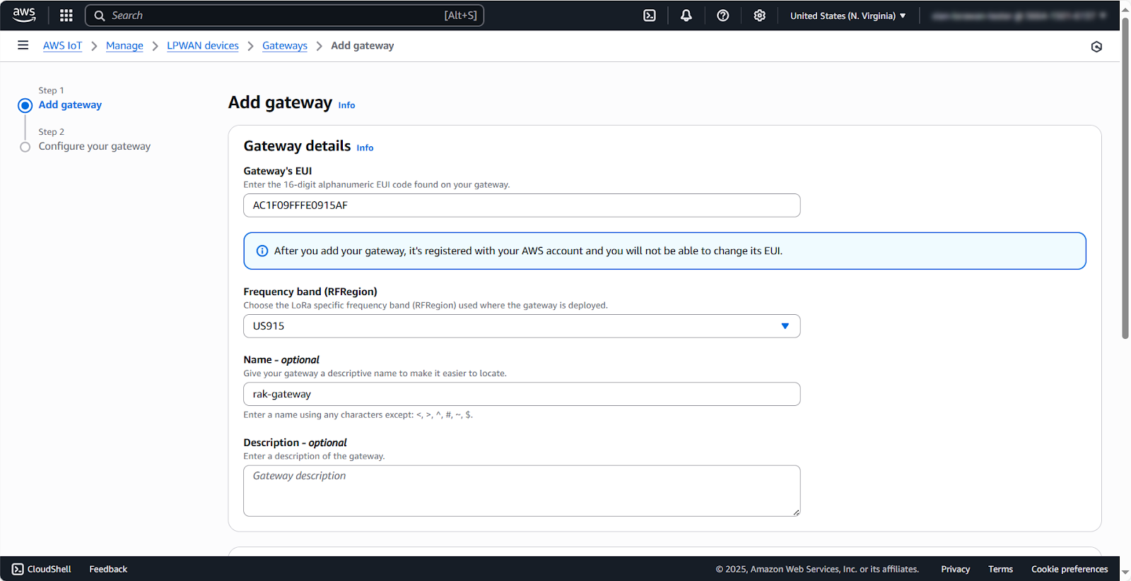

  1. In the Add gateway section, fill in the Gateway's EUI and Frequency band (RF Region) fields.
Fill in Gateway details

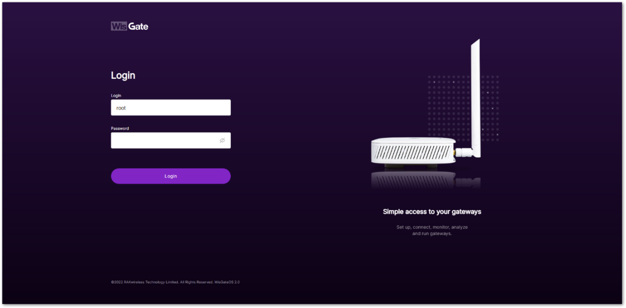

  1. Log in to the gateway's Web UI.

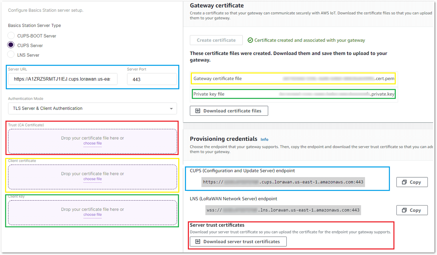

  1. Go to LoRa > Configuration, and set Work Mode to Basics station.
Changing the working mode
  1. Click Configure Basics Station server setup to expand the relevant settings panel. Configure the following parameters:
  1. Click Save changes.

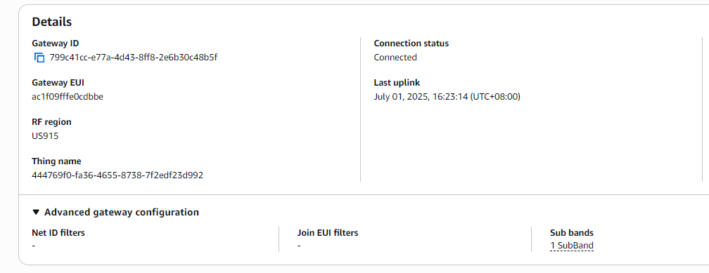

  2. Wait a few seconds and check AWS IoT Console to see if the gateway is online.
