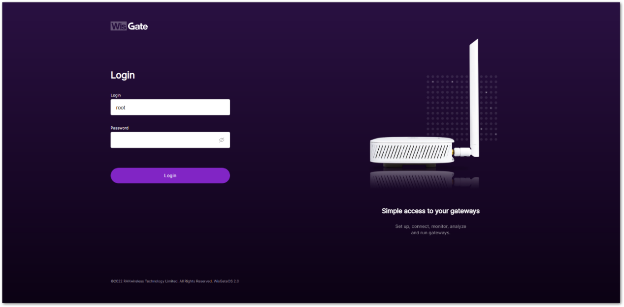

  1. Log in to the gateway's web user interface (UI).
Web UI Login for WisGateOS 2
Figure 1: Web UI Login for WisGateOS 2

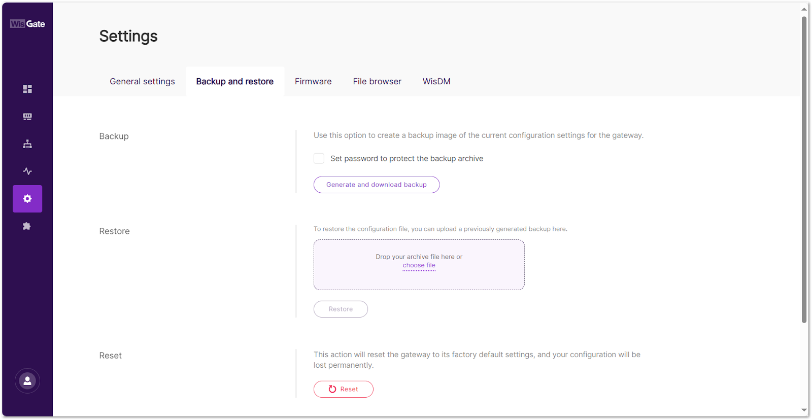

  1. Navigate to Settings > Backup and restore > Backup.
Backup and Restore Dashboard
Figure 2:  Backup and Restore Dashboard

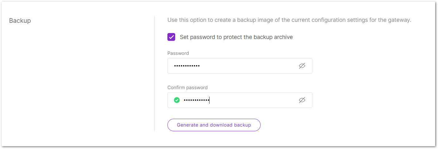

Encrypted Backup
  1. Check Set password to protect the backup archive.
  2. Enter and confirm the backup password.
  • Must be at least 12 characters long
  • Must include letters, numbers, and at least one special character (e.g., !@#$%^&*)
  1. Click Generate and download backup.
  2. Store the downloaded .tar.gz file safely.
Set Password and Download the Backup
Figure 3: Set Password and Download the Backup
Figure 4: Web UI Login for WisGateOS 2
  1. Navigate to Settings > Backup and restore > Restore.
Figure 5: Backup and Restore Dashboard

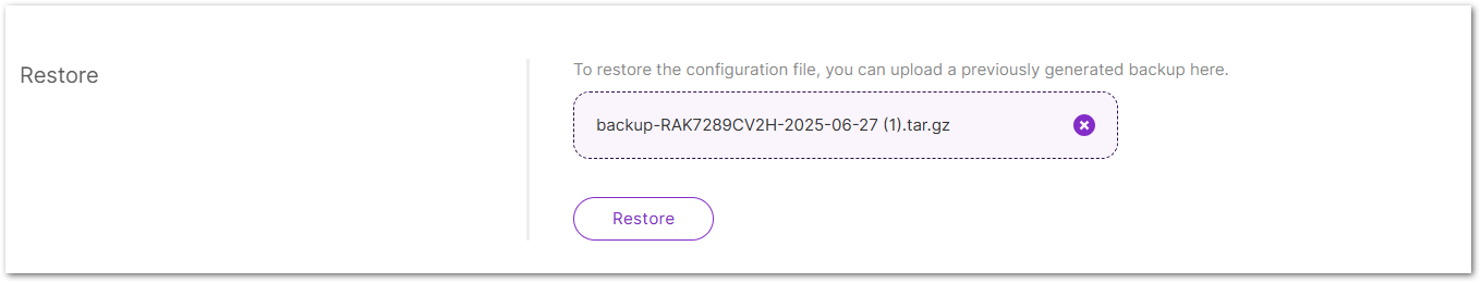

  1. Drag and drop your .tar.gz backup file into the upload area, or click choose file to select it manually.
Upload Encrypted Backup
Figure 6: Upload Encrypted Backup

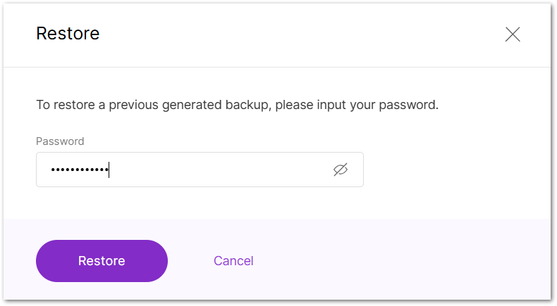

  1. After the file is loaded, click the Restore button.
  2. Enter the correct password when prompted.
Enter Password for Encrypted Backup
Figure 7: Enter Password for Encrypted Backup
  1. Click Restore again to continue.
Upload Unencrypted Backup
Figure 9: Upload Unencrypted Backup
