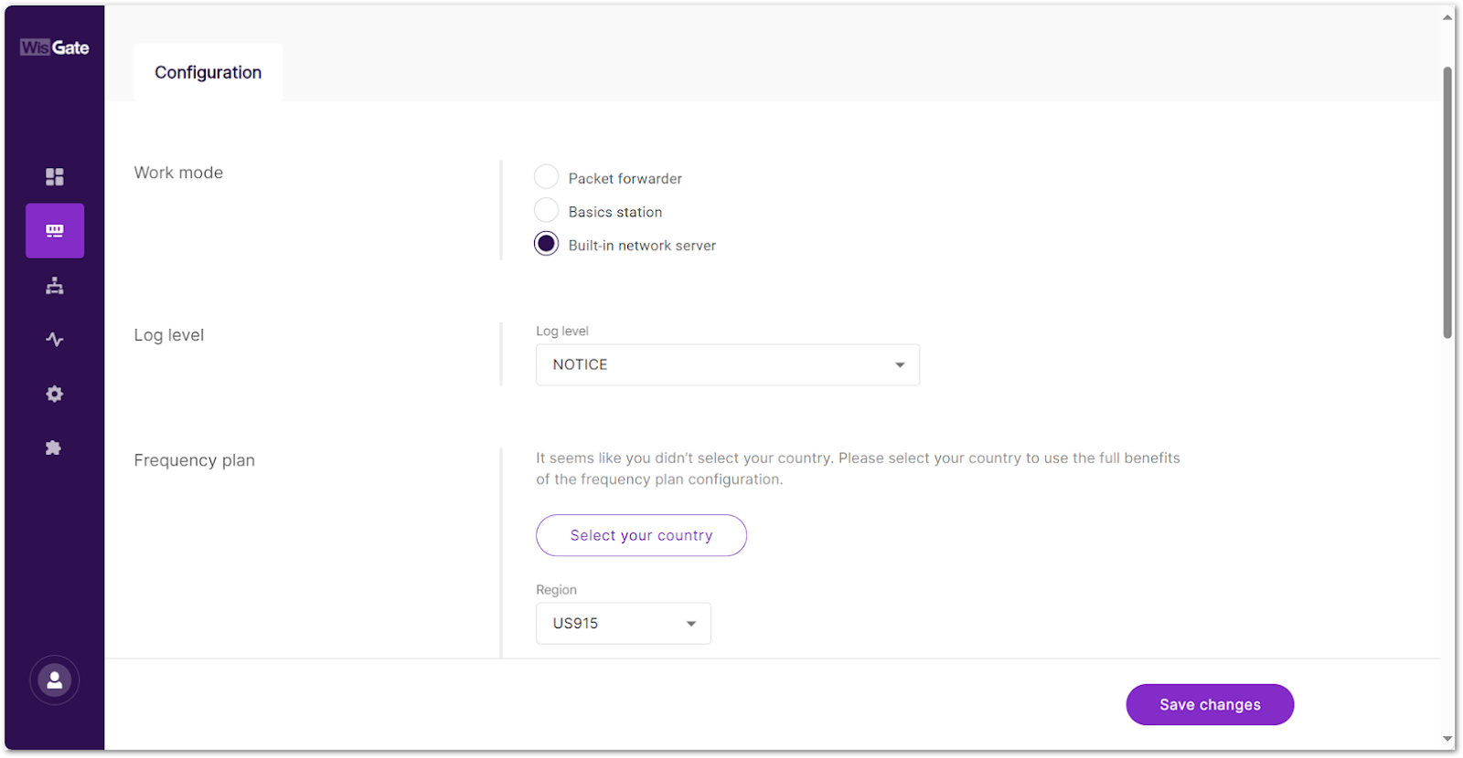

  1. Access the RAK gateway’s Web UI.
  2. Navigate to LoRa > Configuration > Frequency Plan.
Frequency Plan Settings on WisGateOS 2
Figure 1: Frequency Plan Settings on WisGateOS 2

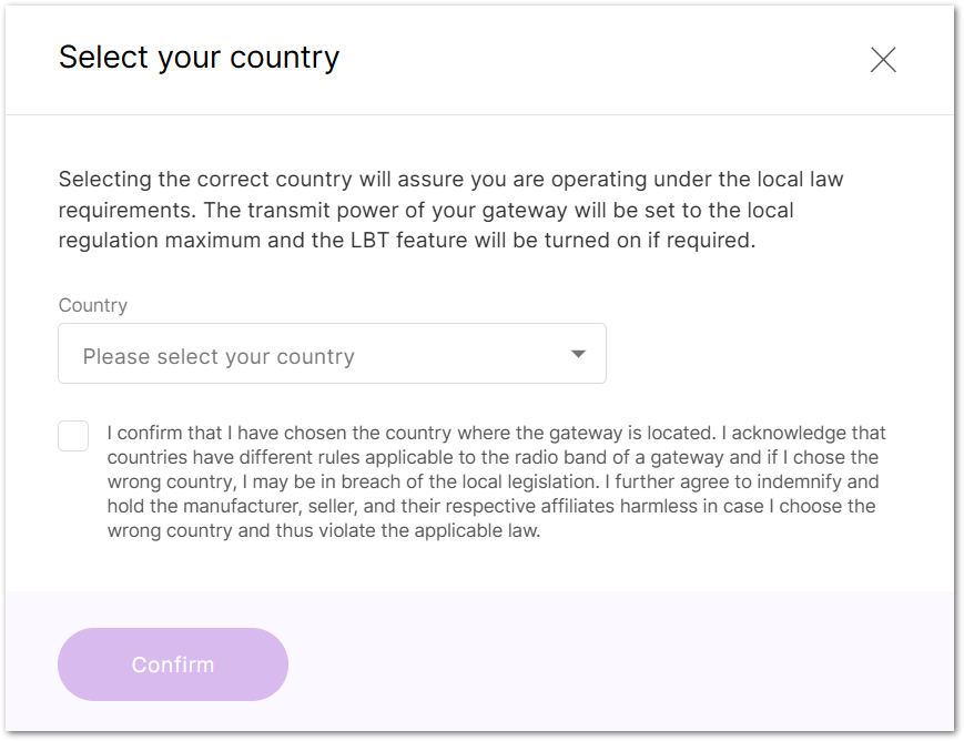

  1. Click Select your country.
  2. From the Country drop-down list, select the country where your gateway is deployed.
Select the Country Window on WisGateOS 2
Figure 2: Select the Country Window on WisGateOS 2

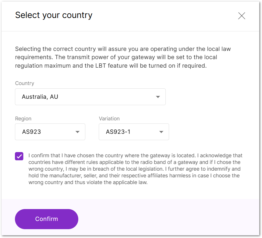

  1. Check the box to confirm that you are responsible for selecting the correct country.
Select country, Region and Variations on WisGateOS 2
Figure 4: Select country, Region and Variations on WisGateOS 2
  1. Click Confirm to apply the settings.

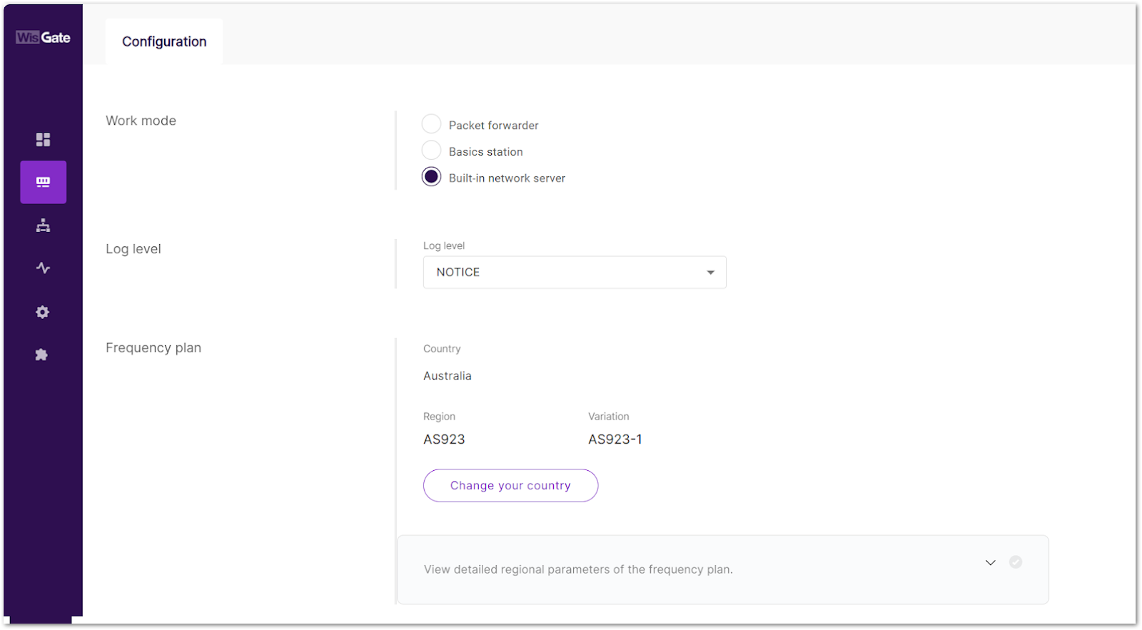

Frequency Plan Configured on WisGateOS 2
Figure 5: Frequency Plan Configured on WisGateOS 2
