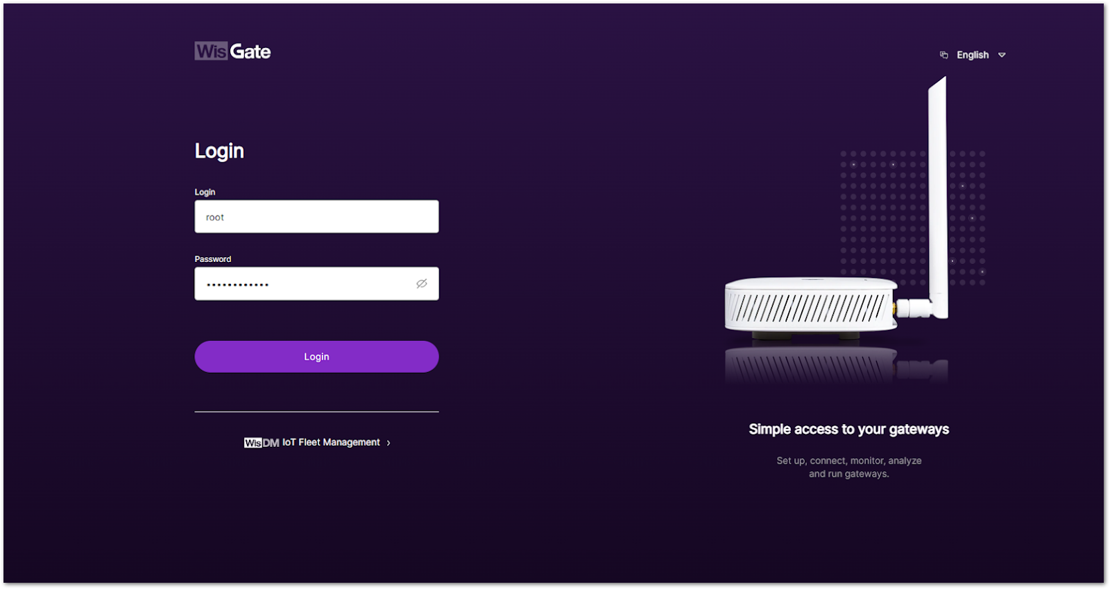

  1. Log in to the gateway's web interface.
Web UI Login for WisGateOS 2
Figure 1: Web UI Login for WisGateOS 2

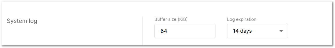

  1. Go to Settings > General Settings > System Log.
  2. Configure the following parameters:
System Log Parameter on WisGateOS 2
Figure 2: System Log Parameter on WisGateOS 2
  • Buffer Size (KiB): Enter the maximum in-memory log buffer size (e.g., 64)
  • Log Expiration: Select a retention period from the dropdown menu:
    • 14 days
    • 1 month
    • 3 months
    • 6 months
    • 12 months
  1. Click Save to apply the configuration.
