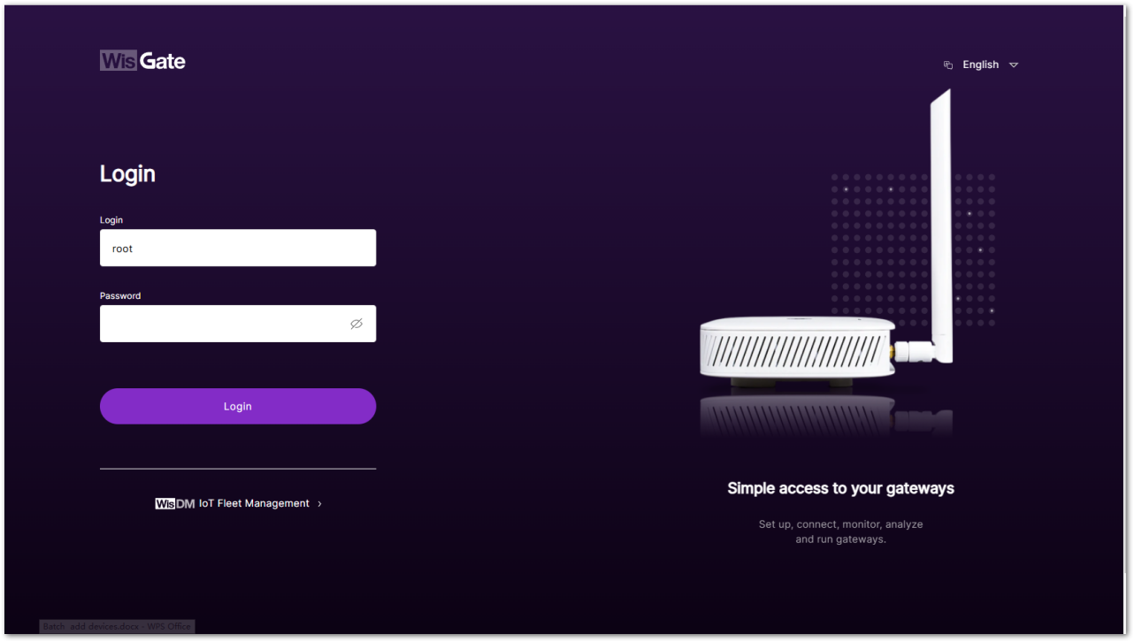

  1. Log in to the gateway's web UI.
Web UI Login for WisGateOS 2
Figure 1: Web UI Login for WisGateOS 2

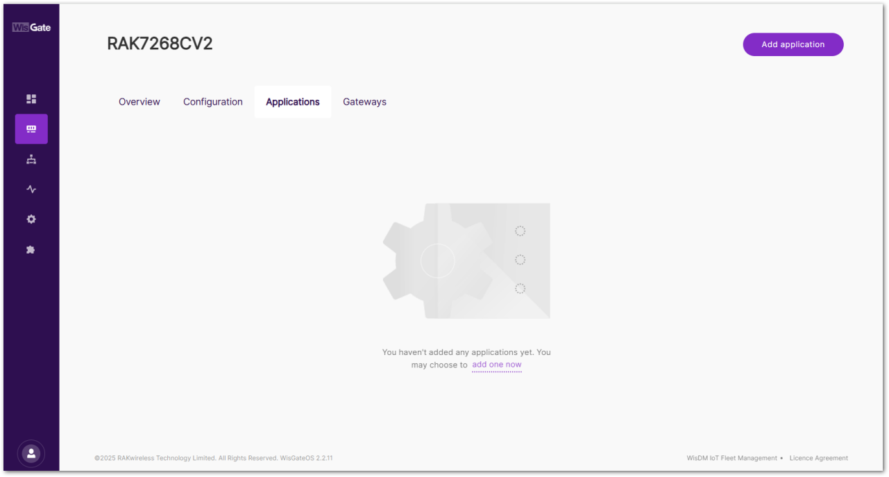

  1. Navigate to the LoRa > Applications tab.
  2. To add a new application, click Add application or add one now.
LoRa Applications tab on WisGateOS 2
Figure 2: LoRa Applications tab on WisGateOS 2

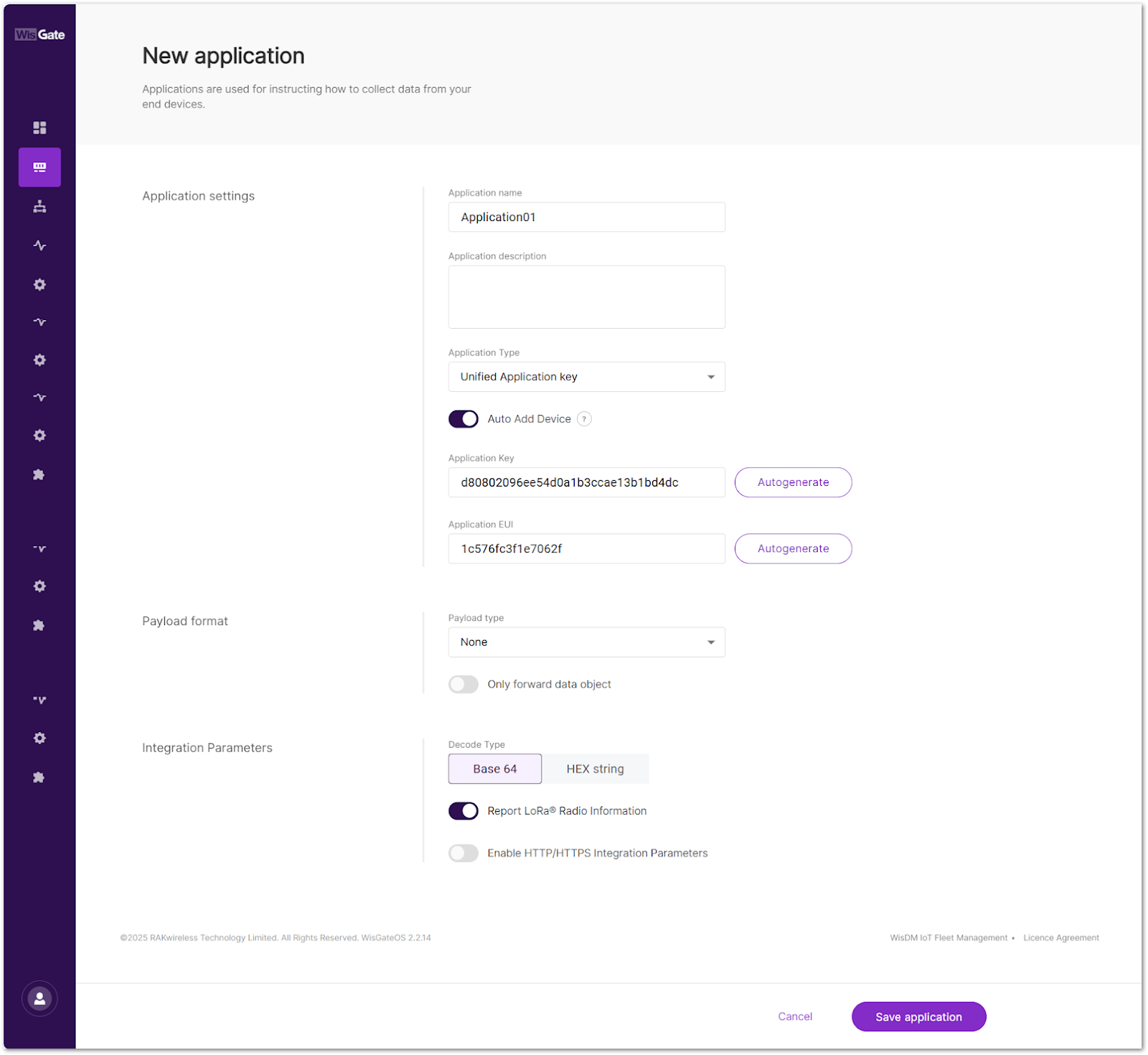

  1. Set the following parameters:
Application Parameters Fields on WIsGateOS 2
Figure 3: Application Parameters Fields on WIsGateOS 2
  • Application Name: A unique name for the application.
  • Application Description: (Optional) Additional information about the application.
  • Application Type: Select Unified Application Key. All devices under this application will share the same AppKey.
  • Auto Add Device: Enable this option. Devices with matching AppEUI and AppKey will be automatically registered upon joining.
  • Application Key: A 128-bit key used for device authentication (required when using Unified Application Key).
  • Application EUI: Must match the AppEUI configured on the end device. This is required when Auto Add Device is enabled.
Additional configuration options can be tailored to meet project needs.

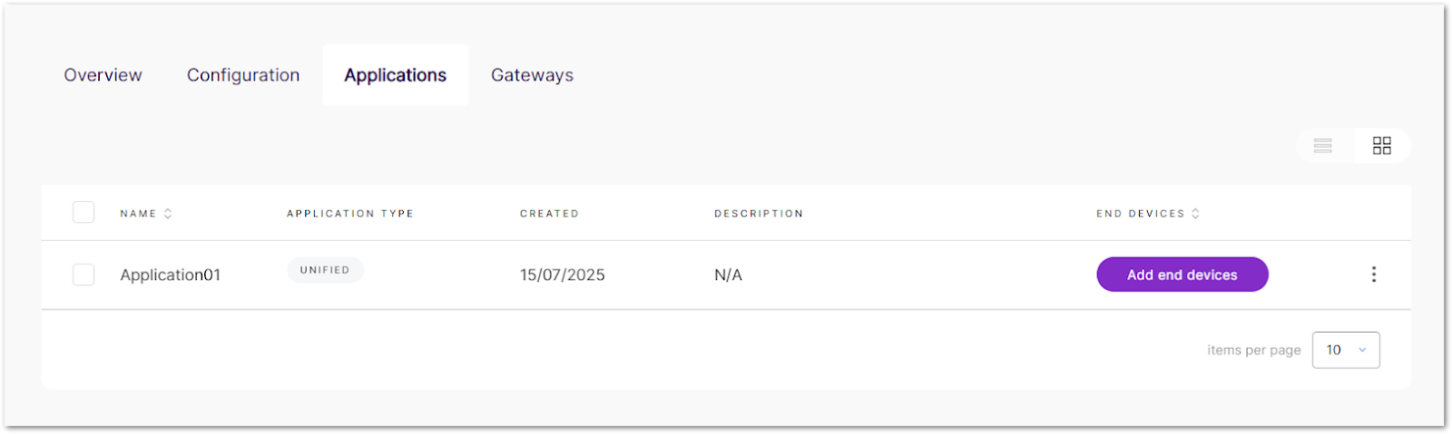

  1. Click Save application.
Application Successfully Added on WisGateOS 2
Figure 4: Application Successfully Added on WisGateOS 2

End Device Connected to the Created Application
Figure 5: End Device Connected to the Created Application
