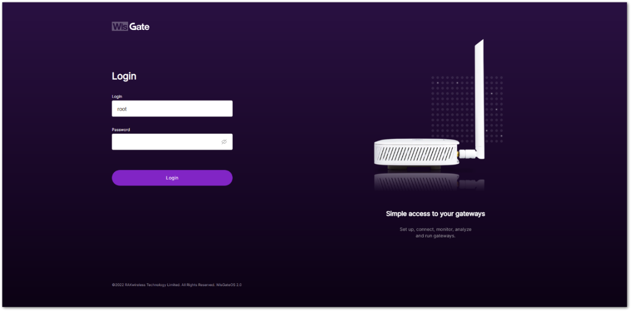

  1. Log in to the WisGateOS2 web interface of the RAK gateway.
WisGateOS 2 Login Page
Figure 1: WisGateOS 2 Login Page

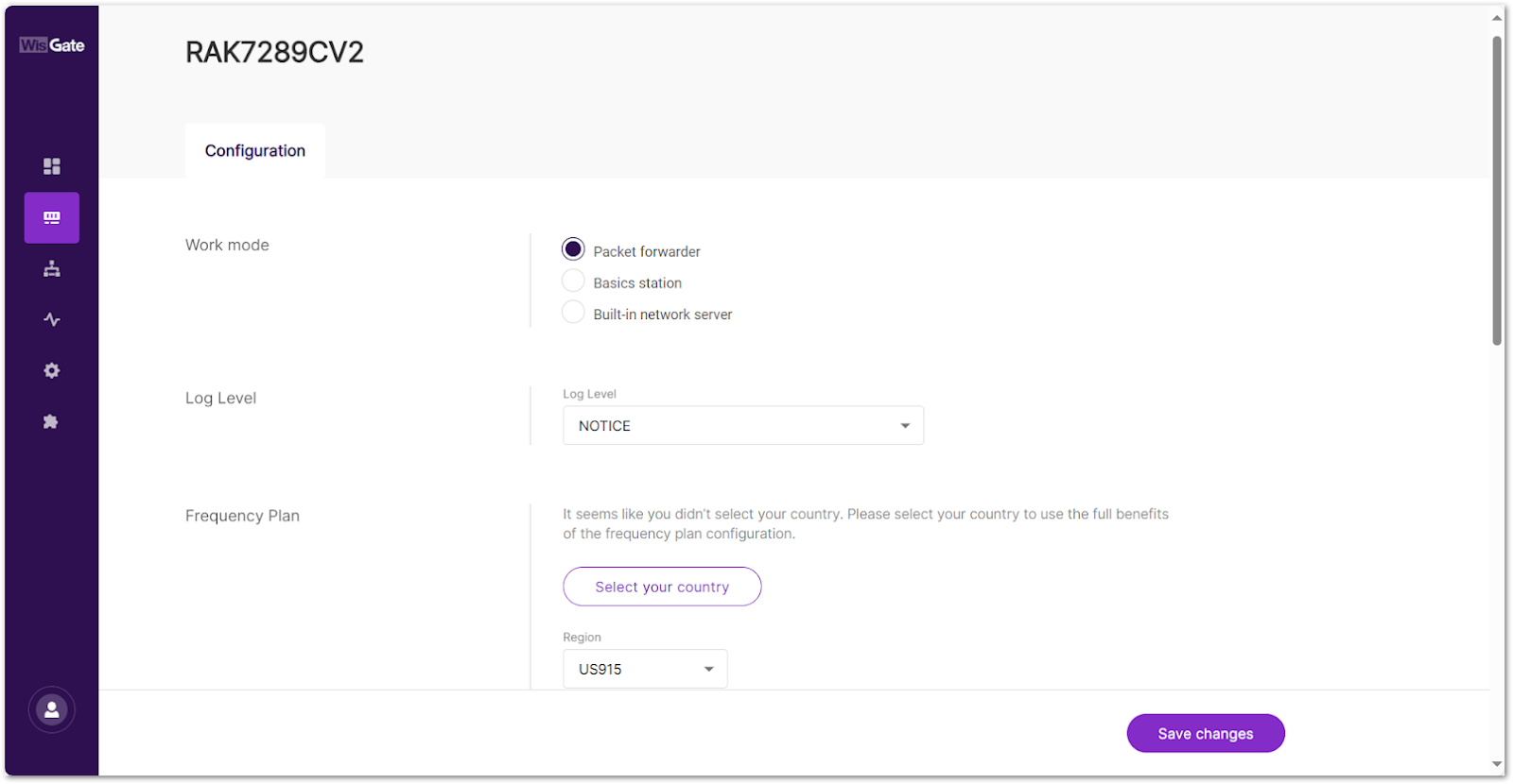

  1. Go to LoRa > Configuration and set Work Mode to Packet Forwarder.
WisGateOS 2 Configuration Page
Figure 2: WisGateOS 2 Configuration Page
NOTE
Ensure the configured frequency band matches the frequency plan selected in the TTN Console.

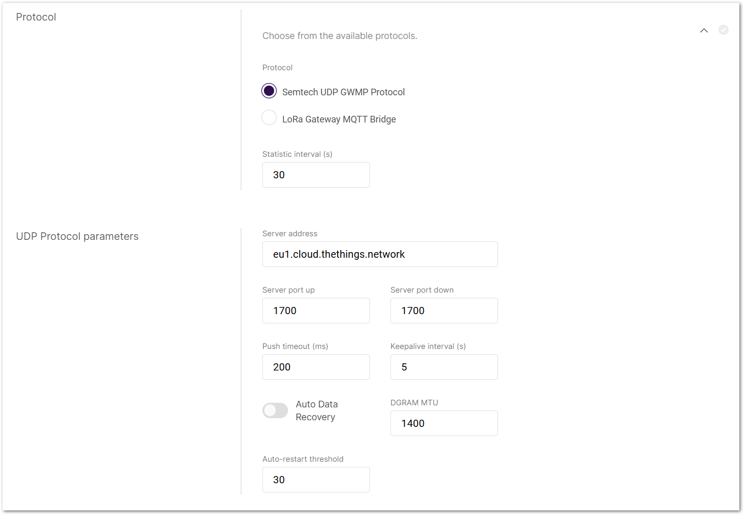

  1. In the Protocol field, choose Semtech UDP GWMP from the dropdown menu.
WisGateOS 2 UDP Protocol Configuration
Figure 3: WisGateOS 2 UDP Protocol Configuration
  • If you're using TTN's EU1 cluster, the server address and port are pre-filled, and you simply confirm them.
  • For other regions, update the Server address according to your TTN cluster (the port 1700 remains unchanged).
  1. Click Save changes to apply the configuration.

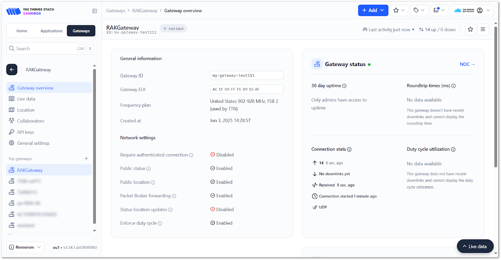

Verify the Gateway Status
Go back to the TTN Console and open the gateway details page.
A blue status dot and messages like Last activity just now confirm that the gateway has successfully connected to TTN.
TTN v3 WisGate Gateway Connected
Figure 4: TTN v3 WisGate Gateway Connected
