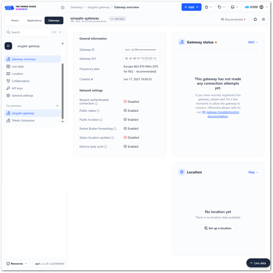

  1. To generate a key file, navigate to API keys from the Overview page of the registered gateway.
TTN V3 Gateway Overview Tab
Figure 1: TTN V3 Gateway Overview Tab

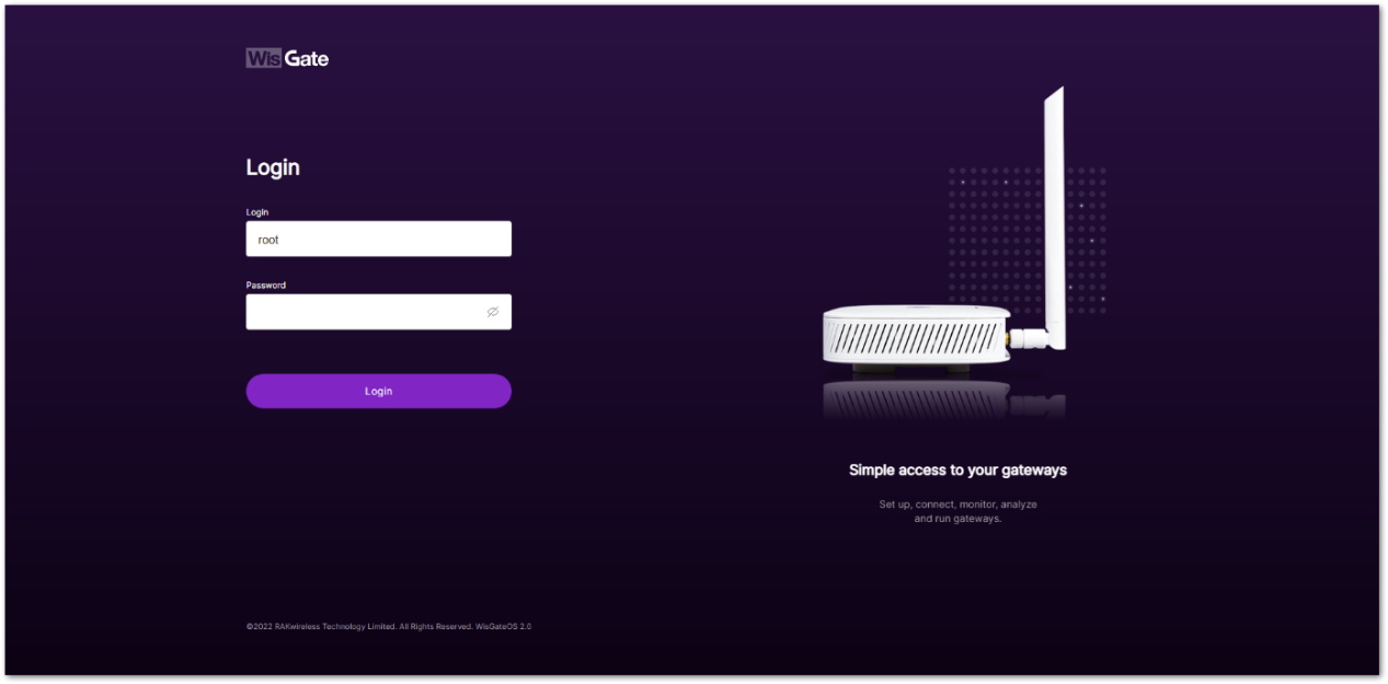

  1. Log in to the gateway's Web UI.
wisgateos 2 login page
Figure 5: WisGateOS 2 Login Page

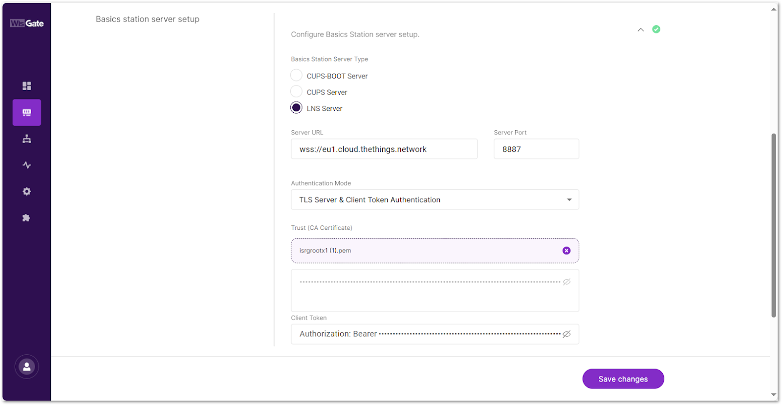

  1. Click Configure Basics Station server setup to expand the relevant settings panel. Configure the following parameters:
  • Basics Station Server Type: LNS Server
  • Server URL: This is the link to The Things Network server. For this tutorial, the gateway is connected to the European cluster. In the Server URL field, enter: wss://eu1.cloud.thethings.network
  • Server Port: 8887
  • Authentication Mode: TLS server authentication and Client token
  • Trust (CA Certificate): For Trust, upload the Let’s Encrypt ISRG ROOT X1 Trust certificate by clicking Choose File. The certificate file can be downloaded from this link.
  • Client Token: Paste the LNS API key you generated in the previous step.
WisGateOS 2 LNS Server Configuration
Figure 7: WisGateOS 2 LNS Server Configuration
  1. To save your changes, click Save changes.

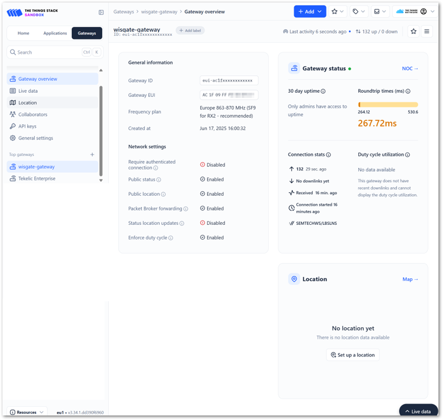

If everything is set up correctly, you should see that the gateway is connected to TTN console.
TTN V3 WisGate Gateway Connected
Figure 8: TTN V3 WisGate Gateway Connected
