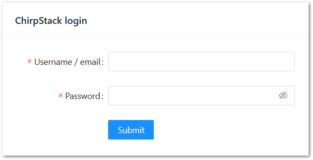

2. Log in using the default credentials:
  • Username/email: admin
  • Password: admin
Login to ChirpStack
Figure 1: Login to ChirpStack

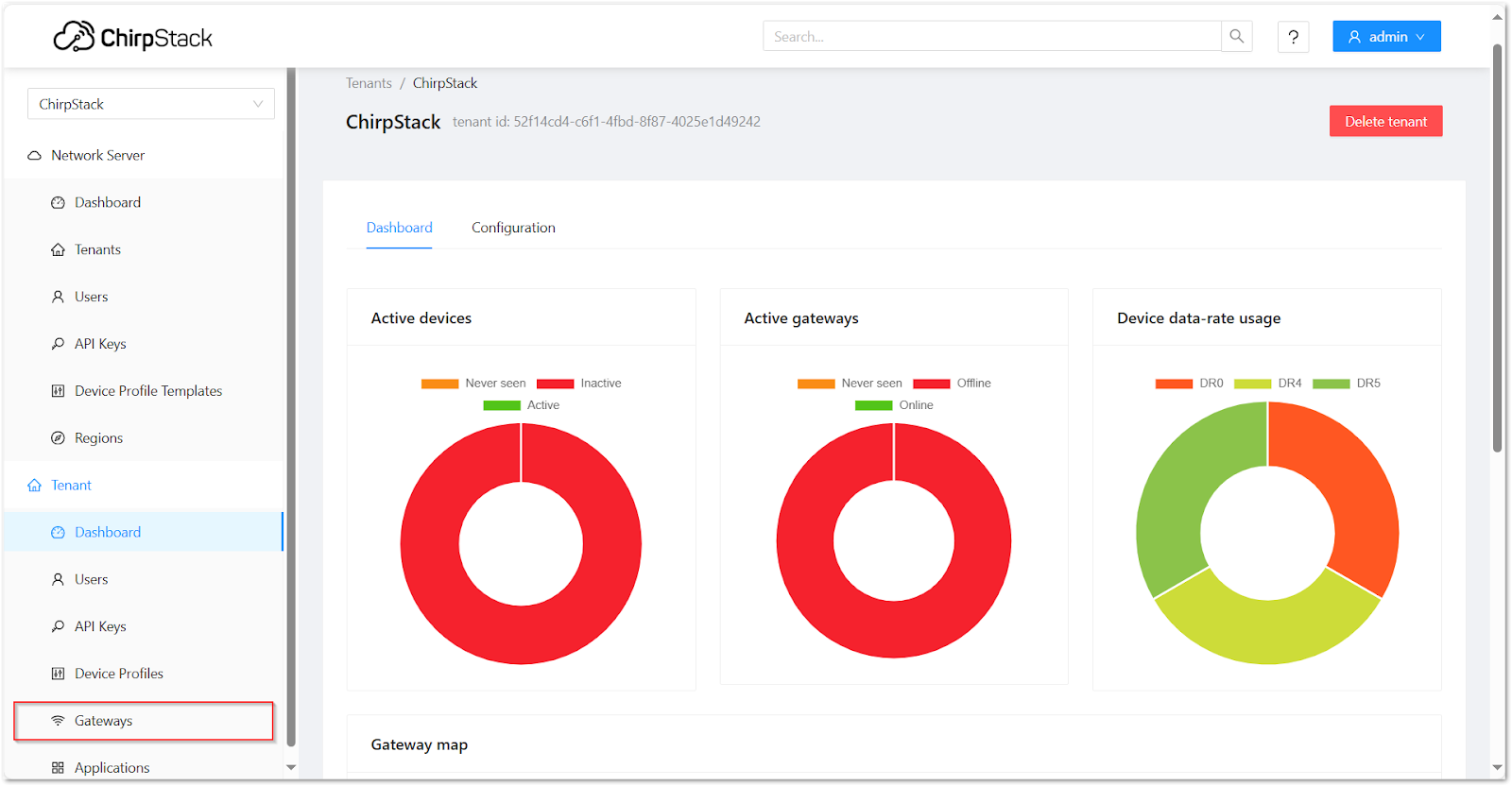

3. Navigate to Gateways.
Figure 2: Navigate to Gateways

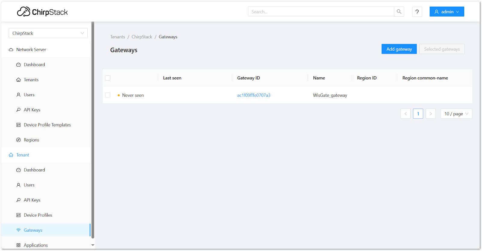

You will now be able to see your gateway on the gateway list in the ChirpStack v4 web interface.
View the gateway list in ChirpStack v4
Figure 5: View the gateway list in ChirpStack v4
