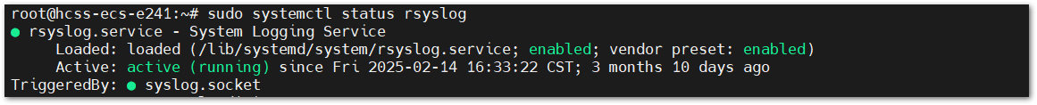

5. Verify that rsyslog is running properly:
sudo systemctl status rsyslog
You should see output indicating the service is active (running).

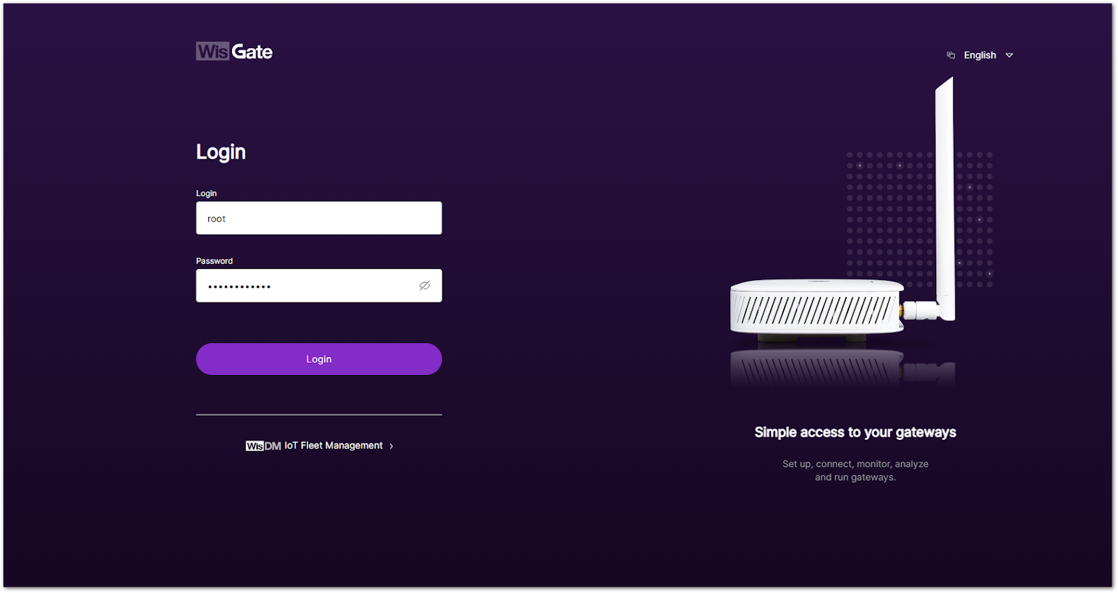

1. Log in to the gateway’s Web UI.
WisGateOS 2 web UI login page
Figure 1: WisGateOS 2 web UI login page
