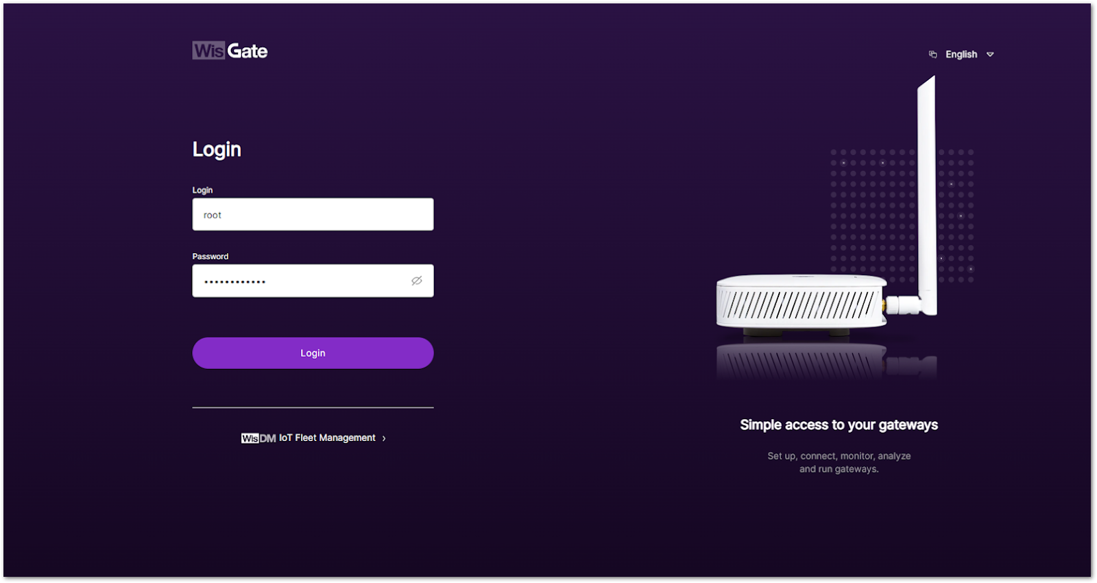

  1. Log in to the WisGateOS2 web interface of the RAK gateway.
WisGateOS 2 Login Page
Figure 1: WisGateOS 2 Login Page

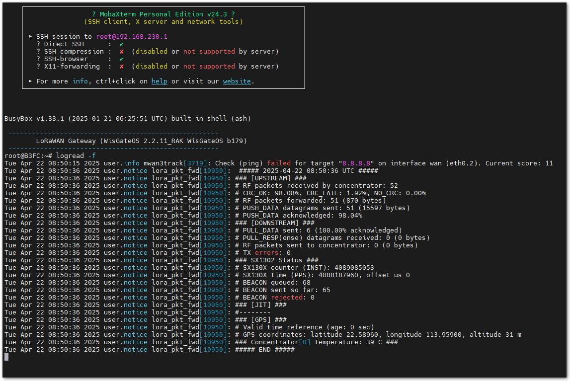

  2. To view live system logs, run: logread -f
SSH Client System Logs
Figure 5: SSH Client System Logs
  1. To display the logs currently stored in memory (without continuous streaming), execute: logread
SSH Client Logs Stored In Memory
Figure 6: SSH Client Logs Stored In Memory

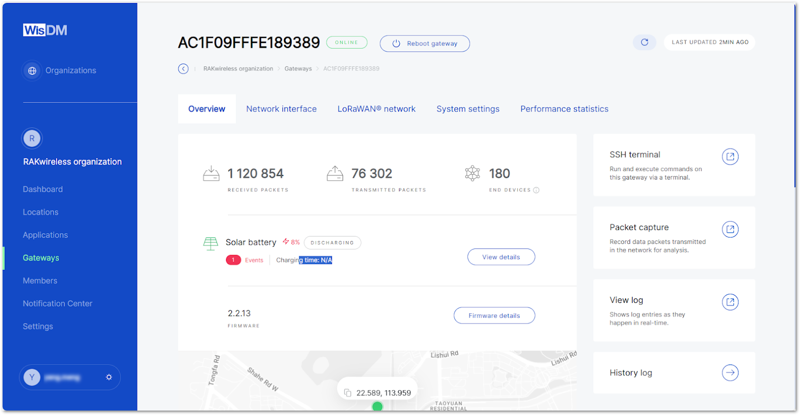

  1. On the device Overview page, click View Log and then select Start System Log to begin live log streaming.
WisDM Gateway Options Page
Figure 13: WisDM Gateway Options Page

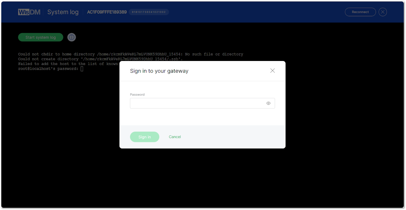

  1.  When prompted, enter the login password for the gateway to authenticate.
Sign in to your gateway via WisDM System log
Figure 14: Sign in to your gateway via WisDM System log

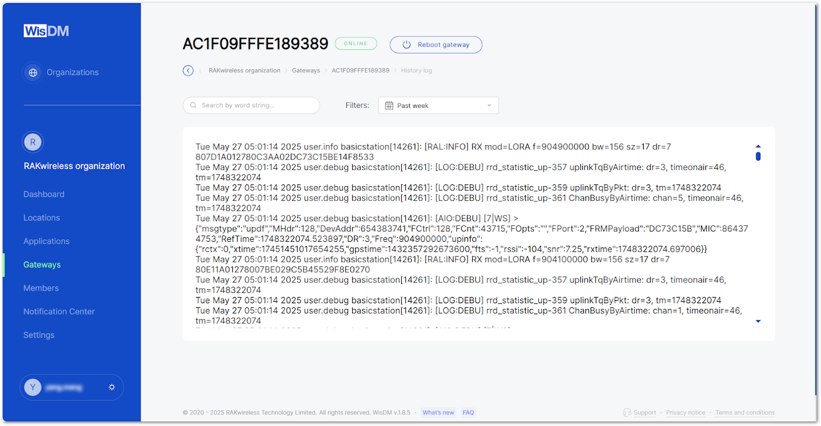

  2. Return to the device’s Overview page in WisDM and click History Log to view the recently uploaded log archives.
WisDM History Log of the Gateway
Figure 17: WisDM History Log of the Gateway

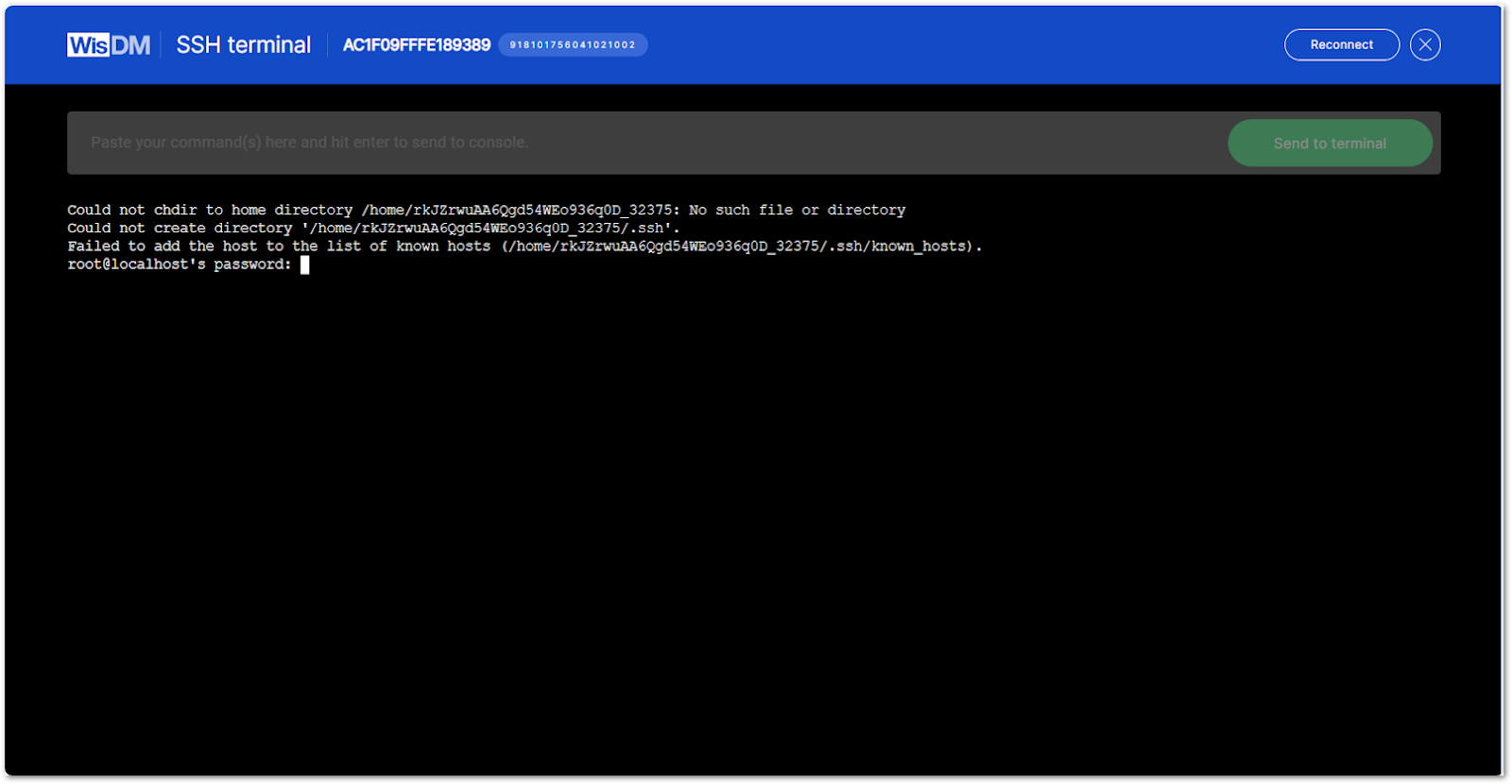

  1. On the Overview page of the selected gateway, click SSH Terminal.
  2. Enter the gateway password to authenticate.
WisDM SSH Terminal to Acces the Gateway
Figure 18: WisDM SSH Terminal to Access the Gateway
