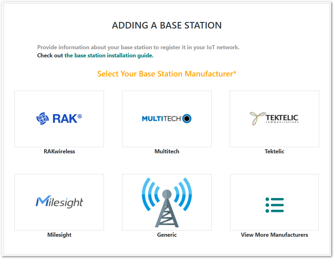

  1. In the ADDING A BASE STATION prompt, click View More Manufacturers to expand the complete list of gateway vendors.
Actility Add a Base Station
Figure 2: Actility Add a Base Station

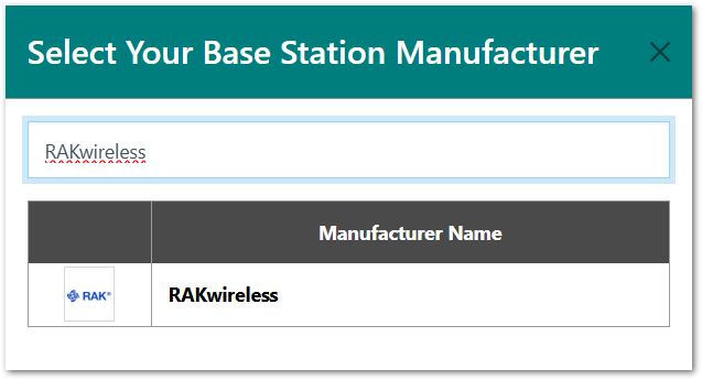

  1. In the Select Your Base Station Manufacturer window, search for and select RAKwireless. You can scroll through the list or type RAKwireless in the search field.

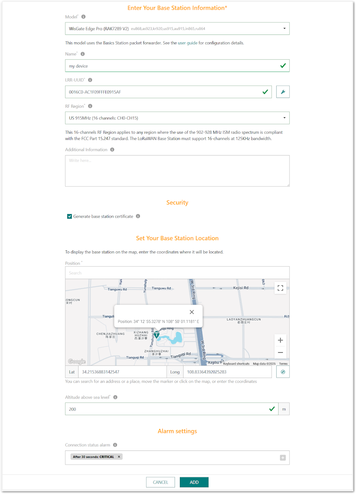

  1. You will be redirected to the ADDING A BASE STATION page. Fill in the required gateway information.
Actility Base Station Information and Location
Figure 4: Actility Base Station Information and Location
  • Model: Select your RAK gateway. If it is not listed, choose the closest match based on your WisGateOS version from the table below.
GATEWAY OS VERSION RAK GATEWAY GATEWAY MODEL SELECTION
WisGateOS 2 RAK7268V2 Edge Lite 2 WisGate Edge Pro (RAK7289 V2)
RAK7240V2 Edge Prime WisGate Edge Pro (RAK7289 V2)
RAK7285 Edge Ultra WisGate Edge Pro (RAK7289 V2)
RAK7289V2 Edge Pro WisGate Edge Pro (RAK7289 V2)
RAK7267 Soho Pro WisGate Edge Pro (RAK7289 V2)
RAK7266 Soho Lite WisGate Edge Pro (RAK7289 V2)
WisGateOS RAK7258 Edge Lite WisGate Edge Lite (RAK7258)
RAK7268 Edge Lite 2 WisGate Edge Lite (RAK7258)
RAK7240 Edge Prime WisGate Edge Prime (RAK7240)
RAK7289 Edge Pro WisGate Edge Max (RAK7249)
RAK7391 WisGate Connect WisGate Edge Lite (RAK7258)
  • Name: Enter a name for your gateway.
  • LLR-UUID: Enter the gateway’s identifier in the format 0016C0-XXXXXXXXXXXXXXXX, where XXXXXXXXXXXXXXXX is the gateway’s EUI. The EUI can be found on the gateway’s physical label (GW EUI) or under Dashboard > Overview in the Web UI.
  • RF Region: Select the appropriate frequency band for your deployment region.
  • Additional Information: (Optional) Add notes or comments for future reference.
  • Position: Set the physical location of the gateway by:
    • Typing the address into the Search field.
    • Clicking on the map to place the location marker; the latitude and longitude fields will be filled automatically.
    • Entering the gateway’s installation height (in meters) in the Altitude above sea level field.
NOTE
If your gateway has a built-in GPS/GNSS module like the RAK7289V2, you do not need to manually set the position. The gateway will automatically report its location to the Actility LoRaWAN server.
  • Connection status alarm: Sets the time and severity level for triggering an alarm when the gateway loses connection.

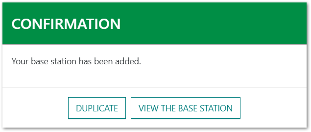

  1. Once all fields are complete, click the ADD button. A confirmation will appear; click VIEW THE BASE STATION.
Actility Confirmation of Base Station
Figure 5: Actility Confirmation of Base Station

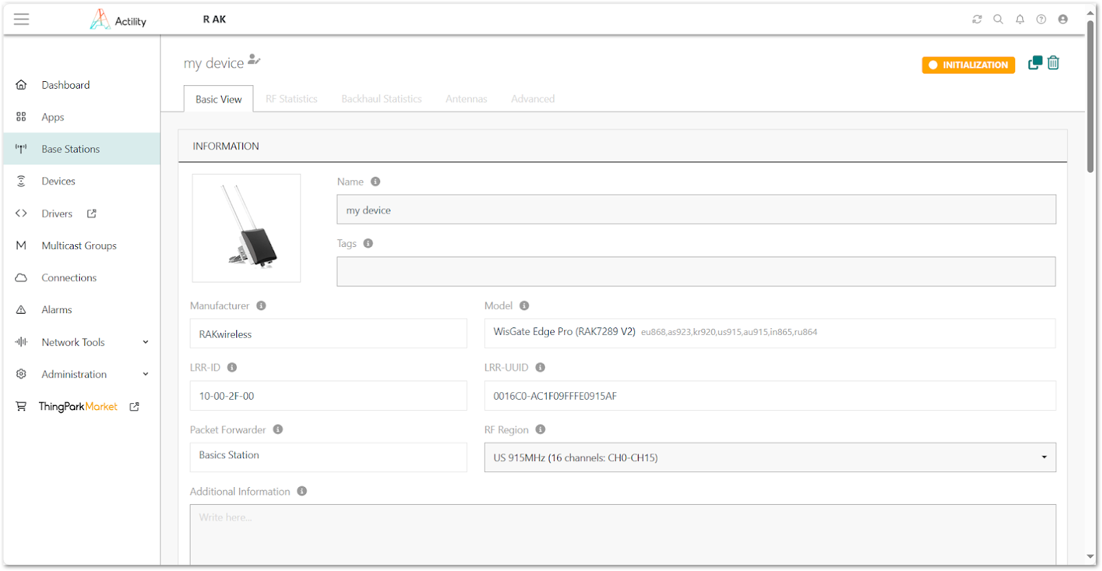

  1. You will then be redirected to the gateway's dashboard, where the status will initially display as INITIALIZATION.

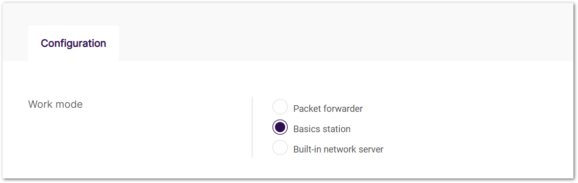

  1. Log in to the gateway's Web UI.
  2. Navigate to LoRa® > Configuration and set the Work Mode to Basics Station.
WisGateOS 2 Basics Station Page
Figure 7: WisGateOS 2 Basics Station Page

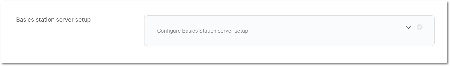

  1. Click Configure Basics Station Server Setup to start configuring the server.
Figure 8: Basics Station Server Setup

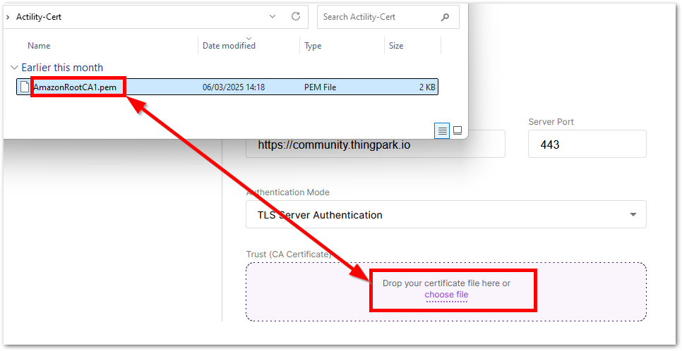

  • CUPS Server: Select the CUPS Server.
  • Server URL: https://community.thingpark.io
  • Server Port: 443
  • Authentication Method: Select TLS Server Authentication.
  • Trust (CA Certificate): Upload the AmazonRootCA1.cer file you previously downloaded.
Upload the Amazon Certificate
Figure 10: WisGateOS 2 Upload CA Certificate

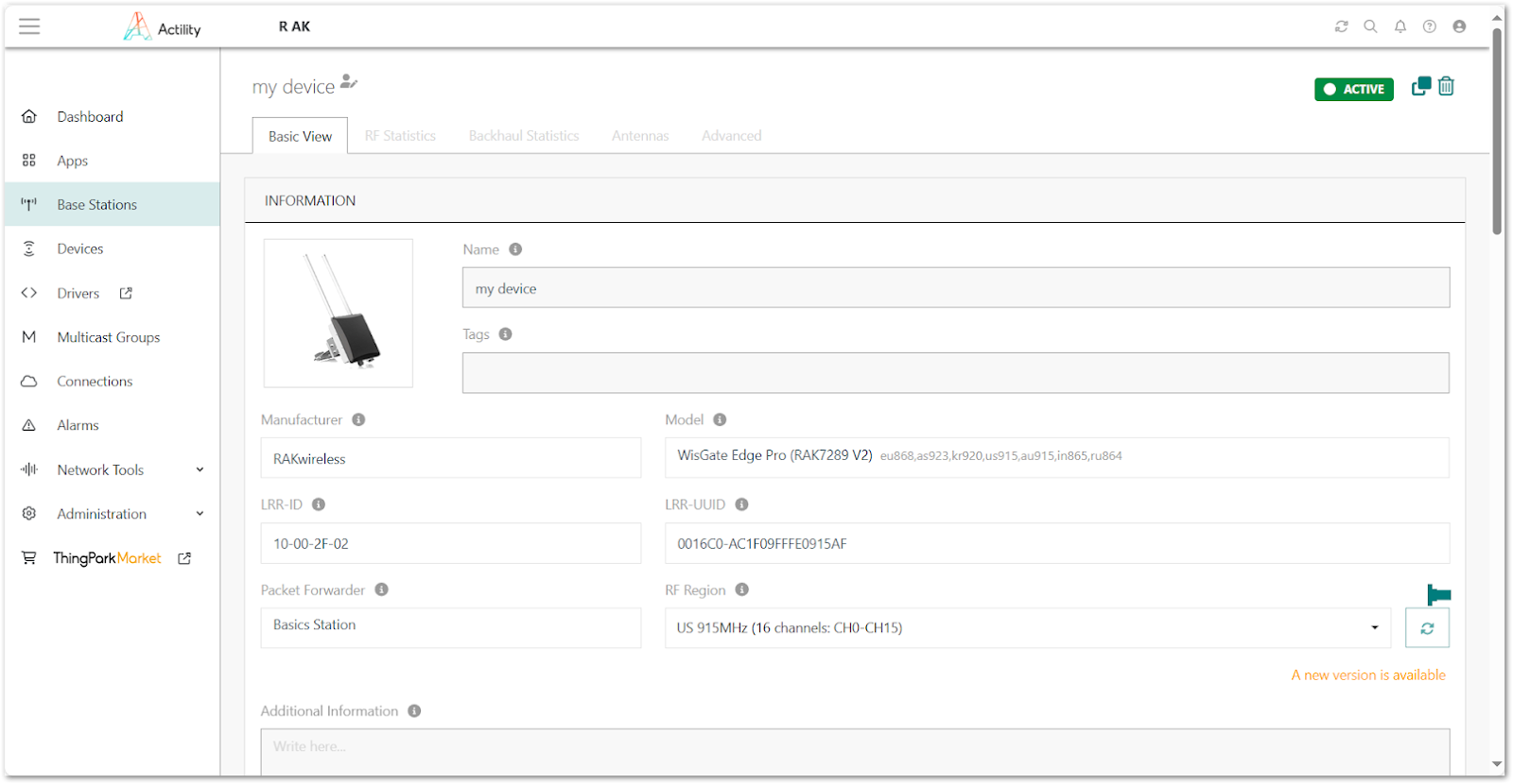

If the configuration is successful, the gateway status will change from INITIALIZATION to ACTIVE within a few minutes.
Actility Base Station Page
Figure 11: Actility Base Station Page
