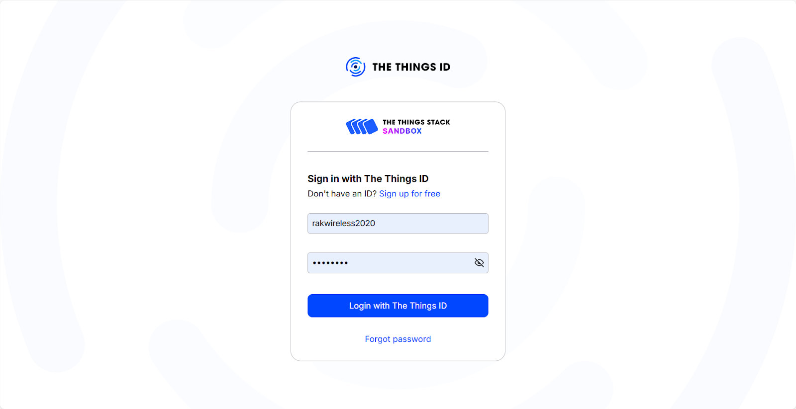

1. Log in to TTN v3 Console
Go to the TTN v3 console and select the appropriate network cluster (EU, NAM, or AU) based on your gateway’s location. Then, log in to your account.
If you don’t have an account yet, sign up and choose the cluster that matches your deployment region.
Sign in with TTN ID
Figure 1: Sign in with TTN ID

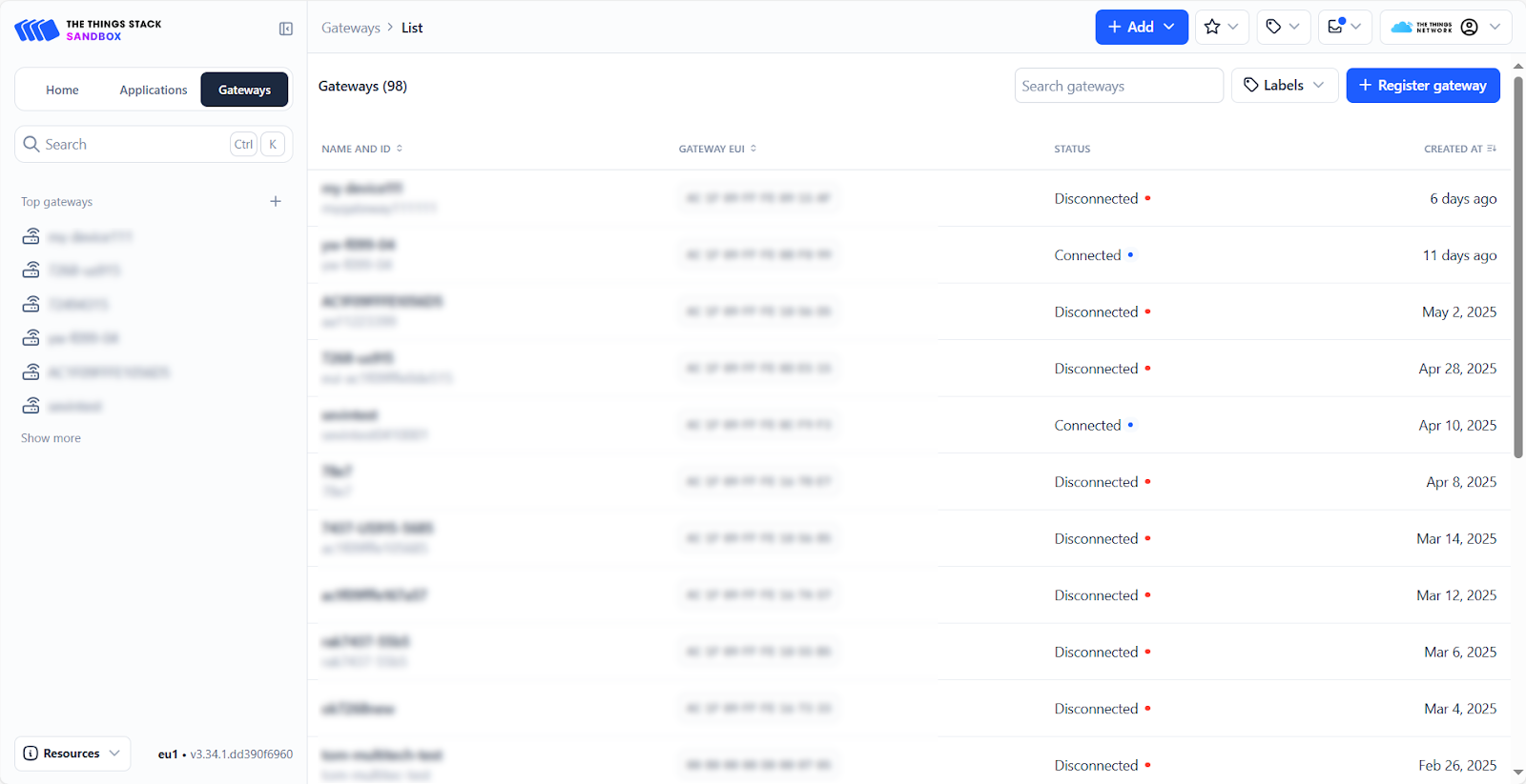

2. Register a New Gateway
Navigate to the Gateways section and click + Register gateway.
Register a new RAK gateway to TTN v3
Figure 2: Register a new RAK gateway to TTN v3

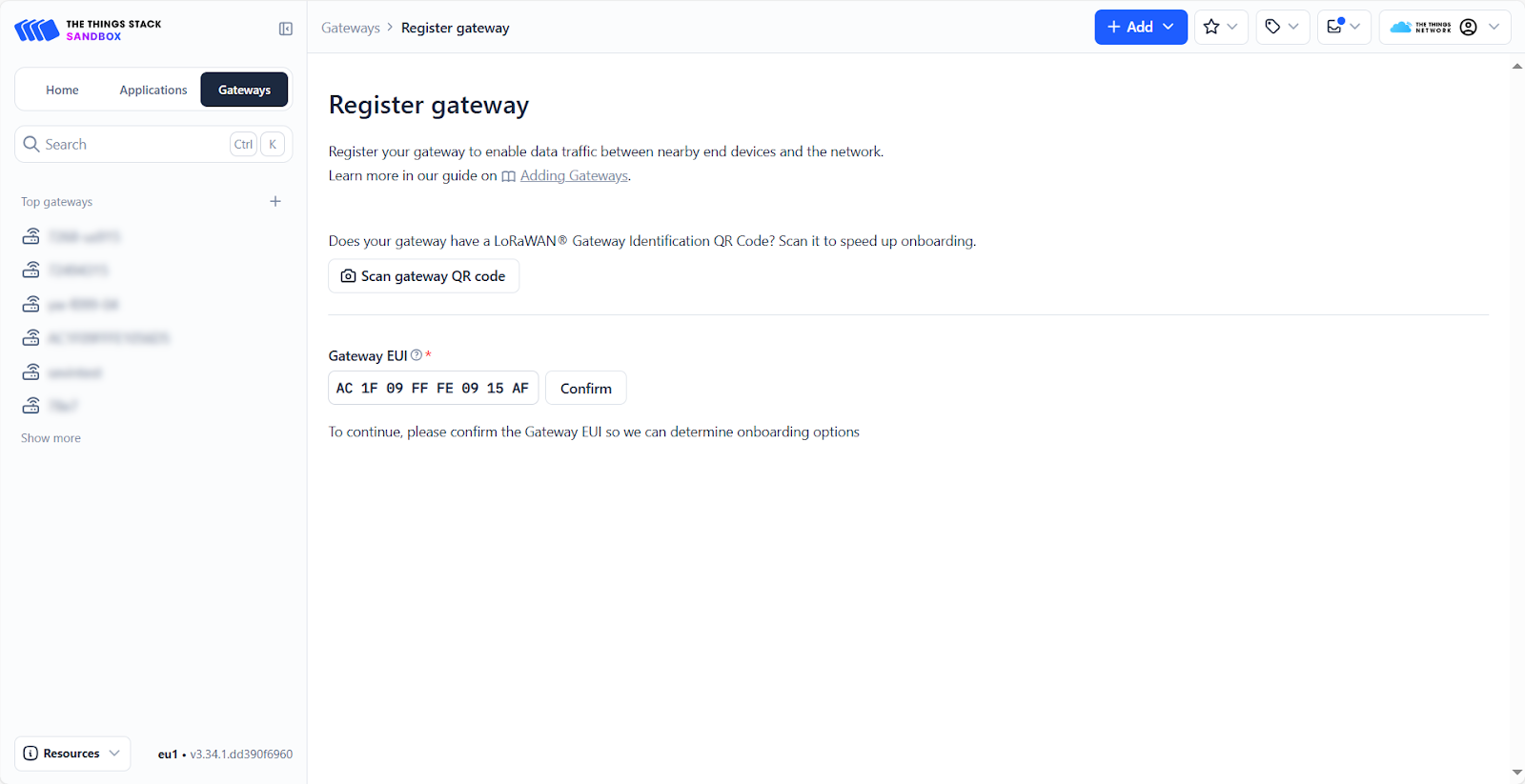

3. Enter the Gateway EUI
Retrieve the Gateway EUI from your RAK gateway. You can find it either:
  • On the device label marked GWEUI
  • In the Web UI under Dashboard > Overview
Enter the EUI into the form and click Confirm.
Enter Gateway EUI
Figure 3: Enter Gateway EUI

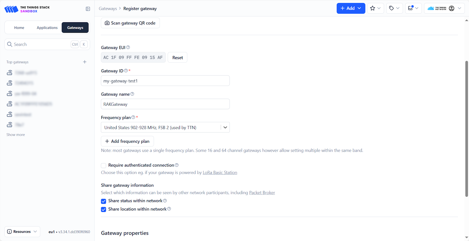

4. Complete the Gateway Details
Fill in the following fields:
  • Gateway ID - a unique identifier for your gateway
  • Gateway name - a descriptive name for easy reference
  • Frequency plan - select the correct frequency based on your gateway’s region.
Fill in the details to complete the gateway registration process
Figure 4: Fill in the details to complete the gateway registration process

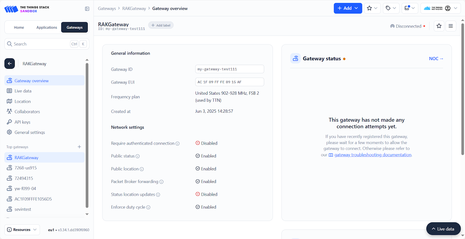

5. Finish the Gateway Registration
Click Register gateway to complete the setup.
RAK gateway has been successfully registered to TTN v3
Figure 5: RAK gateway has been successfully registered to TTN v3
