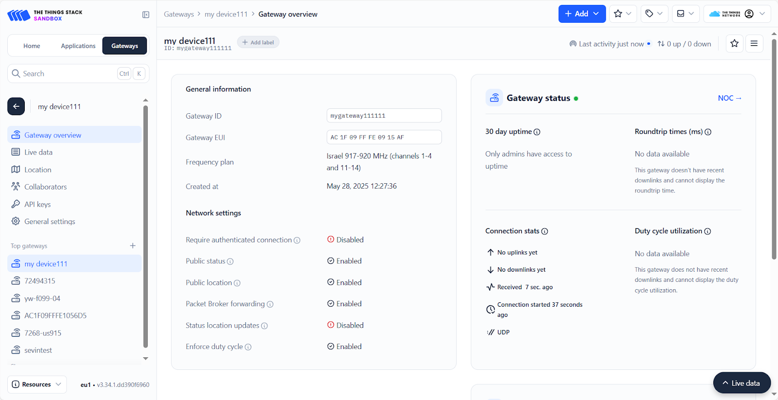

    3. Gateway Connection Status
    • Go back to the TTN Console and open the gateway details page.
    • If the gateway is connected, you will see:
      • A blue status dot
      • A message like Last activity just now
    These indicators confirm that the gateway is successfully connected to the TTN EU1 cluster.
    Gateway connection status
    Figure 3: Gateway connection status
