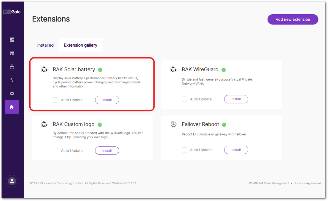

2. Log in to the WisGateOS 2 Web UI.
3. Navigate to Extensions > Extension Gallery.
4. Install the Battery Plus Extension. For details, read the WisGateOS 2 Extensions user manual.

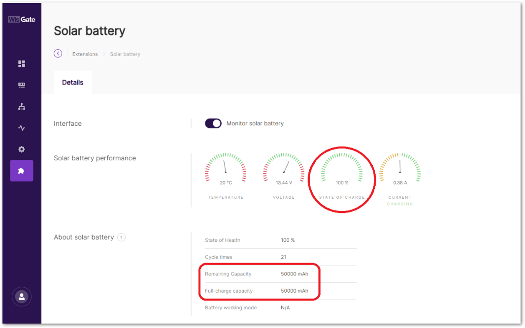

5. After installation, go to the Installed tab, click Launch, and check the State of Charge.
- If the charge level is above 30–50%, the Battery Plus is ready for deployment.
- If the charge level is below 30%, it must be charged before use.

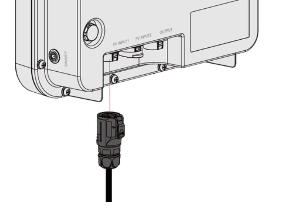

To charge the unit before deployment, use the Service Power Adapter for Battery Plus, a dedicated AC/DC adapter with the correct connector.
The Service Power Adapter is not included by default. It must be purchased separately.
To charge the battery:
- Plug the service power adapter into one of the two solar panel input ports on the Battery Plus.
- Connect the adapter to an AC power outlet.
- Press the power button on the Battery Plus to turn it on.
If you do not press the power button, the Battery Plus will only pass through power from the PV input to the output; the battery will not charge.

While the battery is connected to a RAK Gateway, you can continue to monitor the charge level using the Battery Plus Extension in WisGateOS 2.
- A full charge typically takes several hours.
- For optimal performance, fully charge the Battery Plus to 100% before its first field deployment.
