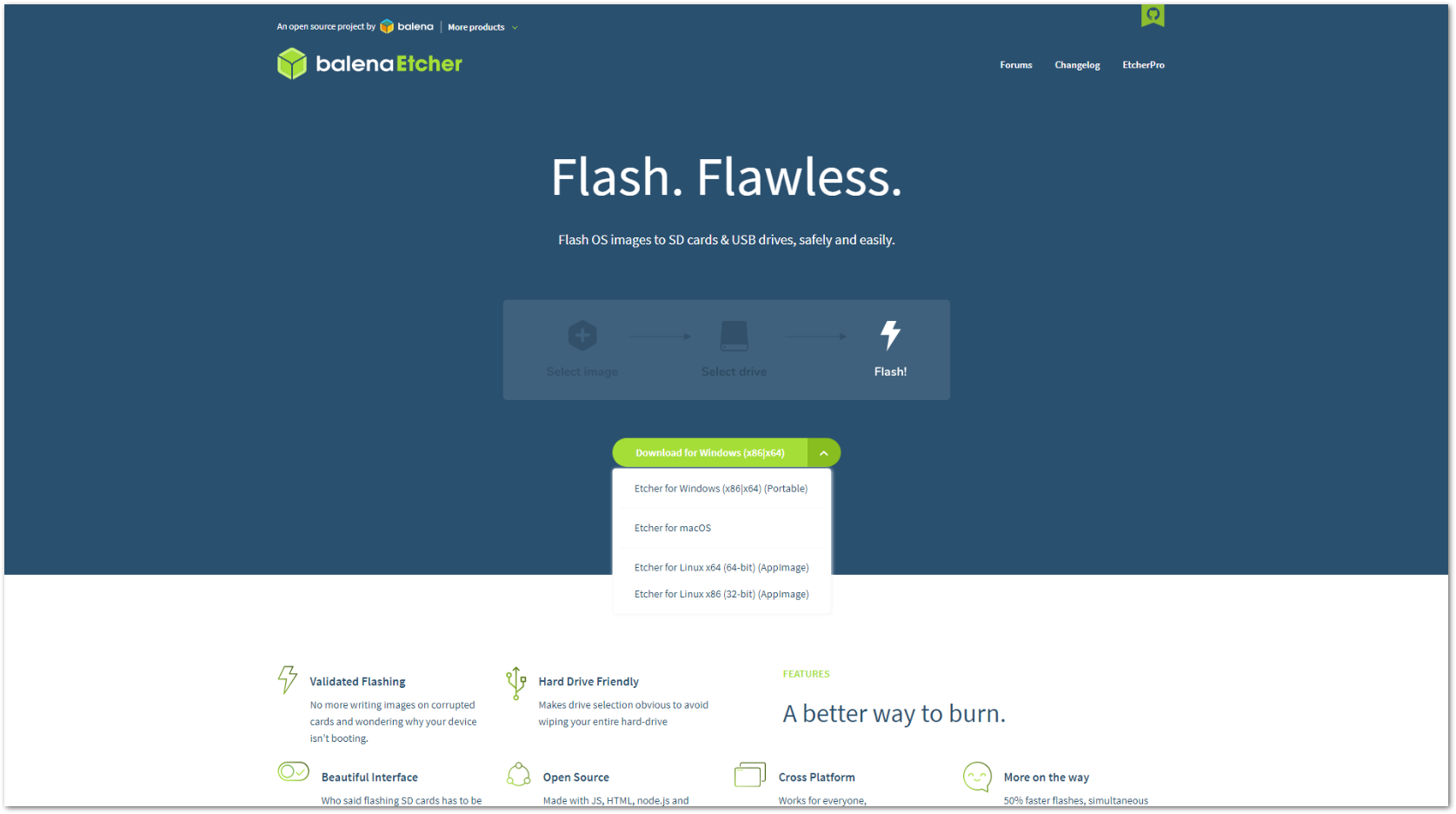

Download the balenaEtcher software. There are options for Windows, macOS, and Linux. Clicking the Download button will provide you with the software directly, no installation is required.

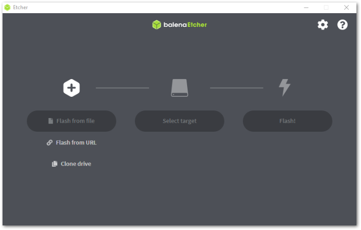

Open balenaEtcher and click Flash from file. Here, you need to select the file that will be flashed on the SD card. Note that the software allows the user to Flash from URL and Clone drive as well, but in this tutorial, only the Flash from file function will be demonstrated.

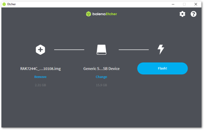

By clicking on the Select target button, you will have the option to choose the SD card that you want to flash.

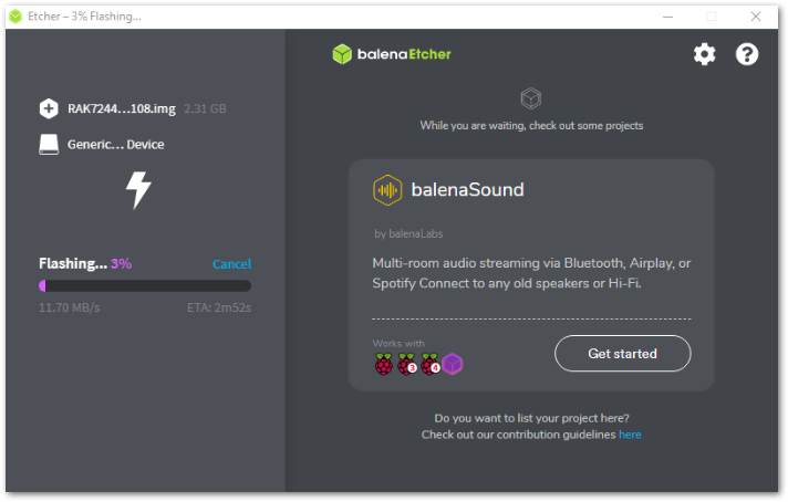

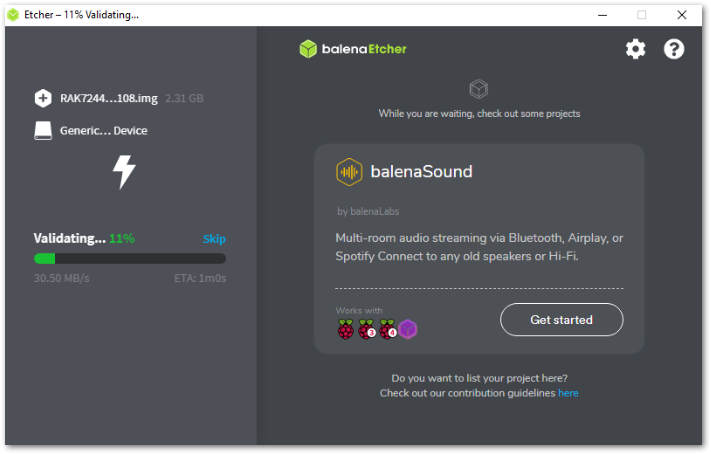

Click the Flash button to finalize the procedure. Wait until the flashing and validating processes are done. When both are completed, your SD card is flashed and ready to use.
