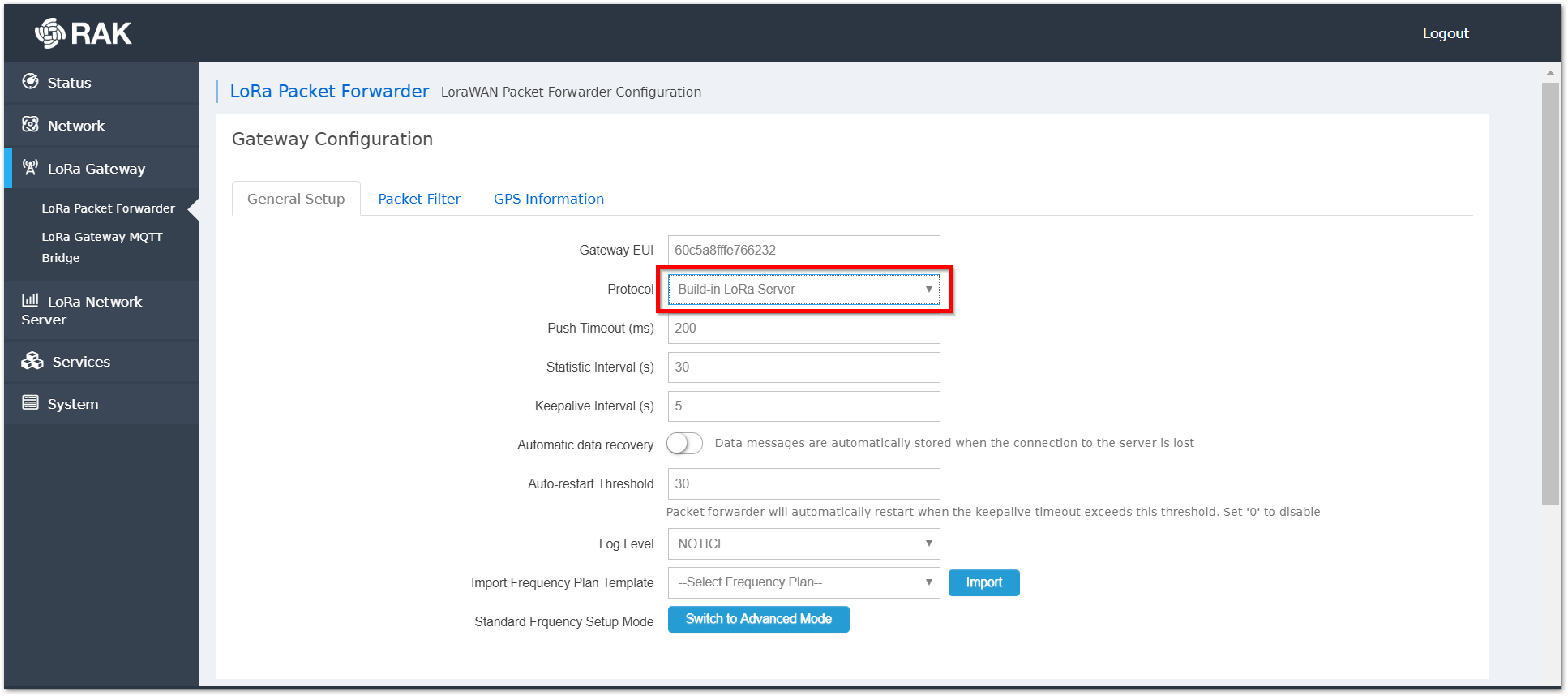

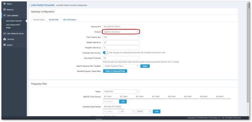

By navigating through LoRa Gateway tab-> LoRa Packet Forwarder-> General Setup, set the Protocol in the drop-down list to Build-in LoRa ® Server.
You can leave the rest of the settings with their default values. Remember to "Save & Apply".

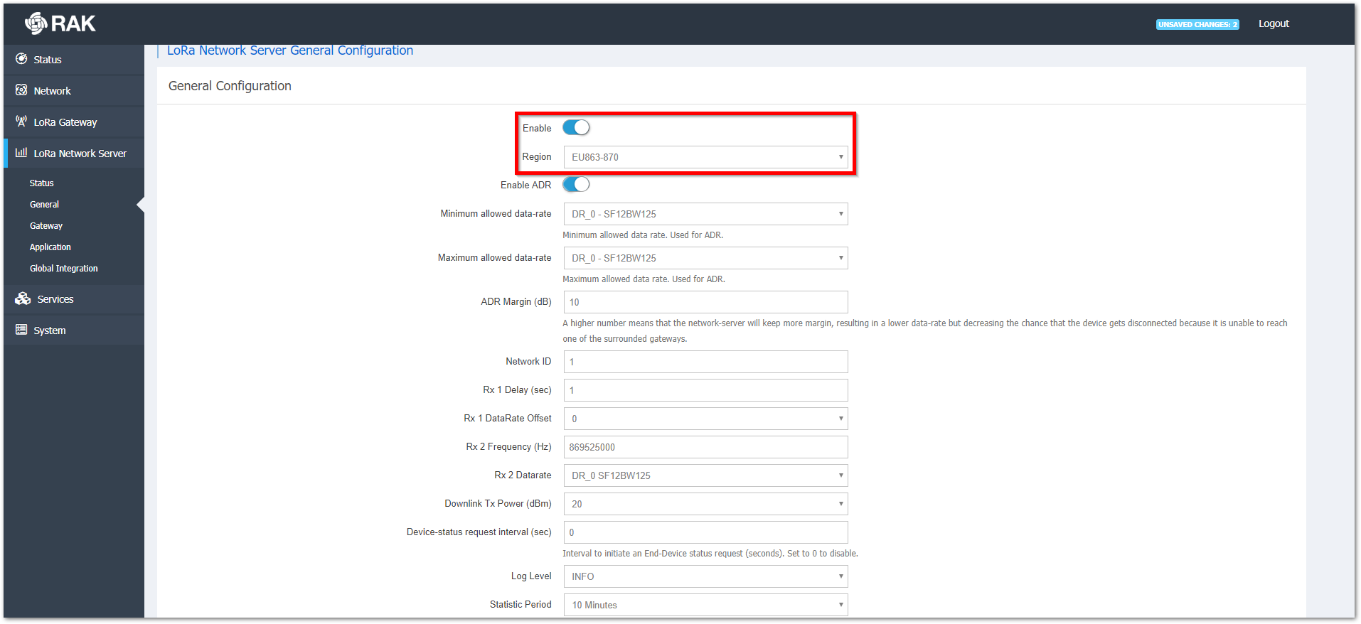

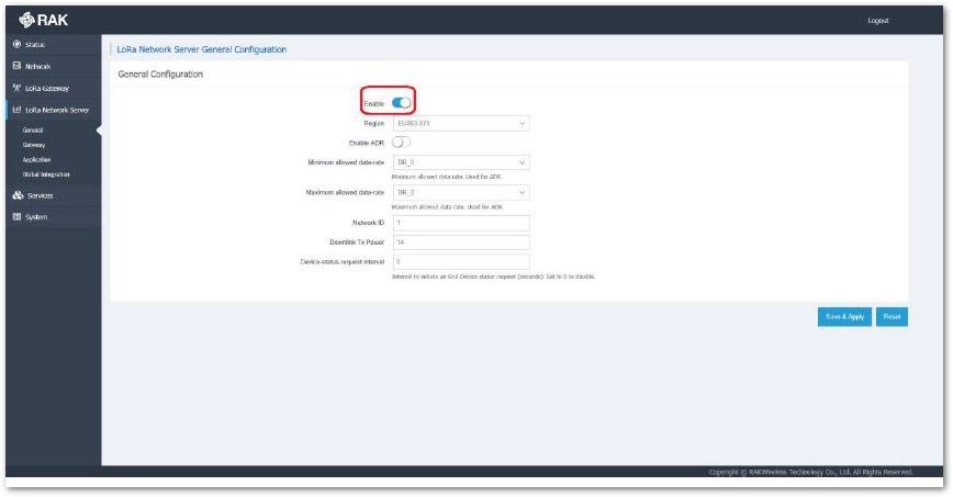

Navigate through LoRa Network Server tab -> General and turn-on this feature using the Enable slider.
Select your Region (Frequency Band). For this demonstration, we are going to use EU863-870 frequency band.

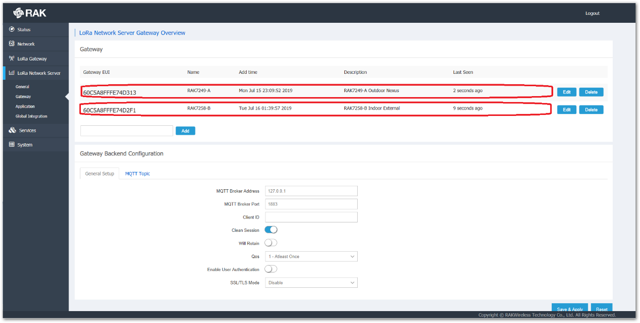

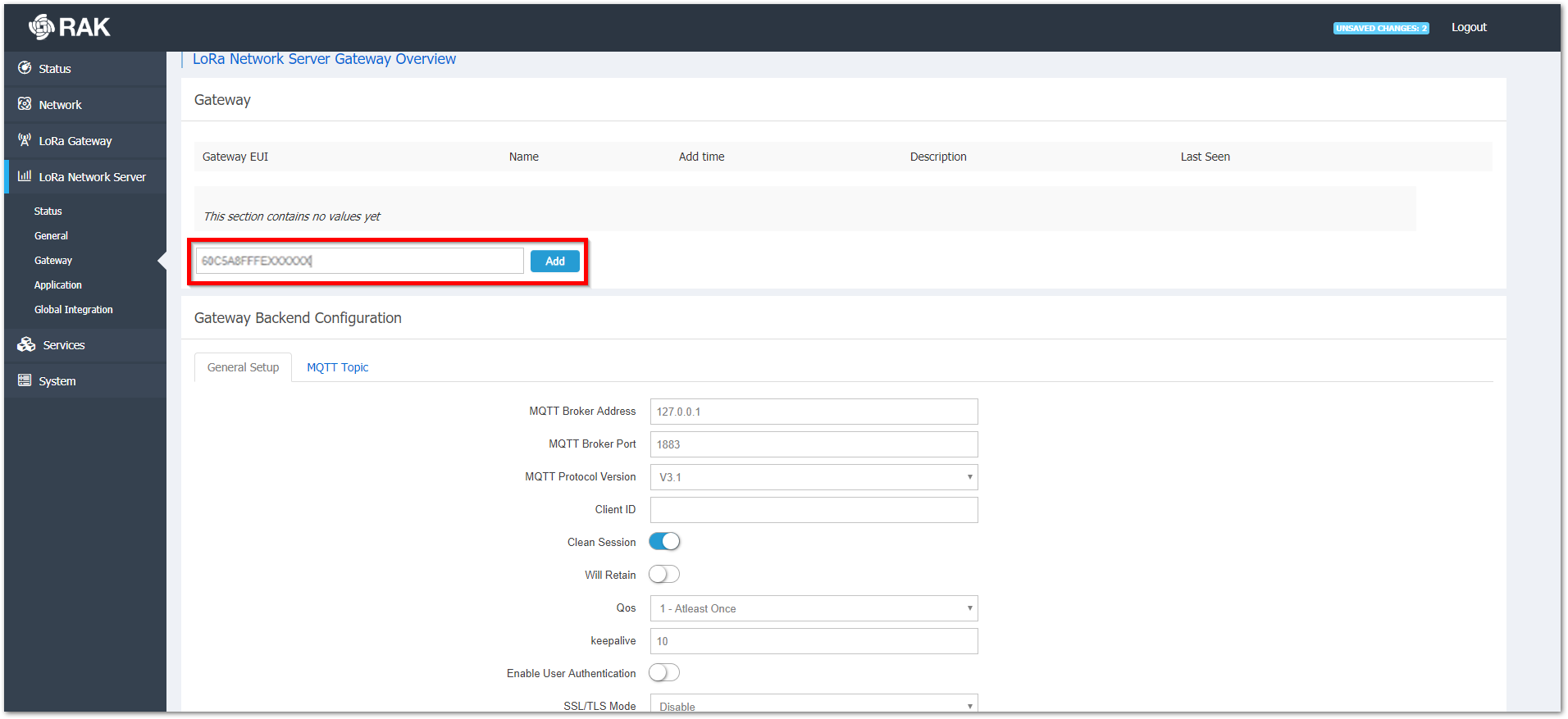

Navigate through LoRa Network Server-> Gateway and enter the Gateway EUI in the field.
By pressing the "Add" button, you will be redirected into a new tab where you will need to fill the mandatory parameters: Name and Description.
📝 NOTE: The Latitude, Longitude and Altitude parameters are not mandatory. You can leave them for later, or leave them empty if the gateway is not stationary.

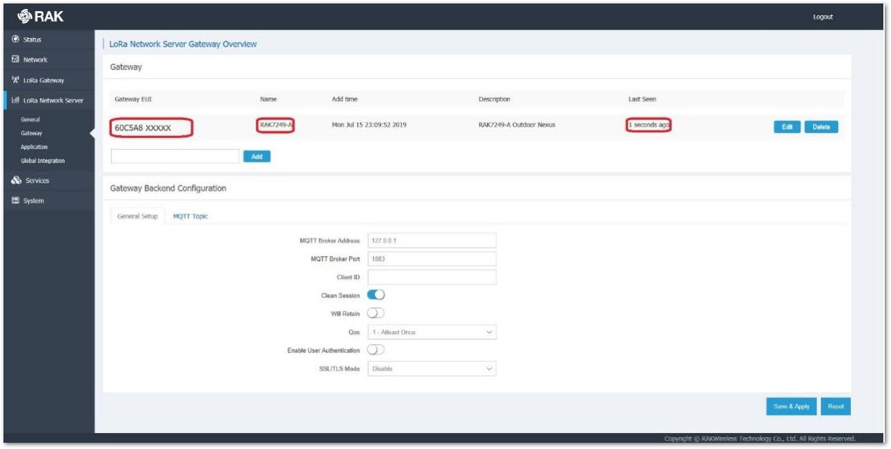

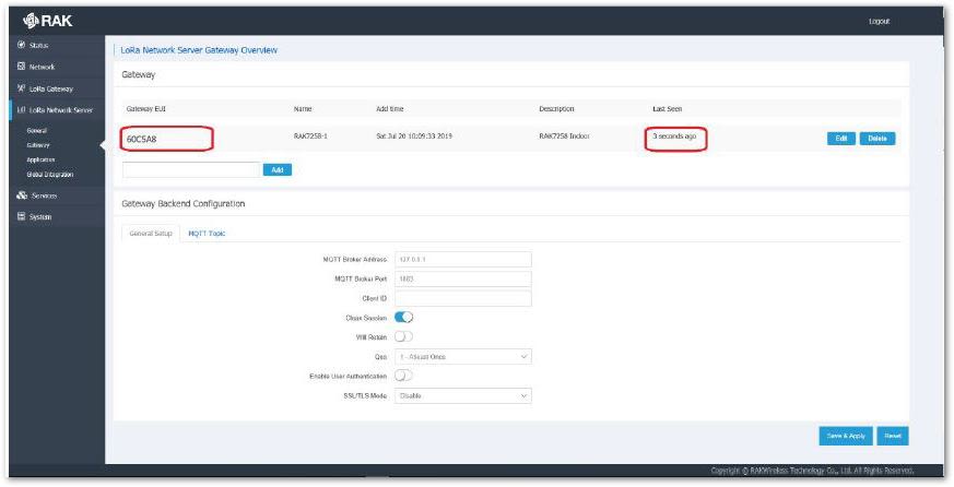

If everything is set-up correctly, you should see the same set-up with the image shown below:
📝 NOTE: In order to see the Last Seen status update you need to refresh the page. There should be a value of a couple of seconds, if so than everything went well. In case there is a message Never Seen, there is an issue and you best redo the configuration.

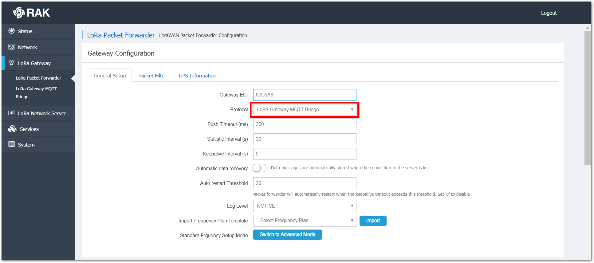

Packet Forwarder Set-up
By navigating through LoRa Gateway tab-> LoRa Packet Forwarder-> General Setup, set the Protocol in the drop-down list to LoRa Gateway MQTT Bridge.

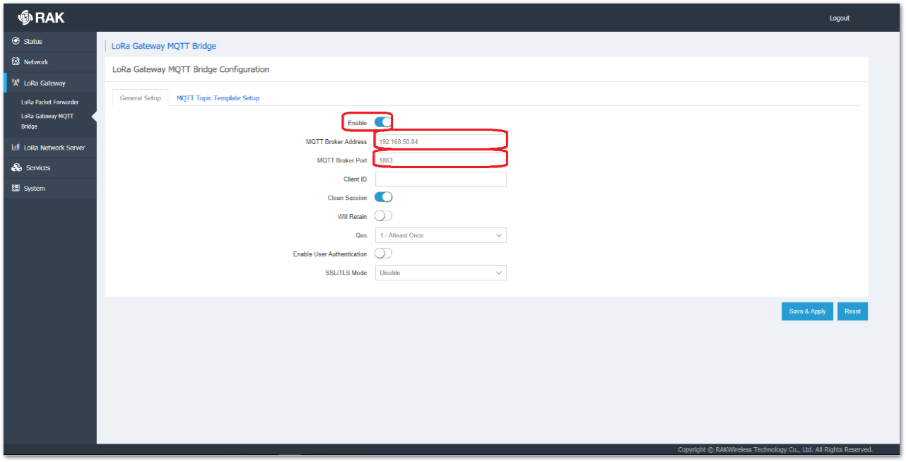

Navigate through LoRa Gateway tab -> LoRa Gateway MQTT Bridge -> General Setup and turn on this feature using the Enable slider.
Update the credentials needed in the list provided below.
    • MQTT Broker Address: IP address of Gateway-A
    • MQTT Broker Port: By default, its value is 1883. Please update this if it is not.
After clicking "Save & Apply", all LoRa traffic should be redirected via the Bridge of Gateway-B to the MQTT Broker of Gateway-A.
Registering RAK7249-B in RAK7249-A's LoRa Network Server
This procedure is the same as when you registered RAK7249-A in its built-in LoRa Network Server. Please refer to the Gateway-A with Built-in LoRa Network Server and repeat the process. The image below is the representation of what your configuration should look like with the two Gateways are added.

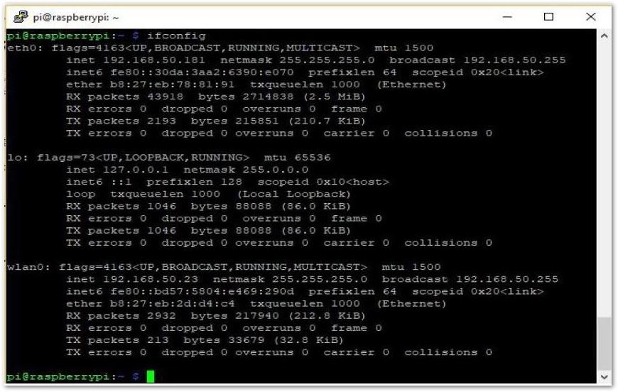

Execute the following command and note the IP address of the interface you will be using to connect to the network. You will need this, as it will be the address for your MQTT Broker when configuring the Gateway:
ifconfig

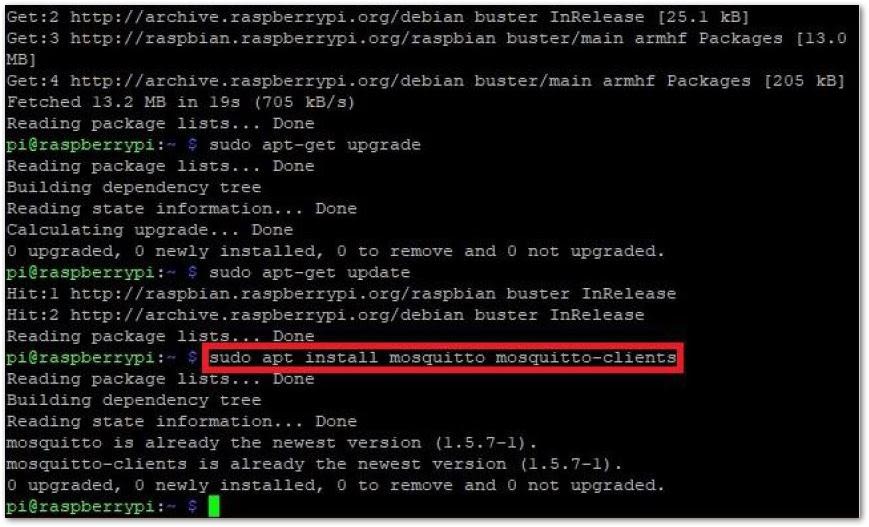

Installing Mosquitto
Install the MQTT Broker (Mosquitto) via the command:
sudo apt install mosquitto mosquitto-clients
Mosquitto clients help us easily test MQTT through a command line utility. We will use two command windows; one to subscribe to a topic and one to publish a message to it. Those will be explained in detail further in the tutorial.
📝 NOTE: This command is not mandatory, however it is recommended as it creates a mosquitto service that will run the broker on startup.
sudo systemctl enable mosquitto.service

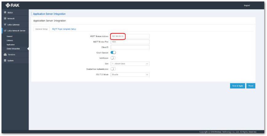

Finally, go to the Global Integration tab and enter the address where you have your Mosquitto instance running in the MQTT Broker Address field leaving the Port with the default 1883 value.

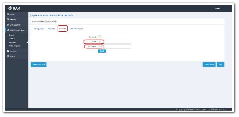

There is a convenient tool in the Built-in LoRa Server for sending a Downlink frame.
You can find it in the Device tab in the LoRa Network Server section. You can choose your Type of frame (confirmed/unconfirmed), the Frame port and the Hex Data shown in the image below:
Once you schedule a message for downlink it will be displayed in the Live Device Data window. Upon sending the next uplink via the RAK Serial Port Tool you will also see it there, as it needs an uplink frame in order to send the downlink in the RX1 window shown in the image below.

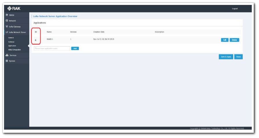

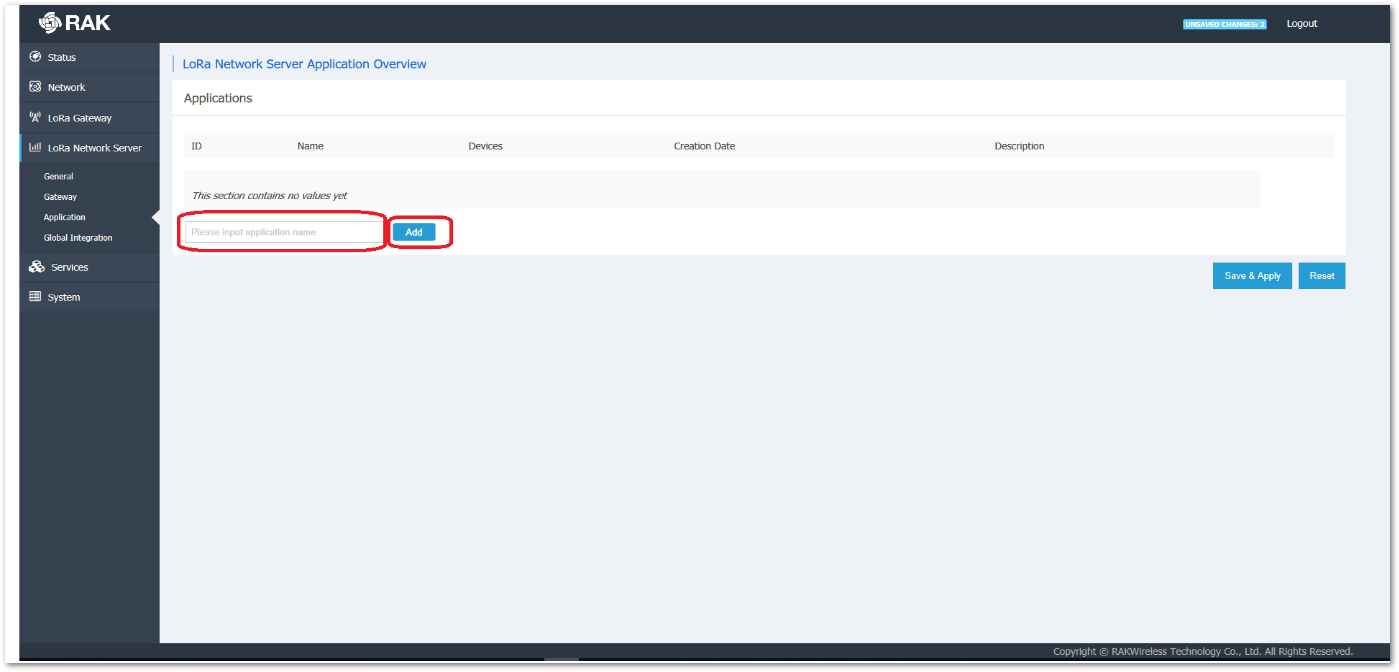

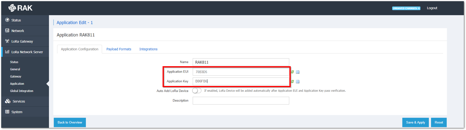

  • Now that your RAK811 LPWAN Node is working in the correct region and mode, you need to fill in the application parameters in your Gateway. This will register the specific device and allow you to exchange data.
  • Navigate through LoRa Network Server -> Application -> Devices. Enter a name for your application and press the "Add" button.

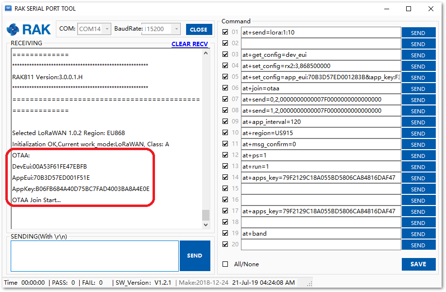

Refer back to the RAK Serial Port Tool shown in Figure 16: RAK811 LPWAN Node Parameters and take note the Application EUI and Application Key. Input those into the corresponding fields in the Application Configuration screen in the Gateway:
📝 NOTE: In case your RAK811 LPWAN Node is still not configured, you can manually input an Application EUI and Application Key here or have it randomly generated by clicking the green button at the right side of the input box. You will have these data configured to the RAK811 LPWAN Node using the RAK Serial Port Tool with the commands below. Make sure to change "XXXX" with your equivalent Application EUI and Key.

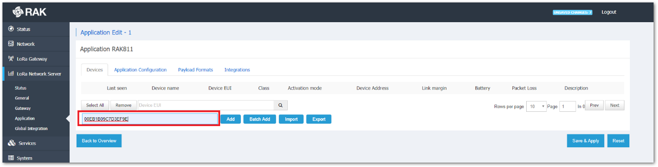

Adding the Device

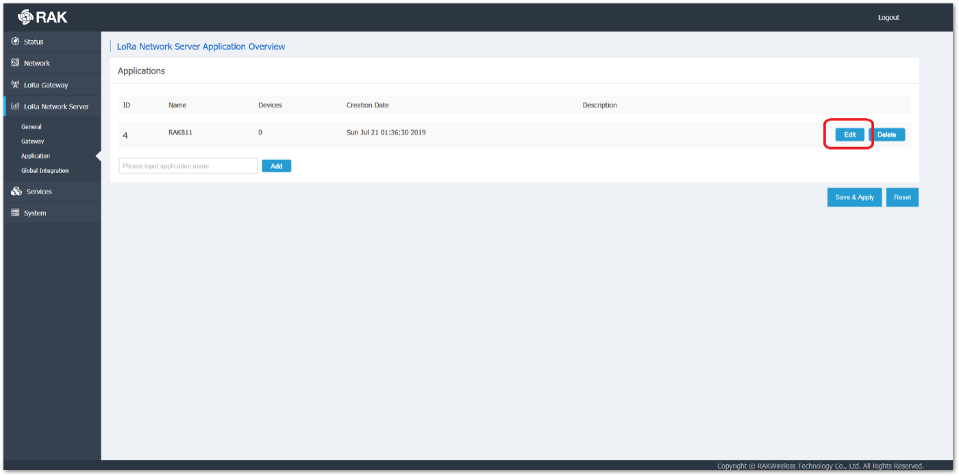

Locate the application created in the previous section and press the "Edit" button.

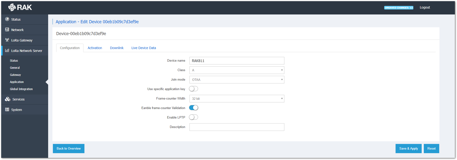

Enter the Device EUI into the corresponding field and press "Add" button.
Enter a Device name, make sure you are in Class A, OTAA mode. Leave the rest of the parameters with their default settings then Save & Apply.

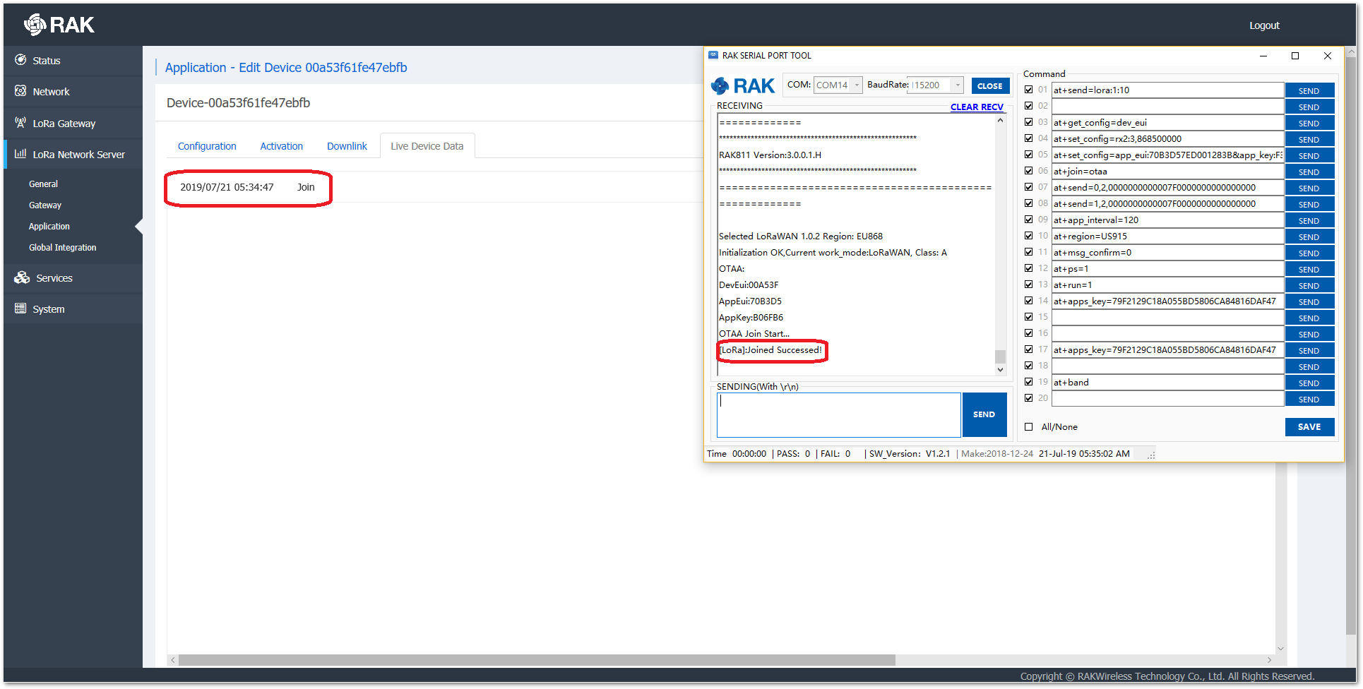

By following the steps in the previous sections, you should now have your Device registered and if you click on the Device EUI, you will open the corresponding Device window. Go to the Live Device Data tab. Here you can monitor data that the application is exchanging in real time.
📝 NOTE: Keep the Live Device Data tab opened as we want to monitor traffic.
Using the RAK Serial Port Tool, execute the AT command provided below to reboot the RAK811. Alternatively, you could press the RESET Button (RST).
at+set_config=device:restart
Upon reboot, your RAK811 should be able to join via OTAA if all the credentials are authenticated. You should see a Join request in the Live Data tab and the Join Succeeded! message in the Serial Tool.

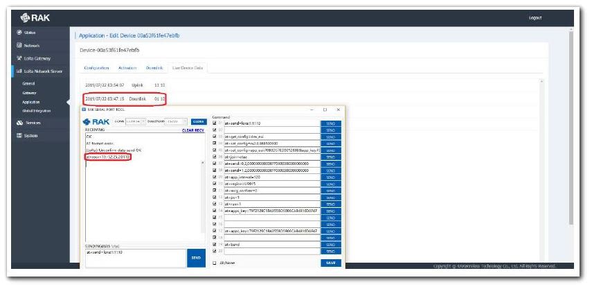

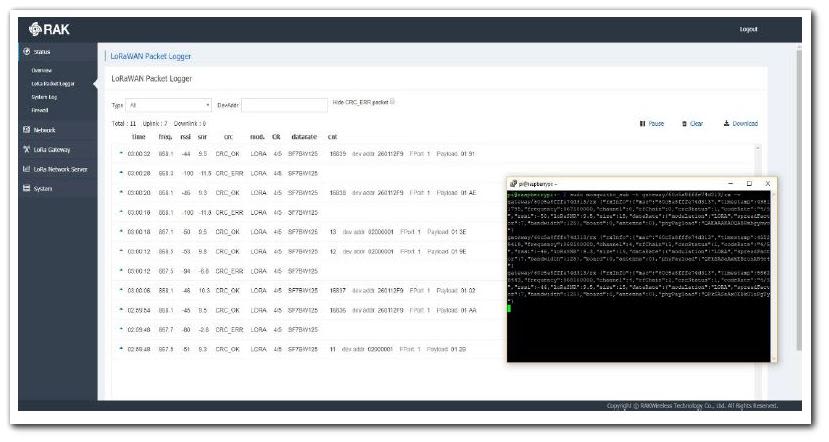

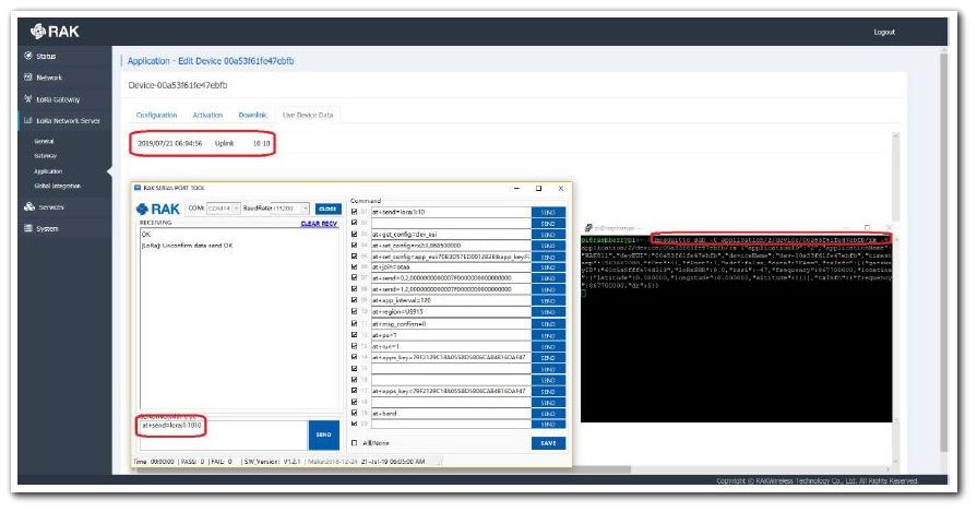

After executing the command, you need to send some data via the RAK Serial Port Tool. Use the command below to send an uplink frame on Frame port 1, with the Payload 1110:
at+send=lora:1:1110
  • Now if you look at the three windows in the image above, in the RAK Serial Port Tool, Live Device Data and the CLI of the Raspberry, you will see that the message arriving is displayed.
  • You can also monitor the Gateway traffic itself. You can do this via the command. Take note of the following syntax in the list below to have the command executed correctly:
📝 NOTE: eui: is the Gateway EUI
mosquitto_sub -t gateway/{{eui}}/rx -v
  • This is very convenient as you have three ways to monitor and you can see the metadata and payload in both the Gateway and via the MQTT Broker.
