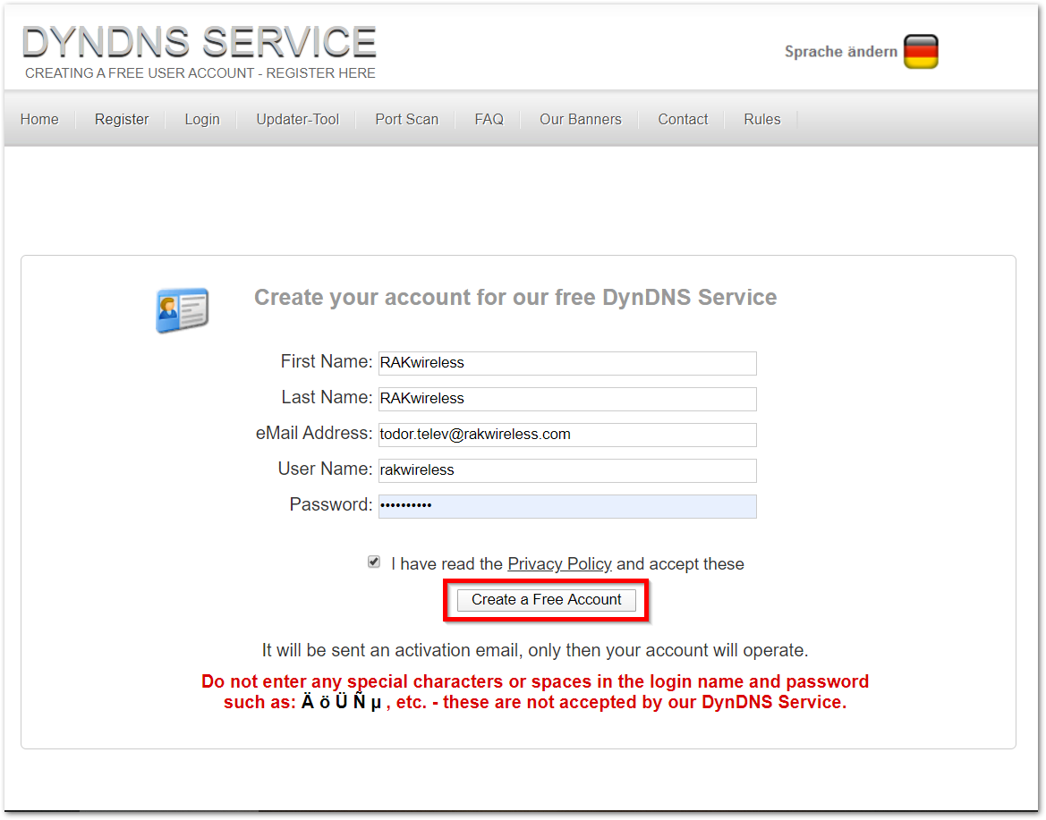

Go to the DYNDNS Service website and click "Register" as shown in Figure 1.
Fill in the following details: Name, E-mail Address, User Name and Password. Agree with the terms and click "Create a Free Account".

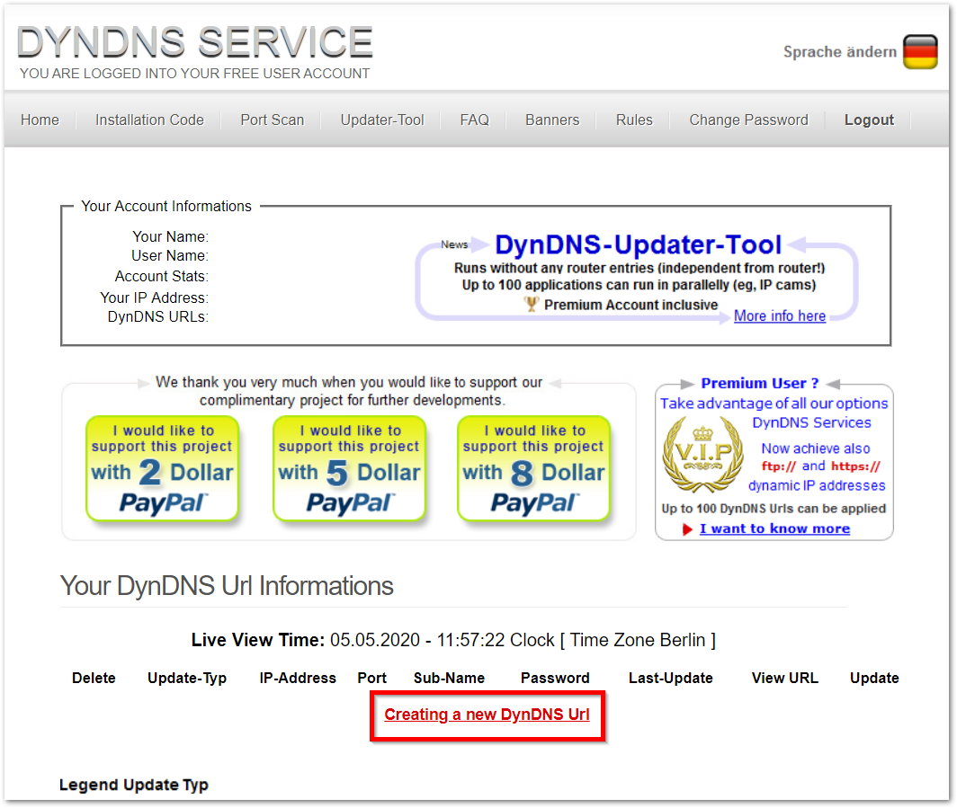

Once logged, click on the "Creating a new DynDNS Url" link shown in Figure 3.

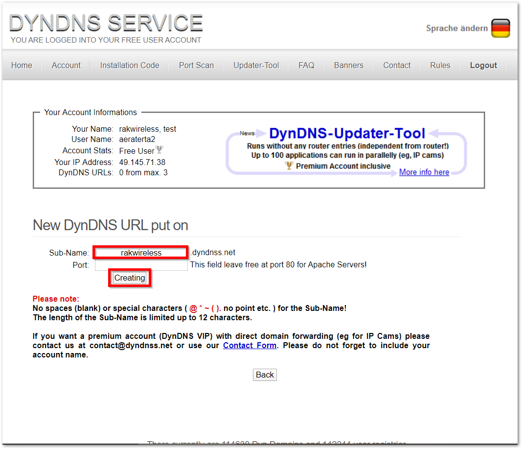

Input a Sub-Name for the domain. This will be used for accessing the Gateway later after configuring the service. Leave the Port field empty.
| 📝 NOTE: For demonstration, "rakwireless.dyndnss.net" shall be used. |

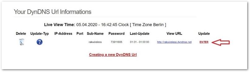

The DDNS URL is created. The Subdomain should now have a password which we will needed to setup the Gateway DDNS Service, full DDNS URL and “ENTER” button that will force the DynDNSS service to get the Gateway current IP.

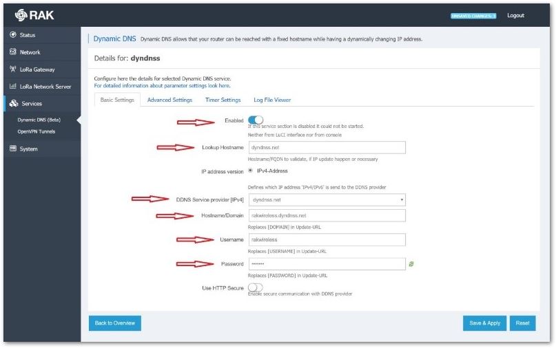

In the Dynamic DNS (Beta) configuration page, Enable the service. Next, fill in the necessary credentials:
- Lookup Hostname: dyndnss.net
- DDNS Service provider: dyndnss.net
- Hostname/Domain: The domain created in the Create a DynDNS URL (see Figure 4)
- Username: DynDNSS Username used.
- Password: DynDNSS Password Create a DynDNS URL (see Figure 5).

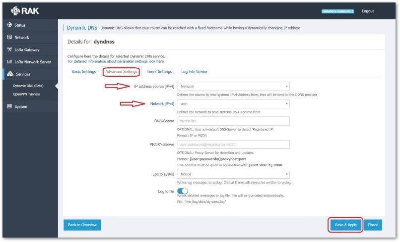

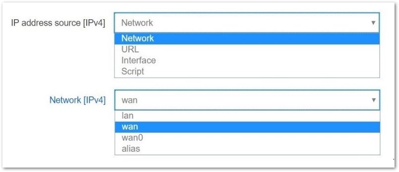

Open the Advanced Settings tab. Next, fill in the necessary credentials and click "Save & Apply".
- IP Address source: Network (default)
- Network: WAN (default)
| 📝 NOTE: This mean that the DDNS Service of the Gateway will check and report to dyndnss.net the WAN IP of the Gateway. If you want to access your Gateway trough different backhaul you can choose it here. |

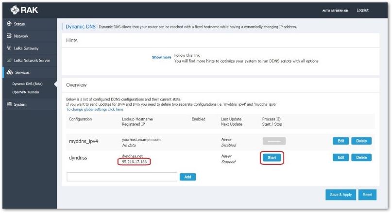

After the configuration is saved, you will be redirected to the main Dynamic DNS page.
To start the Dynamic DNS Service, click the “Start” button.
| 📝 NOTE: This is the page where you can see the dyndnss.net IP, which is the IP address that the Gateway reports any change in the IP address you chose in Figure 4. |

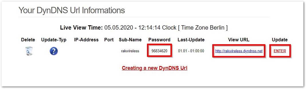

Go back to the dyndnss.net web page and click on the “ENTER” button.
- If the setup is correct, a confirmation message is seen with the real IP Address same as shown in Figure 8.
Click the “To Account” button to turn back to the DynDNS Url Information page. The assigned IP Address is now shown and the last time it was updated.
