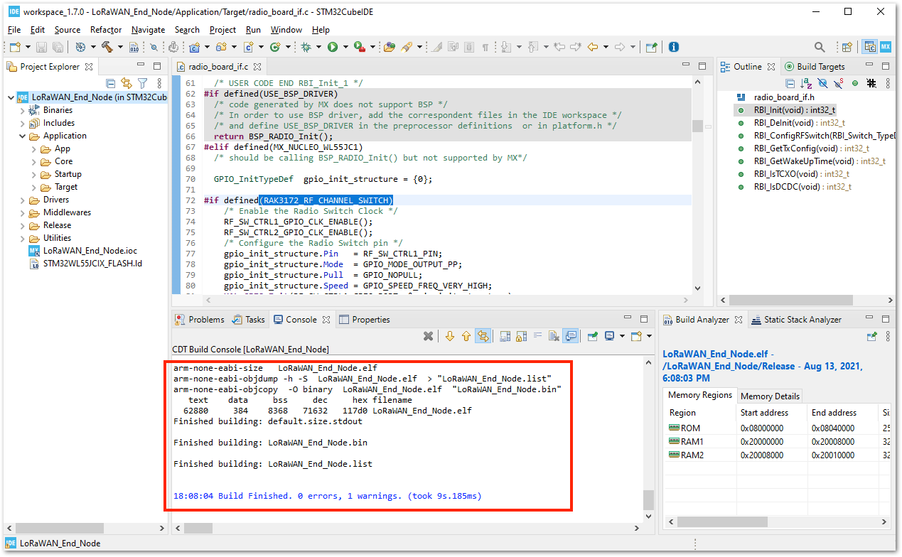

Option 1: Using the STM32CubeIDE
The first option is to use STM32CubeIDE from STM32 Microelectronics. It is free and uses the LoRaWAN middleware created by STMicroelectronics for the STM32WL product family. It is a complete IDE based on Eclipse, which is why embedded developers are not totally new to this IDE. You can debug your code with the ST-LINK tool and gain access to the STM32CubeMX code generation software tool.
Although the STM32WL SDK code is primarily intended for the STM32WL Nucleo board with the STM32WL55 chip in it, we developed a guide that lets you easily port the existing examples to the RAK3172, which has a different STM32WLE5 based chip. The WisDuo documentation contains a porting guide for STM32CubeIDE for RAK3172.

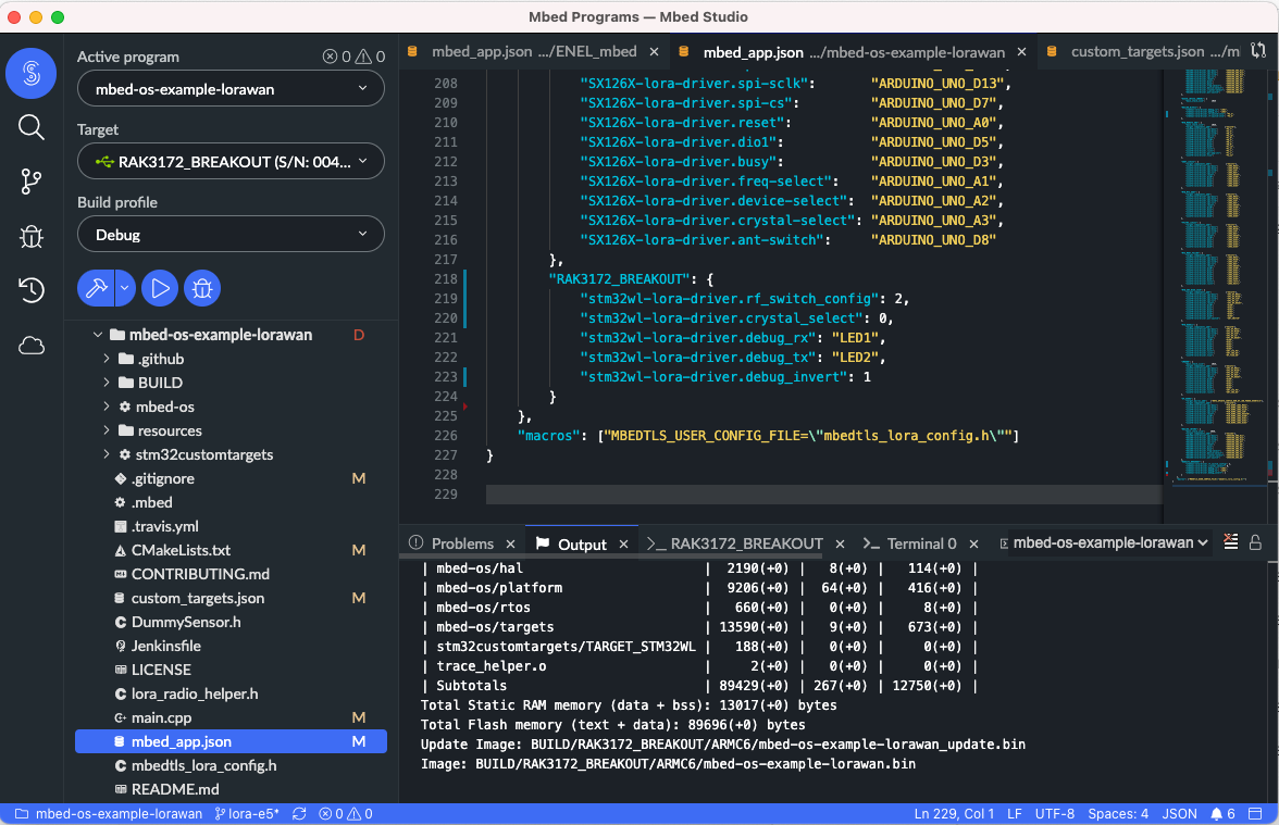

Option 2: Using the Mbed-OS
Mbed-OS is another option for developing custom code for the RAK3172. It is an open-source, user-friendly operating system for the Internet of Things (IoT) developed by ARM.
You can develop your custom code using the Mbed Studio, which is based on Theia IDE. This Mbed-OS approach is a contribution by RAK3172 user Charles from ch2i.eu. He created a quick way to use various STM32 boards, including the RAK3172, with the Mbed-OS via his stm32customtargets, which works smoothly on Mbed Studio. You can find the complete details for this firmware customization approach, as well as the development board he designed for RAK3172, in his GitHub repository.
