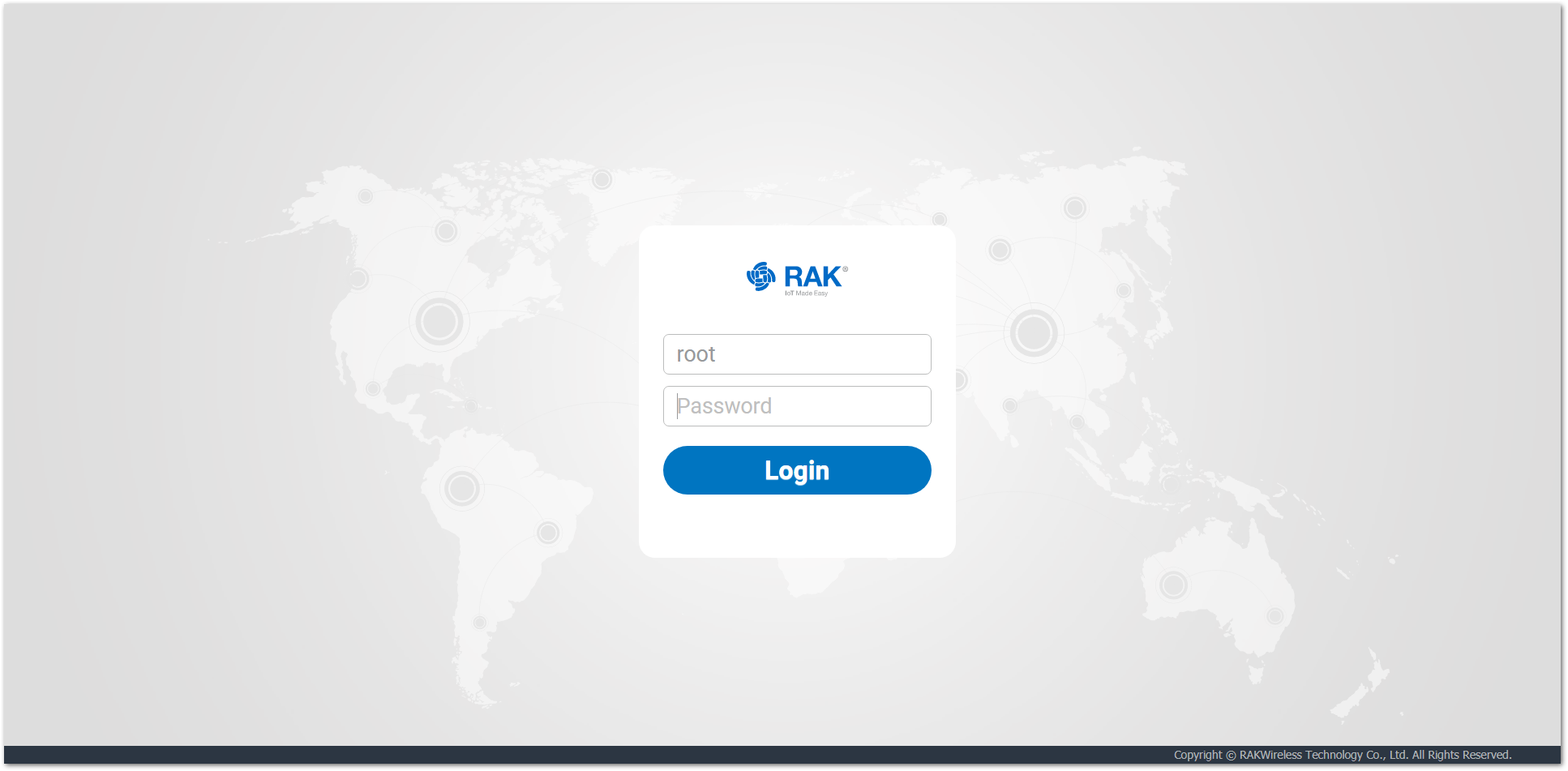

Wi-Fi AP Mode
By default, the gateway will work in Wi-Fi AP Mode, which means that you can find an SSID named RAK72XX_YYYY on your PC's Wi-Fi Network List. XX is the code of your chosen WisGate Edge Gateway and YYYY is the last two bytes of the gateway's MAC address.
📝 NOTE: No password is required to connect via Wi-Fi.
Using your preferred Web browser, log in with the credentials provided below:
  • Browser Address: 192.168.230.1
  • Username: root
  • Password: root

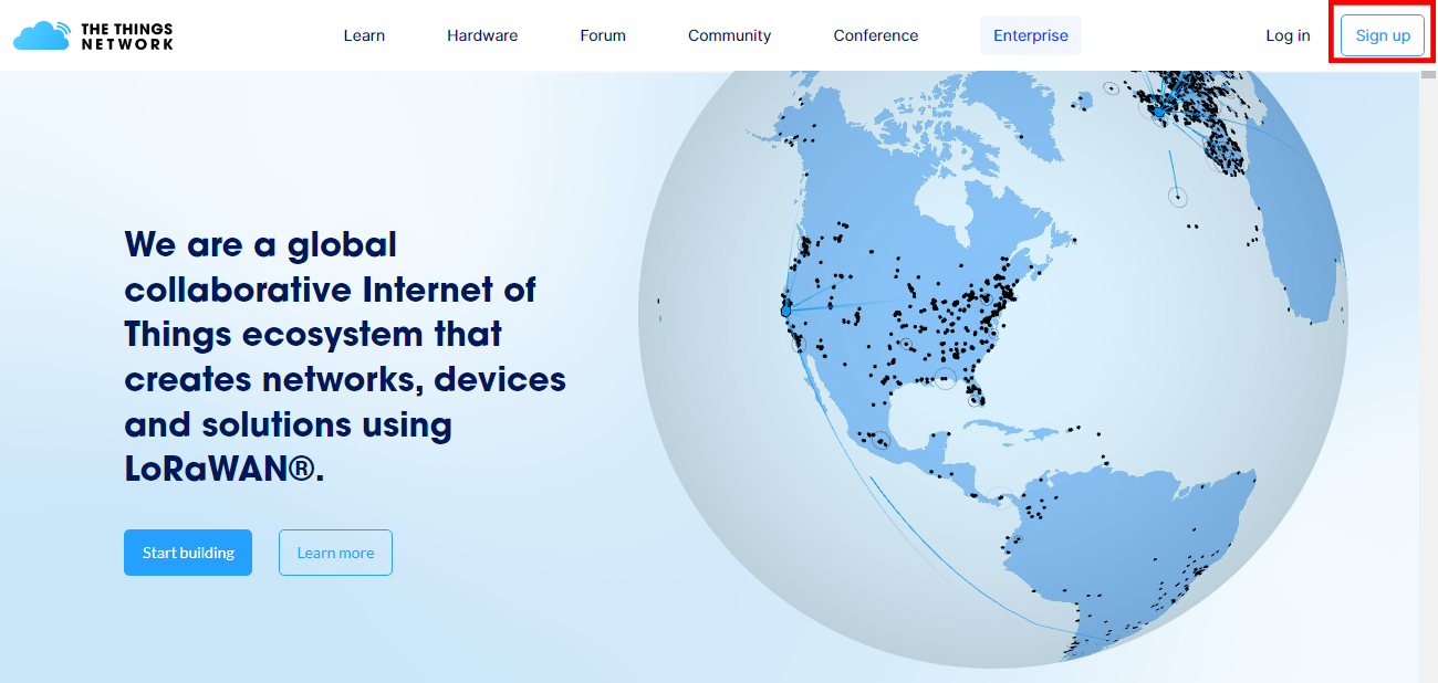

If you don’t have a TTN account, create an account first. Click the Sign up button, then log in.

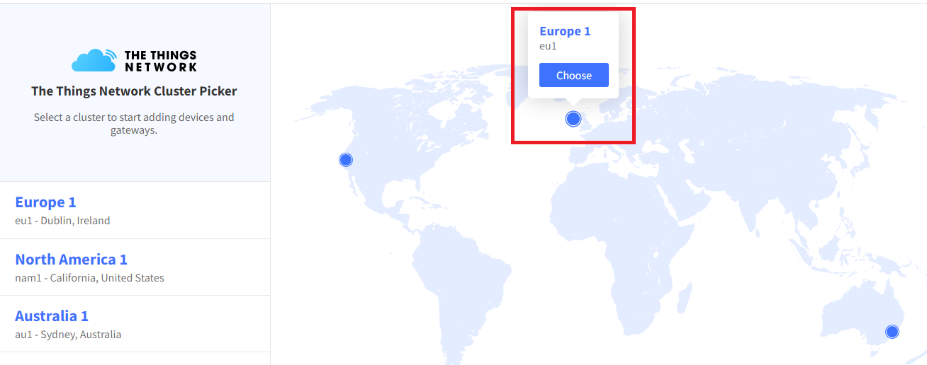

Make sure first you are in the right TTN cluster. Use your The Things ID credentials to log in. In this example, choose Europe 1.

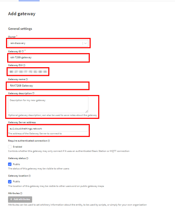

After you have logged in, you need to register your commercial gateway to TTNv3. To register, choose Go to gateways. If you have already registered your gateways before, head on to Gateways > + Add gateway.
Fill in the needed information:
  • Owner – Automatically filled by The Things Stack, based on your account or created Organization.
  • Gateway ID – This will be the unique ID of your gateway in the Network. ID must contain only lowercase letters, numbers, and dashes (-).
  • Gateway EUI - A 64 bit extended unique identifier for your gateway. This is where the gateway you get on the above section Configuring the RAK7268 WisGate Edge Lite 2.
  • Gateway name – A name for your gateway.
  • Gateway description (optional) - Optional gateway description; can also be used to save notes about the gateway.
  • Gateway Server address - The address of the gateway server to connect to.
  • Frequency plan - The frequency plan used by the gateway.

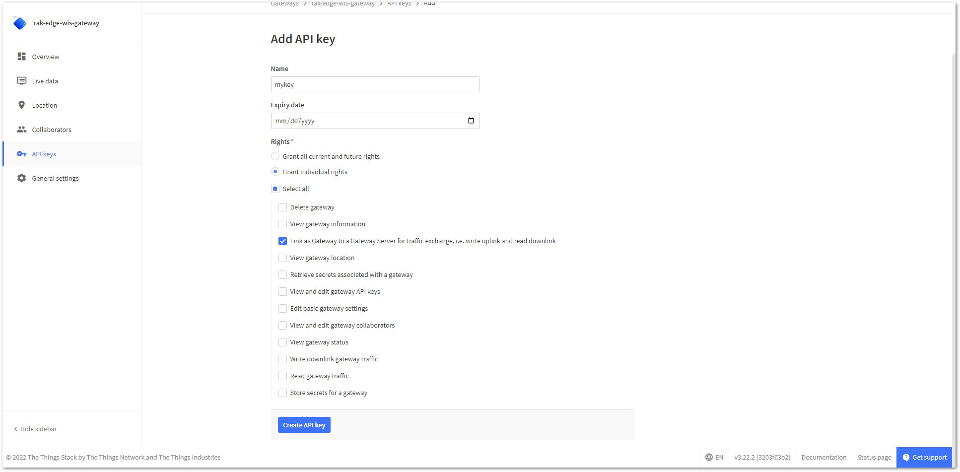

TTNv3 supports TLS server authentication and Client token, which requires a trust file and a key file to configure the gateway and successfully connect it to the network. Generating the token for the gateway is the next step in this guide. To generate a key file, from the Overview page of the registered gateway, navigate to API keys.

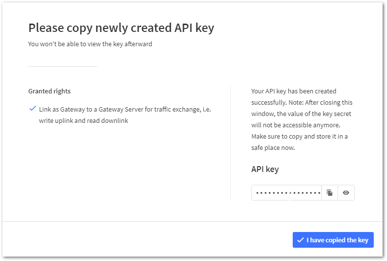

On the API keys page, choose + Add API key.
In the Name field, type the name of your key (for example - mykey). Choose Grant individual rights and select Link as Gateway to a Gateway for traffic exchange, i.e. read uplink and write downlink.
To generate the key, choose the Create API key. The following window will pop up, telling you to copy the key you just generated.
⚠️ WARNING: Copy the key and save it in a .txt file (or other), because you won’t be able to view or copy your key after that.
Click I have copied the key to proceed.

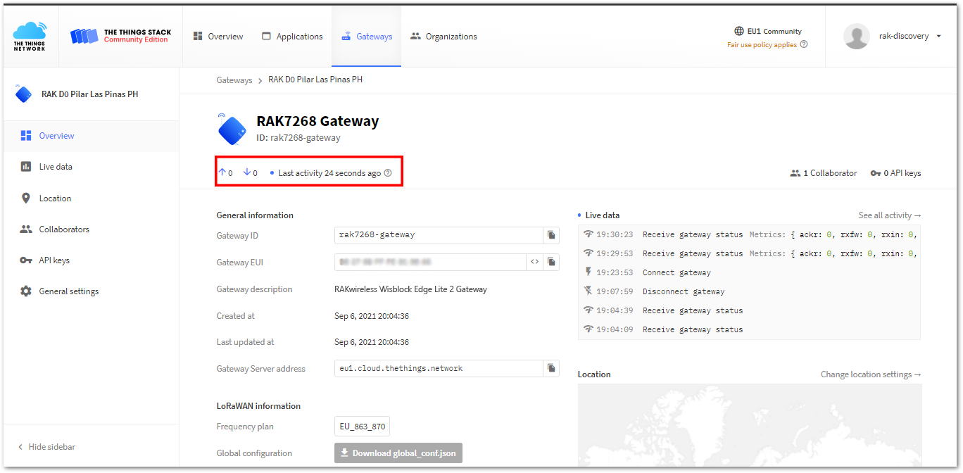

Configure the gateway to connect it successfully to the TTN V3 Server. To configure the gateway, access it via the Web UI. To learn how to do that, check out the RAK7268 Quick Start Guide.
Navigate to LoRa Network > Network Settings > Mode drop-down menu, then choose Basics Station.
Select Switch mode to apply the change. After that, the Basics Station Configuration pane settings will show up. To connect the gateway to TTNv3, the following parameters must be configured:
  • Server – For server, choose LNS Server.
  • URI – This is the link to The Things Stack server. Note that, for this tutorial, you are connecting the gateway to the European cluster. For Europe, fill in the following: wss://eu1.cloud.thethings.network.
  • Port – The LNS Server uses port 8887. Type in 8887.
  • Authentication Mode – Choose TLS server authentication and Client token. When selected, the trust and the token field will show up.
  • trust – For trust, you will use the Let’s Encrypt ISRG ROOT X1 Trust certificate. Download the certificate first.
  • token - This is the generated API key. The key must start with Authorization:. Example:
Authorization: YOUR_API_KEY
📝 NOTE: Replace YOUR_API_KEY with the key generated previously. Have in mind that there should be a “space” between Authorization: and YOUR_API_KEY, as shown in Figure 17.
To save the changes, click Save & Apply.
You can now see that your gateway is connected to TTNv3 as Basics Station:

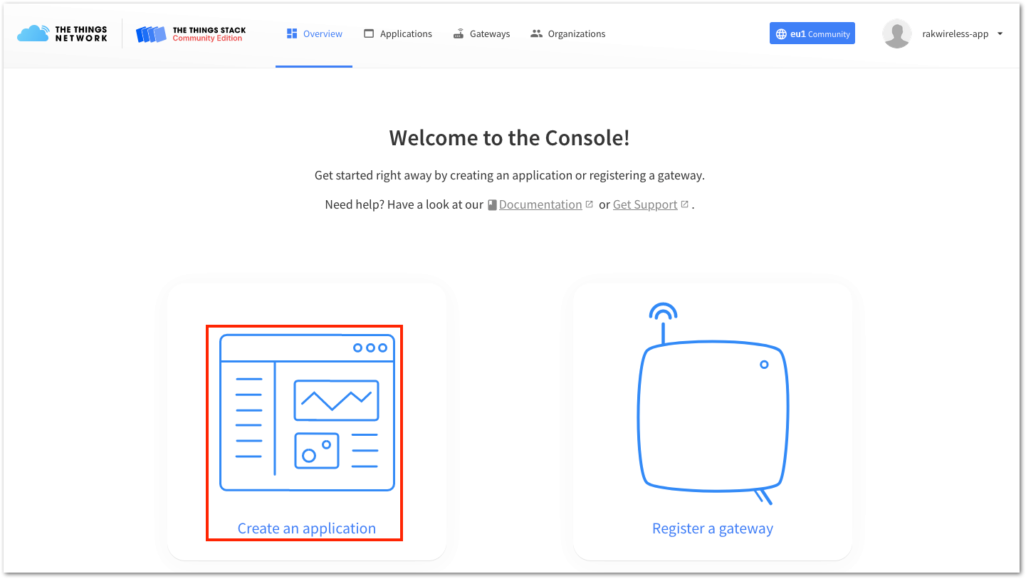

Now that you are logged in to the platform, the next step is to create an application. In your console, click Create an application.
To have an application registered, input first the specific details and necessary information about your application, then click Create application.
If you had no error during the previous step, you should now be on the application console page. The next step is to add end-devices to your TTN application.

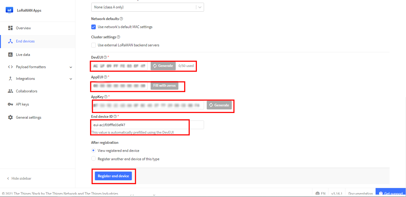

LoRaWAN specification enforces that each end-device has to be personalized and activated. There are two options for registering devices depending on the activation mode you select. Activation can be done either via Over-The-Air-Activation (OTAA) or Activation-By-Personalization (ABP). Click + Add end device, as shown in Figure 21.
To register the module, click Manually first.
Choose the following configurations in adding the end devices.

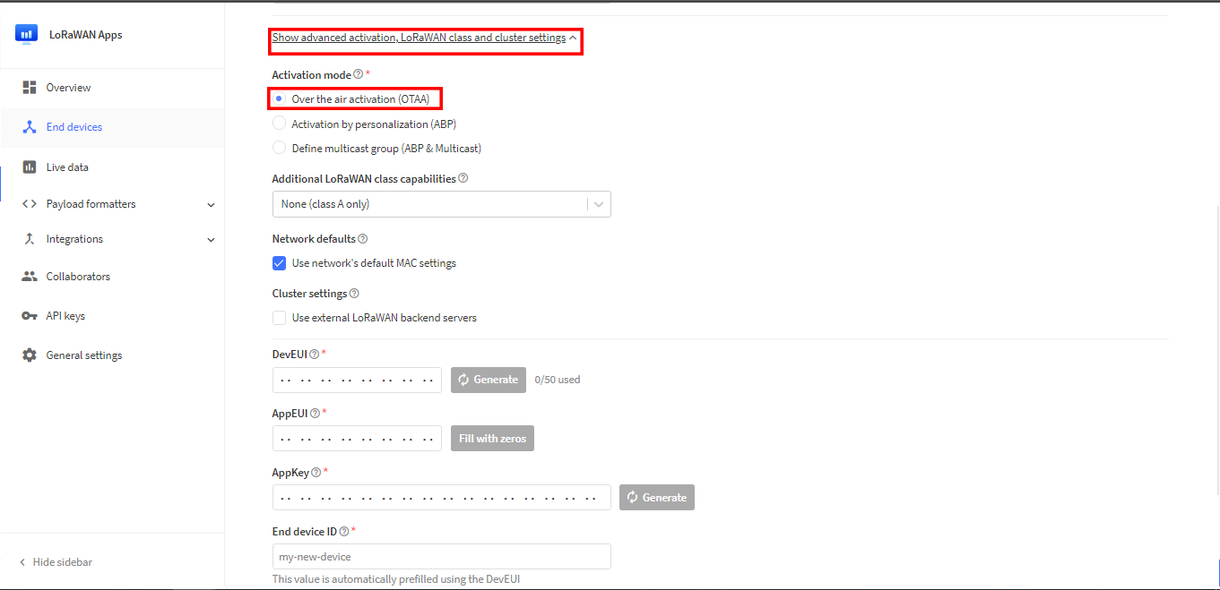

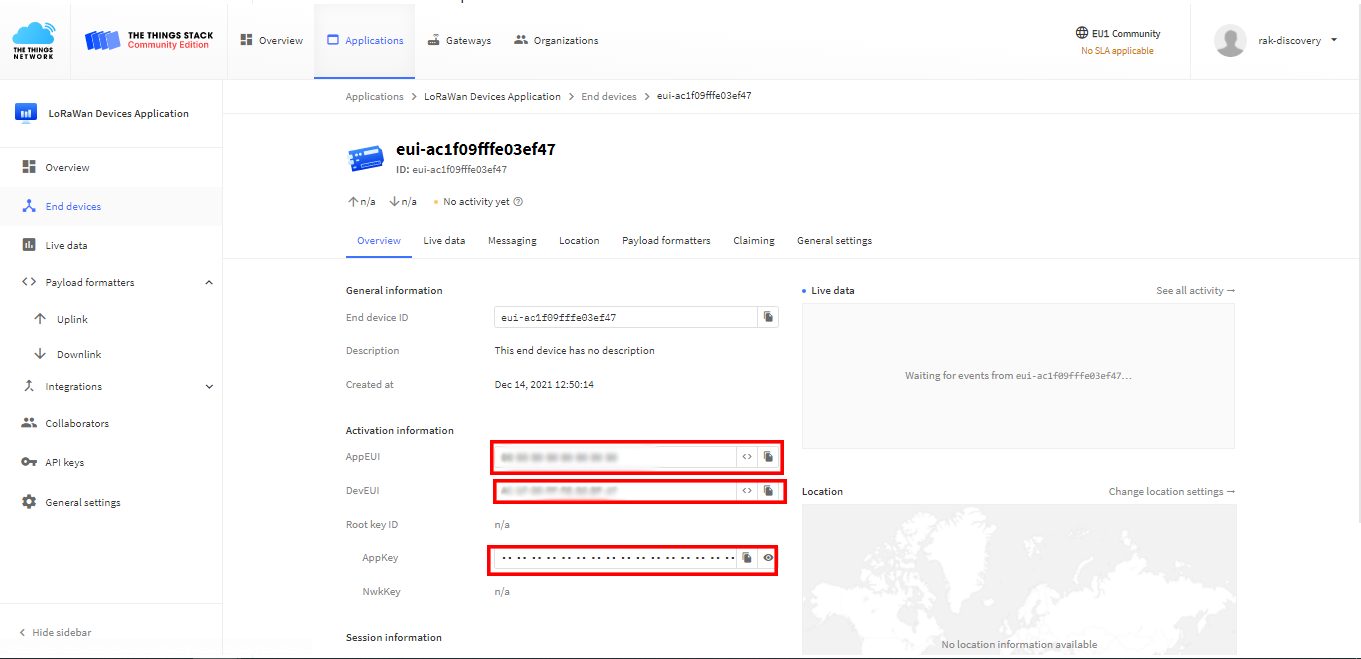

Click Show advanced activation, LoRaWAN class, and cluster settings, then select Over the air action (OTAA).
Then input a unique End device ID and EUIs (DevEUI and AppEUI), as shown in Figure 25. Check if the sticker on the RAK4631 module has a DevEUI or a QR code that you can scan, then use this as the device unique DevEUI. For AppEUI, use 00 00 00 00 00 00 00 01 instead of Fill with Zeros button (there are LoRa modules that do not support all zero APPEUI). For the AppKey, you can click the Generate button. Finally, click Register End Device.
You should now be able to see the device on the TTN console after you fully register your device, as shown in Figure 26. Take note of these keys, such as the AppEUI, DevEUI, and the AppKey, as they are needed in the next part of this guide.

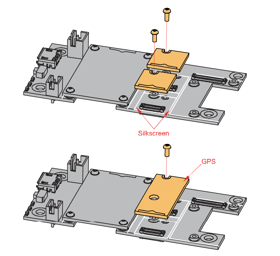

Assembling

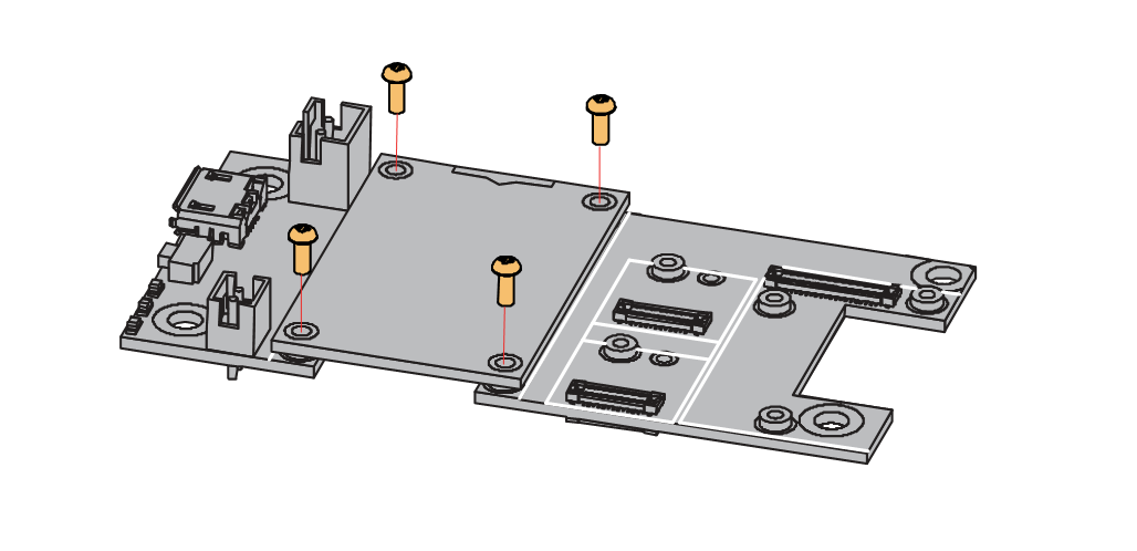

As shown in Figure 28, the location for Slots A, B, C, and D are properly marked by silkscreen. Slots C and D are located on the bottom of WisBlock Base. Follow carefully the procedure defined in RAK5005-O module assembly/disassembly instructions to attach a WisBlock module. Once attached, carefully fix the module with an M1.2 x 3 mm screw.
Disassembling

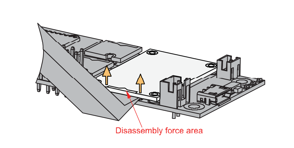

The procedure for disassembling any type of WisBlock module is the same.
First, remove the screws.
Once the screws are removed, check the silkscreen of the module to find the correct location where force can be applied.
Apply force to the module at the position of the connector, as shown in Figure 31, to detach the module from the baseboard.
📝 NOTE: If you will connect other modules to the remaining WisBlock Base slots, check on the WisBlock Pin Mapper tool for possible conflicts. RAK1906 uses I2C communication lines, and it can cause possible conflict, especially on some IO modules.

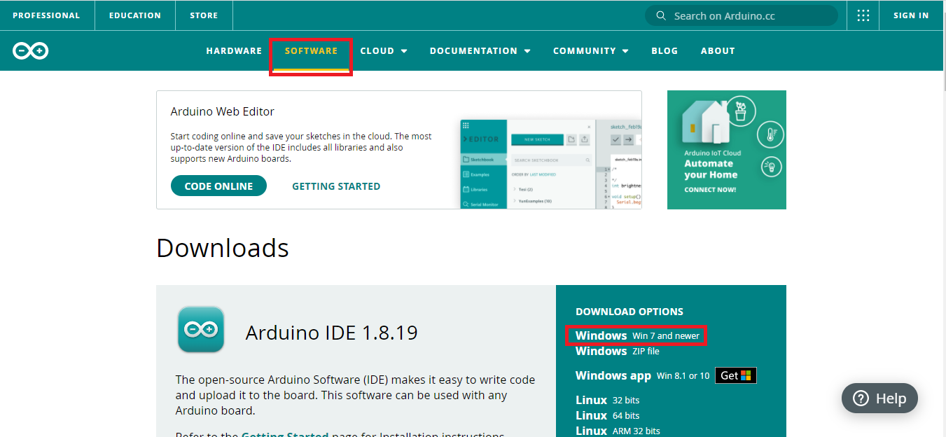

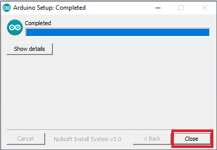

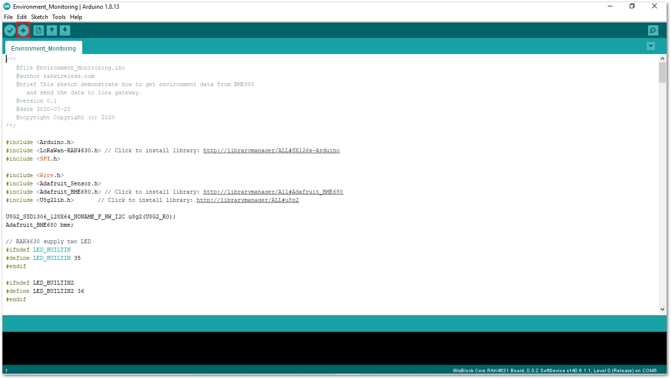

Download the Arduino IDE, then install it on your PC or laptop.
⚠️ WARNING: If you are using Windows 10. Do NOT install the Arduino IDE from the Microsoft App Store. Install the original Arduino IDE from the Arduino official website! The Arduino app from the Microsoft App Store has problems using third-party Board Support Packages.

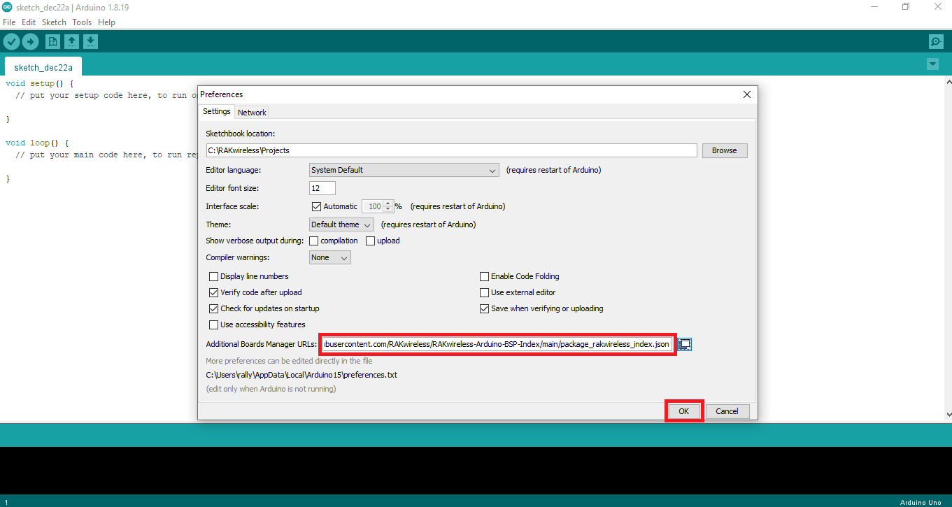

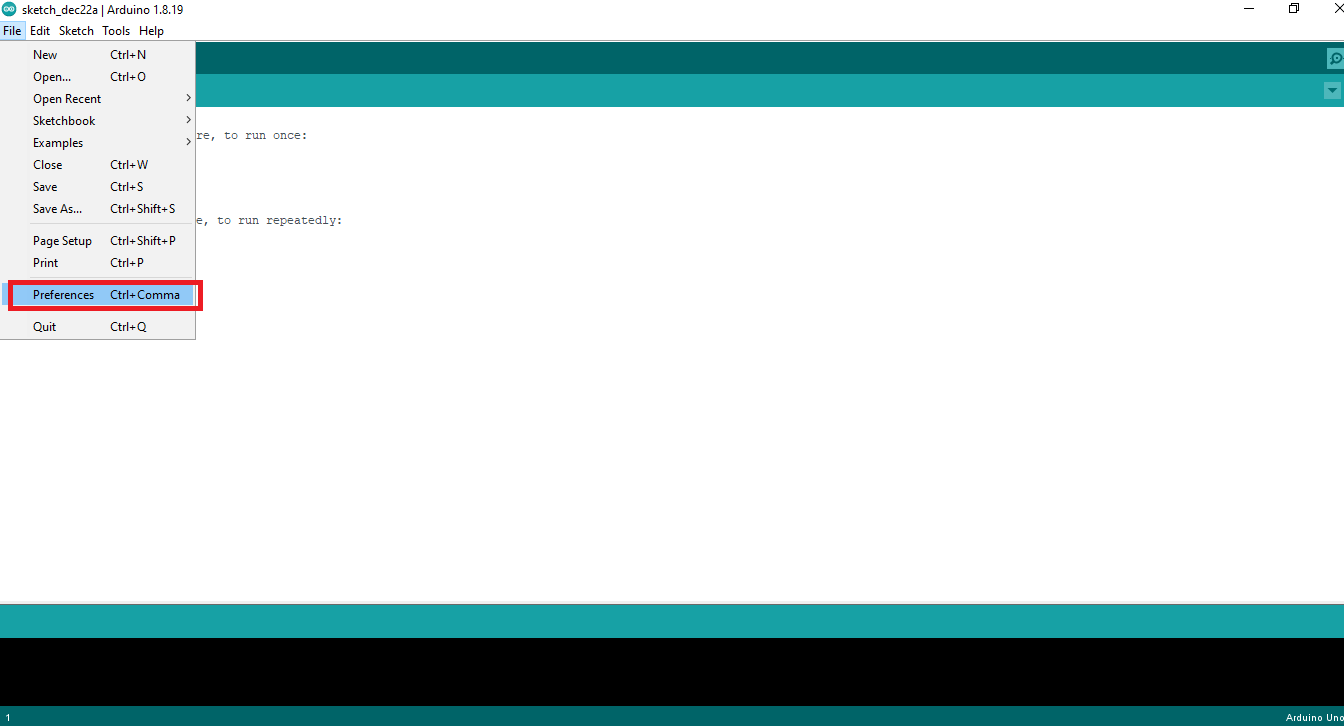

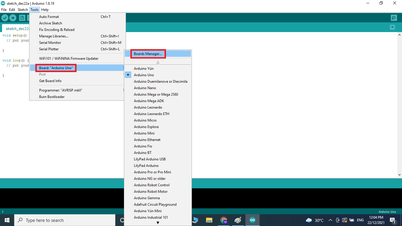

Open the Arduino IDE, then install the RAKwireless BSP support for the Arduino Board Manager.
Click on File > Preferences. In the Preferences window, look for Additional Boards Manager URLs, then click the icon on the right side.
Copy https://raw.githubusercontent.com/RAKwireless/RAKwireless-Arduino-BSP-Index/main/package_rakwireless_index.json, paste it into the new window, then click OK > OK.
Go to Tools > Board: "Arduino Uno" > Boards Manager. Type RAK in the search bar and the RAKwireless Core modules will be shown in the window.
Choose RAKwireless nRF Boards, then Install. After installing the core nRF core module, click Close.
After the installation of the RAKwireless nRF Board core module, you can get the program by navigating on the example code, as shown in Figure 46. Open it on the Arduino IDE, and save it as Environment_Monitoring.ino.
Once the example code is open, install the Adafruit BME680 library, SX126x Arduino library, and the U8g2lib Library, by clicking the links highlighted in red. You will be directed to Arduino Library Manager for each link you will be clicking.
During the installation, you will be asked to install the Adafruit Unified Sensor library. Install it, as well.

Uploading the Arduino Code
After a successful installation of the library and configuration of the LoRaWan Network Server setup, you can now select the right serial port and upload the code, as shown in Figure 49 and Figure 50.
When you have successfully uploaded the example sketch, open the serial monitor of the Arduino IDE to see the sensor's reading logs. If you see the logs, as shown below, then your RAK1906 is properly communicating to the WisBlock core.

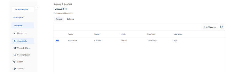

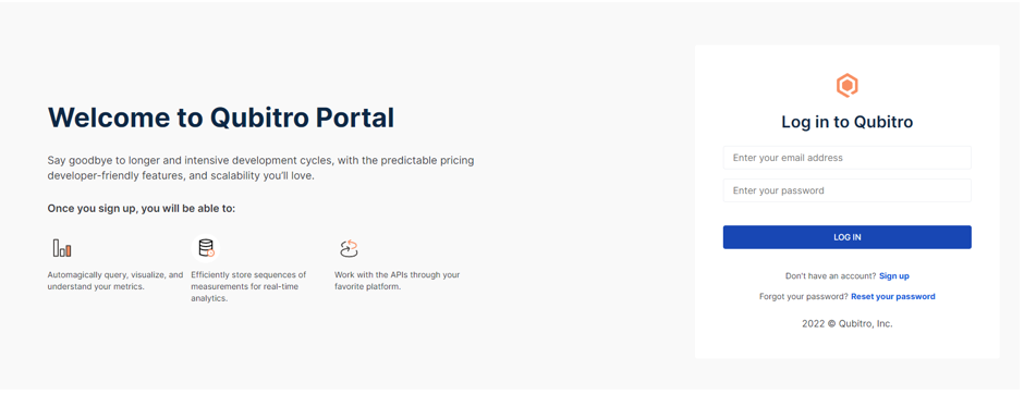

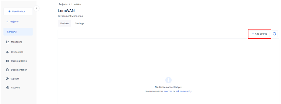

Go to Qubitro Portal and create your account.

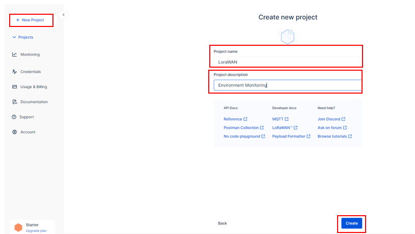

Login into your Qubitro account. Click New Project, then fill out your desired Project Name as well as the Project Description, then click Create.

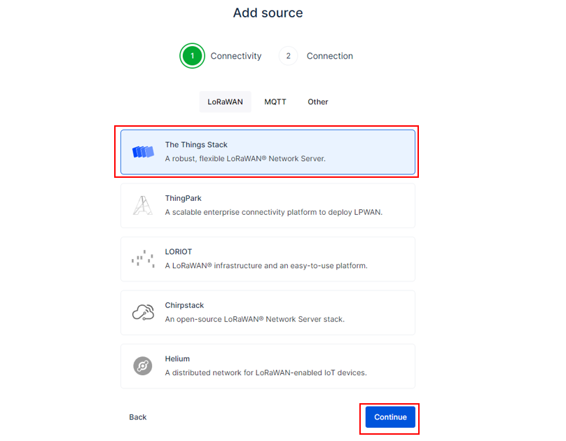

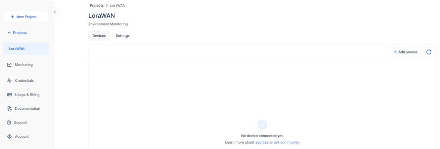

Then click Add source.

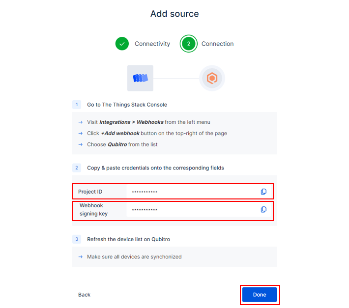

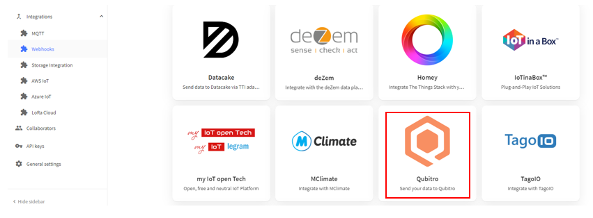

Choose The Things Stack, then click Continue.
For the Connection, copy and paste the Project ID and Webhook signing key to notepad. These credentials will be used in the later part, then click Done.

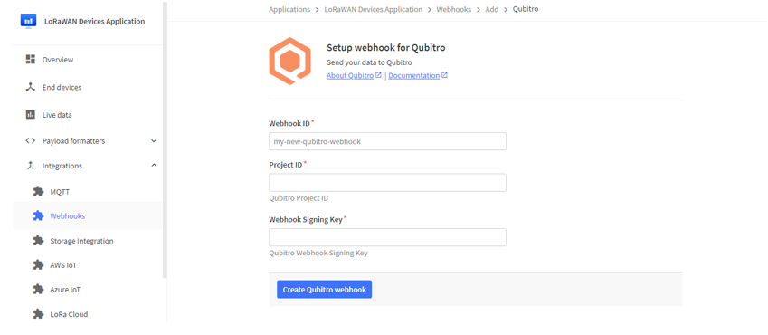

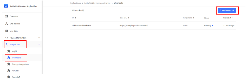

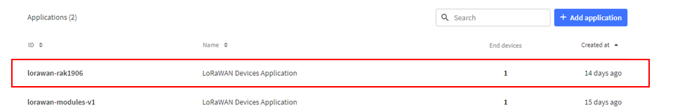

Head on to the TTN Application console to add the Webhook to it.
Click your device then go to Integrations > Webhooks > Add webhook.

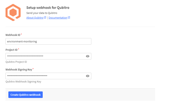

Choose Qubitro as your webhook template.
Fill in the needed details:
  • Webhook ID – For this example, you may use environment-monitoring.
  • Project ID – Paste the credential you copied from Step 5.
  • Webhook signing key – Paste the credential you copied from Step 5.

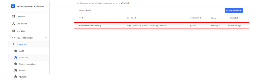

Then click Create Qubitro webhook.

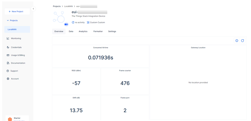

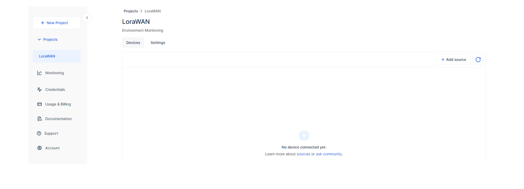

After creating your webhook, go back to your Qubitro platform to check the changes made.
Refresh the Qubitro platform and the newly-added device is now included in the platform.

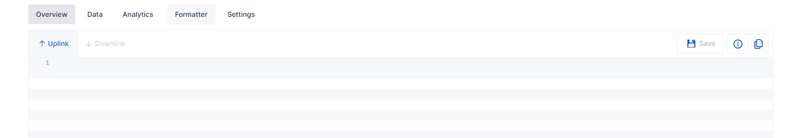

Click Formatter to include the decoder for Temperature and Humidity as an example of showing these measurements on the platform.
Copy the decoder code below and paste it inside the Formatter > Uplink, then click Save.
function decodeUplink(input) {
  return {
    data: {
      temperature : (input.bytes[1] << 8 | (input.bytes[2])) / 100,
      humidity : (input.bytes[3] << 8 | (input.bytes[4])) / 100
    warnings: [],
    errors: []

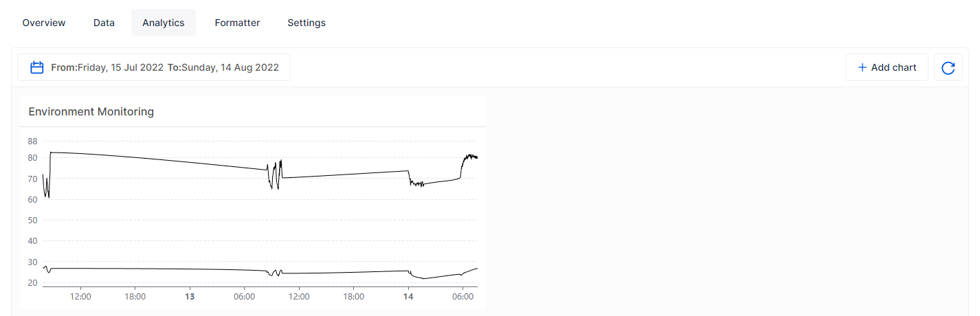

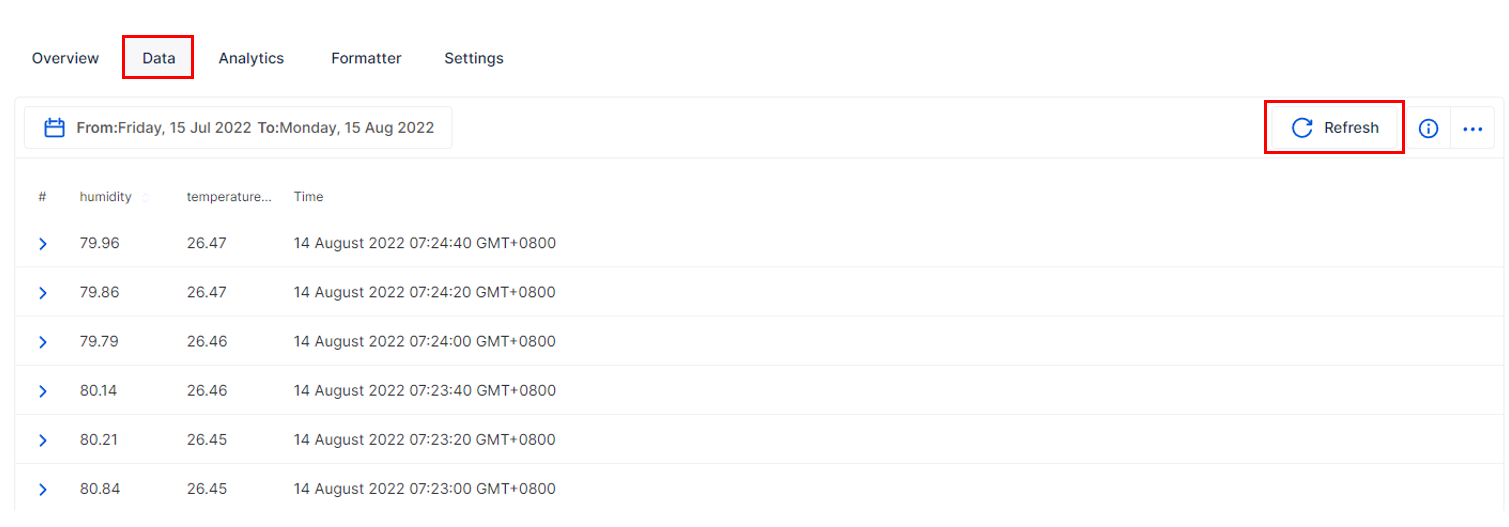

Click the Data tab. It should show the latest data by clicking the Refresh button.

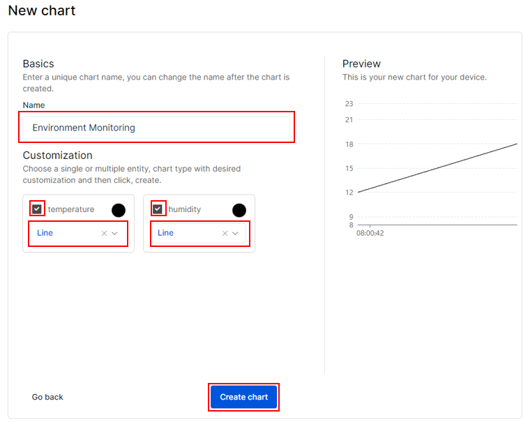

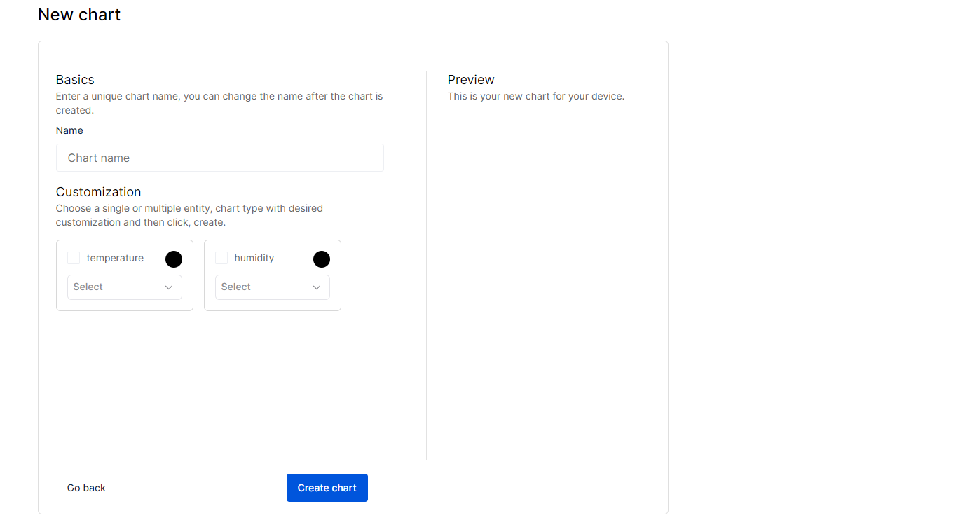

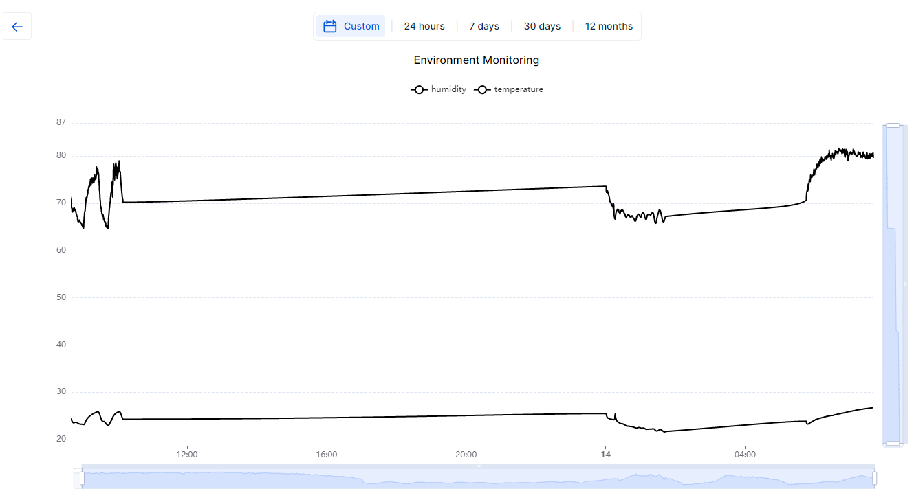

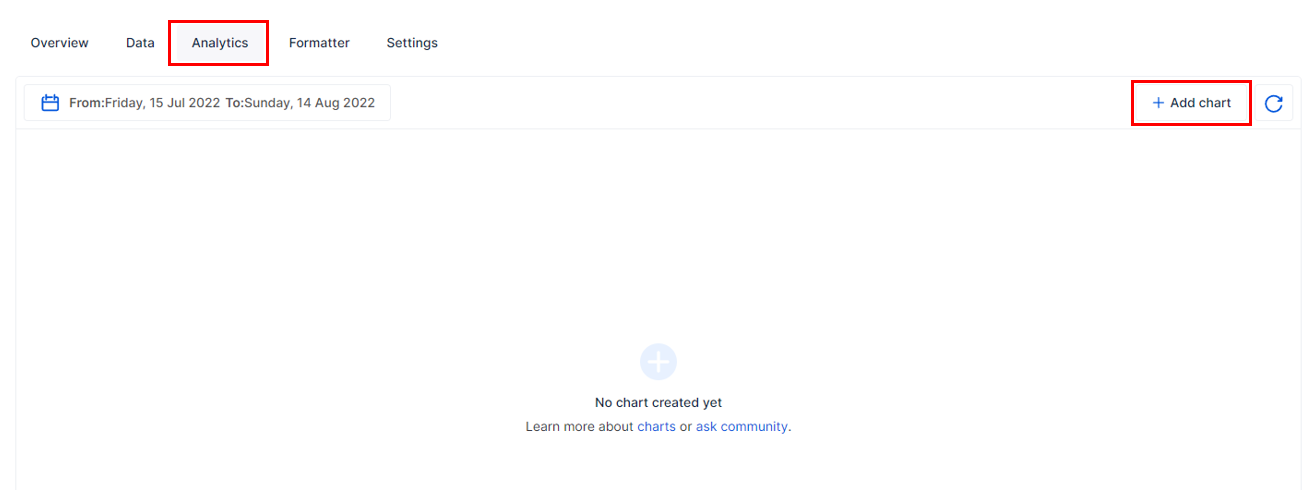

Once done, click Analytics, then click + Add chart to add the graph for Temperature and Humidity.
Once done, tick both temperature and humidity, and choose Line under them. You may use Environment Monitoring as your Chart name, then click Create chart.
Then there you have it, the Environment Monitoring graph for Temperature and Humidity.
